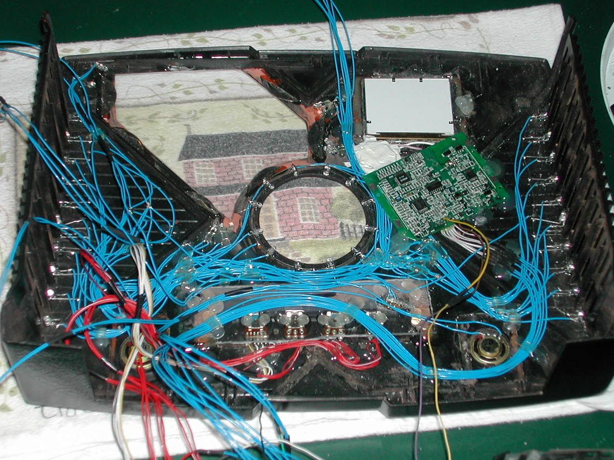

Post by: tryintomod on September 03, 2005, 02:10:00 PM
Well it is solderless, but the lpc ports are filled with solder so that would really work and it's a pain in the ass to take my box apart. Here is a pic of it.
Front top view
Inside of top
There are about that many more wires underneath the trays in the xbox.  There is somewhere between 250 and 300 ft or wire in the xbox all together.
Title: New To This, For Tsop Flash I Have To Solder
Post by: lordvader129 on September 03, 2005, 02:15:00 PM
well solder itn eh LPC isnt a problem, yo umight have the hold the chip down while you boot, but since you really only need to boot once its not a big deal
but yeah, i wouldnt want to take thet beast apart either
id suggest just getting a memory card
http://www.ebgames.c...duct/224945.asp
