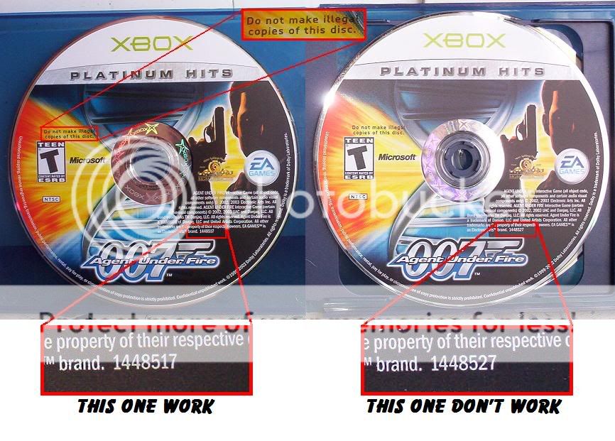

as for 007, there are actually 3 versions fo the game, original (non platinum), platinum 1, and platinum 2
the original version and platinum 1 work, platinum 2 (newer copies) has been patched so it wont load the hacked save

is there any way to tell which 007 platinum with out opening up the package?

i belive those same serial numbers are on the outside of the package, not sure where exactly, but i think the first shipment of the patched (non working) discs had the non-patched serials on the case, so the external ID isnt 100%

i have a 007 platinum version with the nunbers 1448521 on it. is there any way for that you can tell me if this will work? thanks

is that on the outside case or on the disc? outside case im assuming, it should work, i think the patched one is 1448531 on the outside

they all have numbers, but the patched version has a different number i think, im not sure since i have a non-plat edition

my (non plat) copy has 1448511 on the outside and 1448507 on the disc
Title: Question About Tsop Flashing
Post by: manxbox44 on January 02, 2005, 11:56:00 PM
ok guys thanks for the info
Post by: lordvader129 on January 12, 2005, 04:16:00 PM
007 - all non plat and some plat (scroll up to see version numbers)
MA - older non-plat (i believe only versions without the game of the year badge work) no plat work
SC - all versions AFAIK (newer plats might not)
