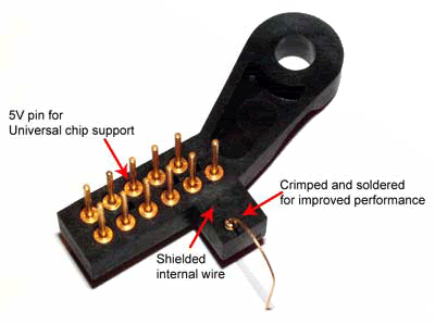

is there a solderless adapter that will work with the DuoX 2 - Cromwell/Flashbios Edition?
EDIT:would this work IPB Image

There is no solderless solution for the DuoX 2 unless you get a lite or GS and leave BT unconnected. The chip would be always on but may not be reliable  due to the floating state of the BT signal.
the adapter would work with some modification maybe and some soldering.

That particular adapter will work fine, but.. You need to solder d0 to pin 4.
And.. if you have an older duox2 (non-gs or lite), you need to solder BT to pin 9 as well (either way, chip will be 'always on' unless you solder BT to a proper BT point).
