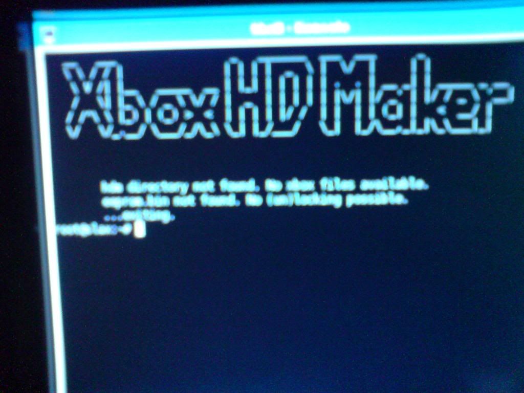

please also ensure you are reading the build instructions to the letter as i have never seen this error before.
Well, I'm trying this in a old computer with only 256mb ram and two USB ports, both ports are low speed (But I think it doesn't matter cause I boot damn small linux usb live with that same usb and the same low speed port)
I downloaded the light version formated my 2 gb usb with Fat32, did everything in the tutorial, BUT I didn't put my linux iso I was just testing the app, so yeah everything OK, I put my eprom, C and E folder and then I maked bootable the usb with bootinst.bat
The computer start and then after a short time the usb start with the green splash menu, but stopped at vmlinuz, then I changed the usb to another port (the first port) and now stays at initgr or something like that.
I'm gonna try this again and see what happens.

Post by: jairolas on October 28, 2009, 12:04:00 AM
Ops I can't edit, well I tried again and yes... it was my fault lol
I was doing something worng and now everything loads fine BUT I still have a big problem, when I press 1 in the option 2 to enter hdmaker it says : Could not allocate physical  memory and that's it, maybe I need more ram or something.

Ok, this just isn't working for me. I tried the console version, but it gives me a "runtime 4" error, no KDE, etc
So I tried the GUI version. This tells me "hdm directory not found", "eeprom.bin not found", etc. I tried replacing the ltoolz.lzm file with an older one, but then it starts asking me about a linux.iso file. I thought the point of filling the "C" and "E" folders in hdm was that no iso file was needed?! I know the USB drive is mounted as mnt/sda, but how do I know what my xbox drive is?
Is it just me? I used xboxhdm 1.9 without problems on my old PC. Is the ltoolz.lzm file in the final version the correct file?
I'd really appreciate any help, this is driving me mad!!

so i can understand your problem a little better:
1. whats your system specs? you got enough RAM to run the gui version?
2. you have definitely followed the install guide to the letter (populated the HDM folders with appropriate M$ files etc?)
3. eeprom.bin is in the root of the stick in the folder eeprom.
no ISO needed for 2.1 final (all done by populating the folders).
I suspect your stick is not 'built' properly and your files are either missing or not in the right place. have another go & feedback.
IIRC (although its been a while) fwz scripts automatically 'find' your HDD for you. see  this post which may help 'getting you started'.

Title: XboxHDM 2.2 (USB Edition)
Post by: skydra on February 11, 2010, 06:42:00 PM
I built my flash drive fine but and got this to boot fine also. The problem I have is after I open the terminal and run xboxhd2. I get to the select drive option but my mounted drive is on sda1. And it does not let me manually type in the location. So how would i change mount location or how would i fix it to allow a manual location to be typed in.
Thanks guys!
Post by: skydra on February 12, 2010, 07:01:00 AM
I wonder if i can get around this problem by using the lite version.  Oh i can not use 1.9 because it is a sata hard drive(1tb) and from what I have read this is the best way to go about formatting it since it is a virgin drive and my xbox is soft modded not chipped.
I have a laptop but i have access to some desktops at work so I will try messing with it more later today and post my results. If anyone has any suggestions they would help alot.

Post by: ldotsfan on February 12, 2010, 08:18:00 AM
QUOTE(skydra @ Feb 12 2010, 09:42 AM) View Post
Are you referring to the select drive option for the various possible IDE connections that the xbox hdd is attached to? It has nothing to do with the location of your mounted usb drive.  dry.gif Or am I missing something here?

Post by: skydra on February 12, 2010, 08:55:00 AM
Yes and No
Yes I am referring to when xboxhd2 asks where your hard drive is located that needs to be formatted and than asks you to select a number 1-5. ex. hda1
Now where my usb drive is mounted does not matter, I understand that. But my hard drive i wish to format is mounted on sda1, and this is not an option(referring to the 1-5 options in the selection). I have tried to change where the hard drive is mounted by using the terminal and mount commands but that does not seem to be working and i can not put in a manual location.
Thanks for the quick reply idotsfan.

Post by: ldotsfan on February 12, 2010, 09:10:00 AM
QUOTE(skydra @ Feb 12 2010, 11:55 PM) View Post
Type dmesg at the terminal and paste the output in pastebins and post the link here. Is the xbox hdd detected correctly? I'm not sure if locking will work through a sd? interface.

Post by: skydra on February 12, 2010, 12:03:00 PM
http://pastebin.com/m5e8431e8
I tried it on a different computer at work to see if the motherboard may have had something to do with where the hard drive was assigned. And it did the same thing.
Post by: skydra on February 12, 2010, 12:47:00 PM
So what I am thinking from my research online is that it is being labeled as sda1 because it is a sata hard drive. Now i could use the older version which is 2.0 alpha and i could enter the destination accordingly but than there is the problem of not knowing if it will lock. I will not be able to try this until sometime sunday night. But since the xbox does not read sata drives i have purchased a sata to ide adapter and what I am thinking is that by hooking the hard drive up to this adapter than through ide on a mobo that when I boot 2.1 off my flash that it will register the hard drive as hda1 since it is connecting through ide. Unless it can still identify it as sata through the device details.  So thoughts on this?
Post by: ldotsfan on February 13, 2010, 06:30:00 PM
QUOTE(skydra @ Feb 13 2010, 03:47 AM) View Post
Yes, you are right. Sata devices are seen as scsi devices through libata in linux. I wasn't aware of that previously. Nevertheless your suggestions are valid and you could try them. I have just one more idea to add - you could try forcing IDE legacy mode in your motherboard bios.
Please report back on your results so that others know what to do.

Post by: CimSlunt on April 04, 2010, 03:27:00 PM
Hey again, after typing xboxhd2 and pressin yes etc, when it brings up the list of activatin xboxhdm or lovking the drive, i press 1 to activate yes i want to use primary master, then i get.
Warning: No DNS servers found
qemu: could not open disk image /dev/hde
Any idea whats wrong?
Post by: ldotsfan on April 05, 2010, 07:22:00 AM
QUOTE(CimSlunt @ Apr 5 2010, 05:27 AM) View Post
How is xbox hdd connected to the PC?
By the way there are many ways to skin the cat, for example this method , variant of that method  even this method if you prefer a Windows only solution.

Post by: stainy on October 08, 2010, 03:01:00 AM
Hi guys..
Just read this thread from front to back..
Here`s where I am atm..
I have the original HHD in my xbox, runs xbmc.. fine.. wanted to put a bigger drive in there.. Got a 80GB samsung... used xboxhd ( booting from cd ) to install all the files etc onto my new drive...  When I goto lock it it says frozen.
Now.. my question ( I guess )
Will xboxhd2.2 help me get round this problem ? all I need to do is lock the drive ( I think )
Also... will I need to use an xbox partitioner to resize my partitions? or has the original xboxhd done all that?
Thanks in advance guys!

Post by: scullc on October 08, 2010, 10:56:00 AM
QUOTE(stainy @ Oct 8 2010, 10:01 AM) View Post
frozen drive? try ldotsfan's recent suggestion here
80gb HDD to re-partition? seriously doubt that will be necessary. xboxhd should have set up all off 'F' for you. obcd's comments here will explain more when needing to use xbox partitioner (>256gb)
hope that helps/works

Post by: stainy on October 08, 2010, 02:57:00 PM
QUOTE(scullc @ Oct 8 2010, 05:56 PM) View Post
Ok I did the method idotsfan suggested and I was able to lock the drive!
Popped it into my xbox and it boots to the MS dash... not my xbmc!
I made the linux disk with the contents of my old xbox hdd ( with xbmc on it ) not sure why it doesn`t find xbmc!
I forget now.. how do I access the new 80gb drive again to add xbmc to it?

Post by: Heimdall on October 08, 2010, 05:52:00 PM
When you made the linux disc either you took a copy of the shadow C instead of the real C, or you didn't take a copy of the E partition. If the LED is still green then it's the shadow C problem, if the LED is yellow then it's the E partition.
If it's the shadow C problem then you need to either start again with the contents of the real C partition and the E partition, or redo the softmod on the new disk.
If the LED is yellow then just cold boot with a rescue/boot disc (Frosty's or Slayers) and FTP the contents of your original E partition to the new disk.

Post by: stainy on October 09, 2010, 11:50:00 AM
ok thanks to the guys on here.. I`m back up and running with the bigger drive and confluence skinned xbmc smile.gif
One problem I have now,.. is when I go into PROGRAMS it`s a blank screen... I can here the noises if I move up or down.. I press B and I go back to the main screen..
Pictures/Video etc they are all fine... just programs...

Post by: Heimdall on October 09, 2010, 11:59:00 AM
Sounds like your XBMC installation is incomplete, or you have some files left over from an old XBMC installation. Get hold of the latest version, and use FTP to delete the current copy and replace it entirely with the new version.
Post by: Heimdall on October 09, 2010, 02:05:00 PM
Yes, just boot with any boot disc and use the FTP server.

I was using the 2.2 version and I keep running into a bug. If this was mentioned already than I did miss it.
this bug showed up on both 2.1 and 2.2. I had a virgin 500 gig WD hdd. The xboxhd program worked fine and it formatted the drive (used my existing xbox eeprom). The issue I was having is that whenever it got to the step to copy files off the usb, it gave me an error message saying it could find any files on the -c or -e and to reinsert the cd. I found this odd since i am using the usb version. It then ask you to hit enter, so I did and it gave the same error again. At this point though the xboxhd app at the end of the message listed this
"possible bug?"
Has anyone encountered this before or know how to get around it? In my case I ended up going to the Xbrowser and the files it said it could not find where obviously there and I just did some copy/pasting, but it would save tons of time if this USB version copied the files over itself. Any ideas on what might have caused the odd bug?
I have never seen any of those errors during my testing time with xboxhdm2.1/2.2
You sure the USB is built correctly?
I have seen that error saying 'it could not find any files on the -c or -e and to reinsert the cd' before with failed writes to CD using xboxhd - not xboxhdm. We moved away from the iso version a long while ago.
Read above post on Xbrowser (limited testing)/Ndure 3.1

thanks for the reply. The 2.2 version, I used all of the files you had listed on the first page of this post and I got that error. Originally I found directions for the 2.1 usb on another site, then someone mentioned the huge update with 2.2 and gave the link back here. I started from fresh
On my old pc I had no problems with the 1.9 cd version (used to plug in my drive after auto detect). Since i am on a new pc with only one ide slot, I had the hard drive on that (plugging it in after auto detect ) and used the 2.2 usb. Again with the files and directions you provided but I still got the odd "reinsert cd error-- possible bug". The lock/unlock has never been a problem and with the 2.2 build it did see the eeprom in the folder but seems to have an issue with trying to see the files in the C or E folders. Again using the Xbrowser part of this setup the files were there and I did at least get the dash and such on the new drive so all was not lost. I wanted to report the error here that I received or as a way around it should anyone else encounter the same problem that I did
if i recall i ran into an error of similar wording when trying to run the old NDURE script till i found out that there was a new script made just for this USB edition. but i never ran into this problem when simply using the stock options of rebuilding the hdd. i wonder if you had the c and e folder in the HDM directory populated with the files or did you put them somewhere else?
there was actually a point when i had the C and E folder in the HDM folder populated with stock files from slayers disk, then i had an NDURE directory with its own C and E folders that were populated with moded dash and files and such, and even when i was not trying to run NDURE and only use the stock HDM option of rebuilding the hdd it seemed to only want to find the C and E folders located inside the NDURE folder.

I should have mentioned this earlier. My old xbox was with the sids softmod exploit. However my new xbox is the Trusty modified board. That setup was tsop flashed (no mod chip present). I was also told to keep the HDD unlocked on it. The Hdd I bought at bestbuy and that is the drive used for the 2.2 usb.  The program DID format it properly and it would unlock and lock the drive if needed (used eeprom from my soft mod xbox just in case). So in my setup for the 2.2 I had no ndure folder as it was not needed. Yes you are correct I had the C and E folders in the HDM directory with the retail dash files from the slayers evox disc and I was getting that error. I was able to verify I had it setup right since browsing to those directories with theXbrowser found me the files I needed to at least get a dash on it. Again no idea why it had the hang up but at least the program gives an alternate way to get things done

Post by: roabe on December 24, 2011, 01:14:00 PM
When I try to run xboxhd2 in Konsole, I don't get prompted to enter my mount point, just this message:
hdm directory not found. No xbox files available.
eeprom.bin not found. No (un)locking possible.
and it returns to the shell prompt. I tried reformatting the USB drive, re-downloading Xboxhdm2 and repopulating it with files from the Xbox, but I always end up with the same result.
Although I noticed the Mount Point for my flash drive is different from what the tutorial says it should be. The tutorial says it should be /mnt/sdb1, but on my filesystem I just have /mnt/sdb (sdb1 does not exist). Is there a way I can get xboxhd2 to search in the correct folder?
EDIT: Nevermind. Figured out a solution. I created a directory called sdb1 in the /mnt/ folder, and created a mount point in the terminal by typing
mount /dev/sdb /mnt/sdb1
, and was able to get xboxhd2 to start.
