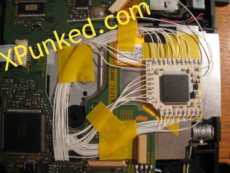

It's not as good as yours Spankit but I think it's not bad.
How do you get the wires to stay so neat without taping them?
(IMG:http://i67.photobucket.com/albums/h296/a1133973/D2Ckeyinstall.jpg)
