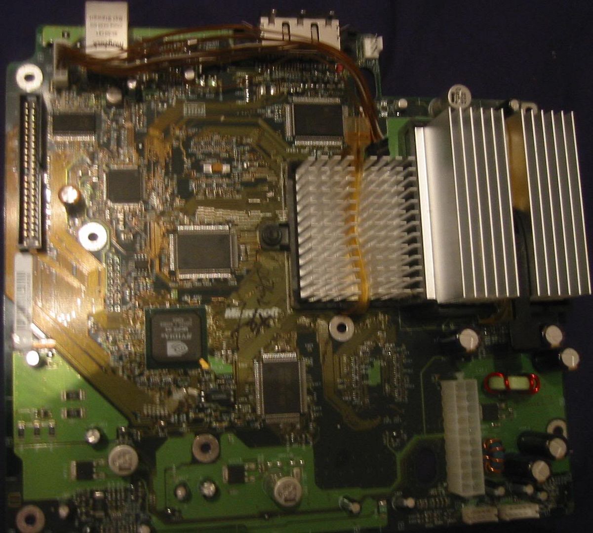

Well, I took pictures of my 1.6 board.
Top and Bottom.
I apologise for my shitty photography skills.
See there are 2 ram chips on top, and 2 directly underneath on the bottom.

crap, i just recieved the board i bought off of ebay, it's got 4 chips on it the "416" the person sold for a $1 not bad, but he saidit won't power up, he's tried different power supplys on it. oh well, now i have to go home and take my xbox apart, then realize i'm a dumb-ass, the last board i had had two open spots on the top, and when i was talking to my friend we were both understanding that there were two open spots on the bottom, and we didn't bother taking the board off the case (too lazy to look for the torque driver). oh well as soon as i get home from work i'll look, and most likely be in the market for what i'm sure the chips are called "434" sorry, for the confusion, but i hope when i look at my board it'll have open spots on the bottom, but now looking at this one, i'm seriously doubting it, and thanks for the pics. not bad, mine would prolly come out the same, if not worse. but hey that's why i come here to ask, i only want to learn, i didn't mean to argue.

okay, check this out, i just got home from work, took my xbox apart, looked in and there were the two memory chips, they are not the same as the ones on the other board, well they are but aren't, the "416's" on the board i got from ebay, i assumed were "4-16MB" so then i looked at mine and saw that they were "428" i was "???" so i continued to take the screws out, removed the board and saw that there were two more chips on the bottom dry.gif  so the "416" and "428" have nothing to do with the size, i've just established that, and the serial #'s are the same, so that was a reassurance.
