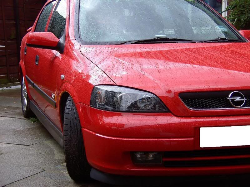

Ok well i got me a new car, Vauxhall Astra SRI which is the MK4 (G) overall i'm really happy so far, ive talked about it in another thread here, so some of you may already be aware ive got it.
All in all i got a great deal on the car, shame it took the majority of my cash, i need more money for more mods  tongue.gif
As you can see in the pics, the fogs on the front are full of condensation, i need to dry them out, this apparently happened in the floods we had in the UK last year, so simple enough to sort those out, just need to find abit of time to do them, maybe this weekend. smile.gif
Other than that, shes a solid car.

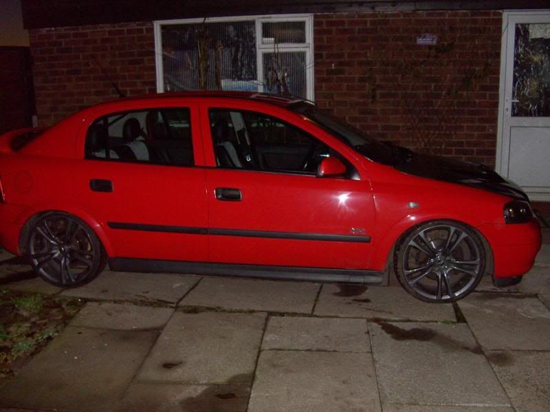

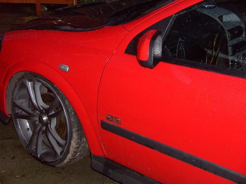

Ive already began the modding process by starting out with some FK coil overs, i don't know how much exactlly shes been dropped, but they can do 70mm all round, ive not done on the bank end yet, i just set it up like that as i had a somewhat heavy load to move, so will be dropping the back end alot more soon.
I can get abit lower on the front end, but then it starts scrapping pretty bad on full lock, so ive left it at this hight, still shes slammed, and if your not careful on speed humps, you'd rip the bottom off the car lol.
Anyway heres some pics:
And a few pics for people especially like grim_d to show shes slammed (please excuse the center cap not been on in the pic)
Well thats all ive got for now, more pics will follow as and when i get more stuff etc.
Ive got some stuff on order, a new bigger better spoiler as this one is cracking on where it goes from the up-rights along the spoiler flats if you get what i mean. Gona have to order some paint and get the spray gun out for it though, probably will do this in the near future.
Also ive got some angel headlights on order for it, hopefully they won't take too long.

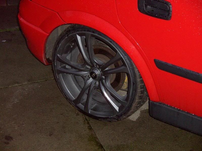

Future plans are also to get some 18" alloys i know are available, the over-all wheel diamiter with tyre shouldn't be much different to what i have now, as the side wall is much thinner, so i'll get alot more wheel with less side wall, they are also abit wider too.
And hopefully i'm gona strip the engine down within the next few months, do a basic rebuild and check up, and i'm considering some performance cams and chipping the ecu to raise the limiter to 7k, i'd use some ARP bolts on the conrods though just to be safe. This is all only a temp matter though, as in a year or something time, i'm after fitting a Z20LET or simillar (2.0 turbo) and doing some major tuning on that in time to come.

Post by: grim_d on March 19, 2008, 08:53:00 AM
nice mate that is low, nice to see it in red too, instead of the common as muck silver.
do you get any scrubbing at the height its at the now? prob have to be carefull no to hit any bumps when turning, though the offset on those allows is pretty deep so i guess youl be ok.
looks solid and in good nick, only thing i would say is looks like it needs a good polish? but that might just be the lighting.

Post by: Dano2k0 on March 19, 2008, 09:04:00 AM
Cheers mate, nice to hear you like it, i'm dead happy with it at the moment.
By scrubbing do you mean as in the arches with the tyre catching? if so none at the moment, the back end needs winding down a good bit more yet, i can get it a good bit lower on the back end yet i reckon. I had it lower on the front end, but on full lock it was catching then, so had to raise it a few mm to clear better.
The front spliter can catch though if your not too carefull, and i'd guess you could probably rip it off if you got reckless  laugh.gif
Yeah i too love the red, i think once its polished up, in summer it'll look smart. I'm considering a carbon fibre bonnet too, i reckon against the red paint work it'd look quite tidy. I agree on the silver aswell, too many of them about and not really my choice of colour. My dad has an Astra GSI in that Arden Blue i think it is, thats a smart looking car when clean and polished up, and is considerably faster than my SRI lol, i'm after a Z20LET either later this year / next year, should be a reasonably simple enough conversion.
All in all shes a solid car in very good condiition, its on a 2001 plate aswell, but as you said, it needs a very good polish up, i reckon it'll take a while, in the pics the lighting is abit bad as it makes the roof look really faded, but its not, its not as shiney as the rest of the car but it doesn't look bad, i'm hoping to hell this weekend brings good weather ive been wanting to wax it since i got it.

Post by: grim_d on March 19, 2008, 09:14:00 AM
yeah i mean catching the arches, ive seen it a few times, front end too low and catches a bump on a corner, makes a real mess of the wing, but its it aint catching all is good.

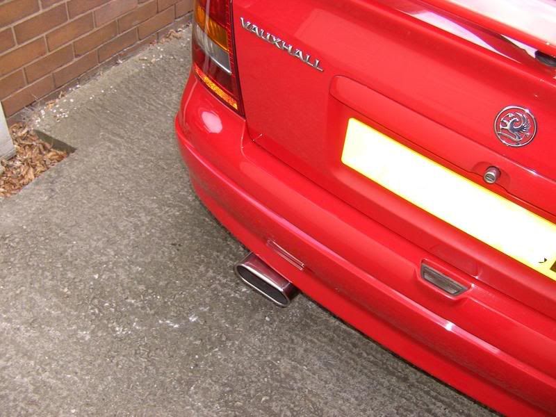

Oh also, i'm considering a different exhaust, oval DTM i think it would quite suit the back end.  smile.gif

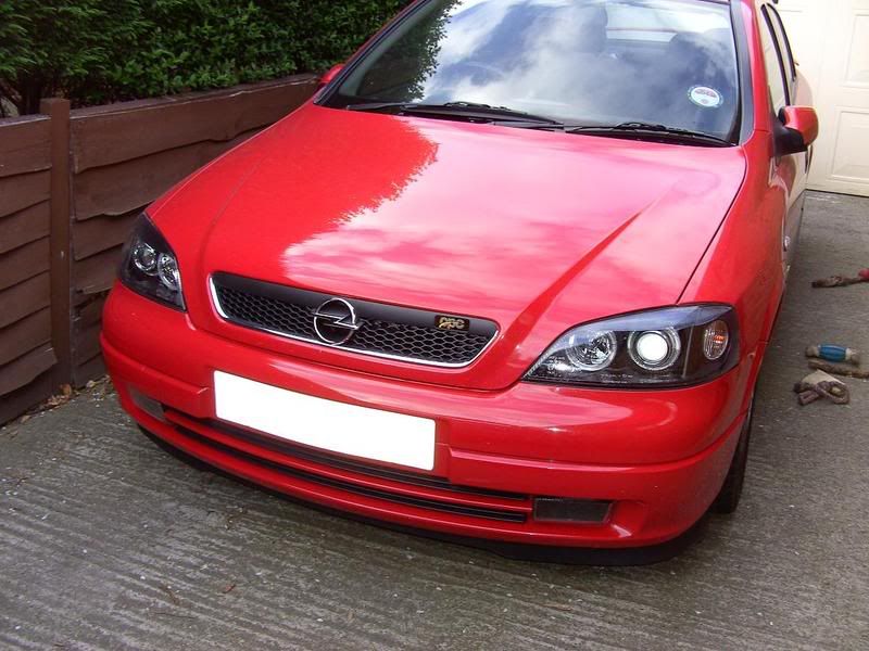

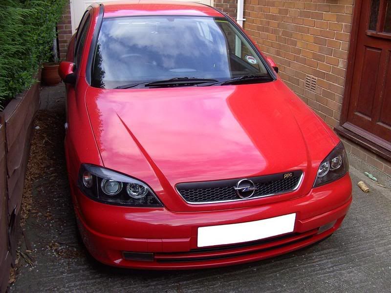

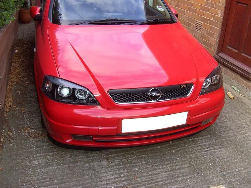

Anyway, i managed to get the front end of the car stripped down so i could swap the headlights, i think its real stupid you have to remove the front bumper to actually swap them, but it all went well and was quite an easy job.
Heres the car with the front end stripped down ready for the front headlights to be swapped:
(IMG:http://i71.photobucket.com/albums/i159/Dano2k000/PICT2054resized.jpg)

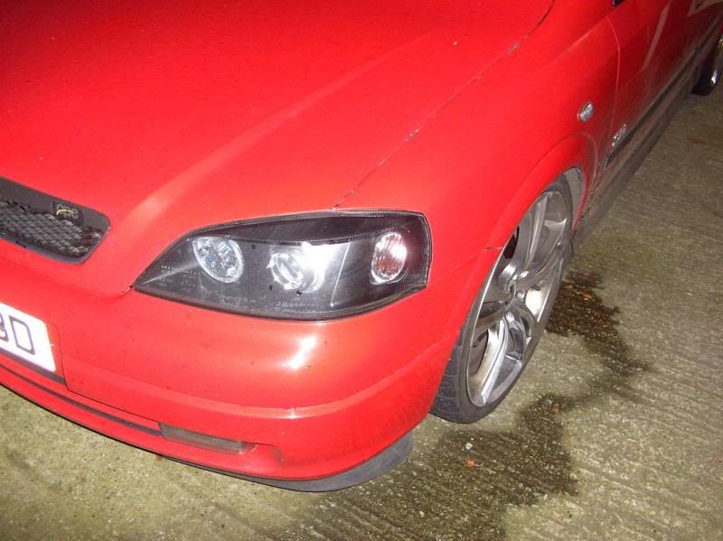

And heres the finished piece, the side lights and dip lights are on in this pic, without the dip being on it has two angel rings, which i think look great.
(IMG:http://i71.photobucket.com/albums/i159/Dano2k000/PICT2059resized1.jpg)
(IMG:http://i71.photobucket.com/albums/i159/Dano2k000/PICT2061resized.jpg)
I'll try and snap a few more pics with just the side lights on etc so you can all get a good idea as to what it looks like.
All in all i'm very happy with them, i think it makes a real difference to how the car looks.
I also took the oppertunity to buy some of those ultra bright bulbs with the blue tint to them, i got 80watt bulbs for high beam, and 55watt bulbs for dip, and they are a serious ammount brighter than the standard bulbs.
Oh also, i repaired the air con radiator when i had it in pieces, i realised the bottom right portion was falling apart, luckily it hadn't leaked so the air con still works.

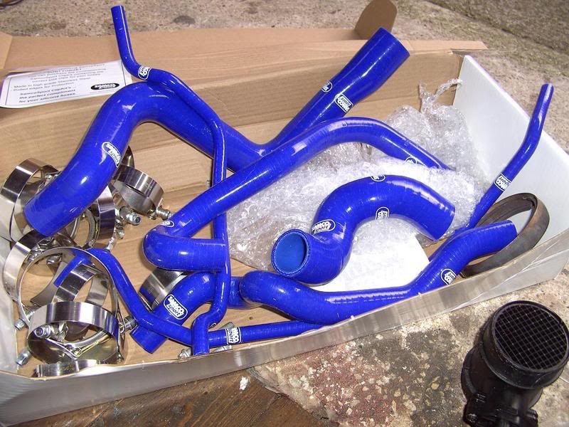

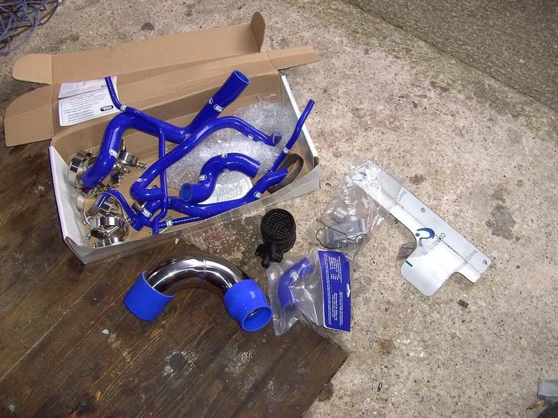

Ive also fitted my pipercross induction kit and blue silicon pipe, it looks good and makes a real difference to the sound, and does seem more responsive!

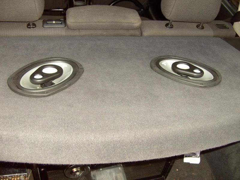

Also, ive spent alot of time running wires virtually everywhere in the car! removing trim, laying wires and re-fitting the trim is never much fun in my opinion though. Due to the ammount of wire my Avic requires to be just about everywhere, ive spent alot of time doing this and making sure its a good job, sadly i didn't really think there was much point taking pics of the wiring, but now i kind of wish i had. Ive still got some more wires to run down one side of the car for the power wire and remote signal for the amp.

I love what you've done to the center console and the projector headlighs... projectors are always an awesome addition to any car IMO.
I'm a bit confused as to why you spent the money on coilovers when you could have spent much less on simply new springs for the same lowered effect? And if you're going to go coils you'd be best served to take it to a pro to have it at least weight balanced and at most setup for whatever kind of driving you intend to do.
I think a cheap mod that would work wonders for the look would be to get some longer & stronger lug nuts and wheel spacers to give it a wider stance... while you're in there you could probably pull the brakes and spray them with some oven paint to sharpen up the look a bit. That is unless you've got the coin for new wheels and brakes  laugh.gif
Also I'd replace the grill with something badgeless and less flashy
Title: New Car: Vauxhall Astra Mk4 Sri
Post by: hamwbone on April 19, 2008, 06:36:00 AM
if you value youre life get REAL wheel spacers with that bolt to the axle, dont get the cheapos! hehe

As for the brakes and wheels, i should be getting some second hand wheels from someone in the near future, they are hardly amazing, but i think will look nice on the car, and will last me till i decide which ones i'd like as a more permanent choice. The brakes i'm getting some of those light weight racing 4pot willwood calipers for the front with some big disks and bells to suit, for the back i'm going to leave those standard for the time being, and will hopefully decide what to do with those in the future.
Lol yeah cheap wheel spacers = a big no no in my opinion, my intentions with the car are always to never cheap out on anything, so anything i'm going to do i'll hopefully do right with the best choice. tongue.gif

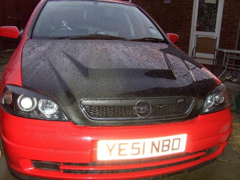

Oh and for those interested ie Twisted and others, the grill i was thinking of getting was this:
http://www.lmfvauxha...p...pe=P&id=551
Its about £80 + delivery, pretty expensive just for a grill, but i think this would look cracking on a carbon bonnet. Input on this is welcome and appreciated.
that will look "ace" or as we say in the north east USA "wicked awesome"  laugh.gif

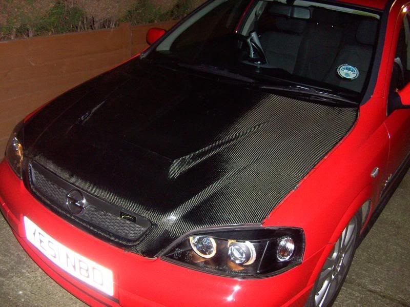

as for the carbon-fiber hood IMO they look best with at least a gloss coat, natural CF looks rather trashy IMO.
Glad to hear your putting proper wheels and brakes on in the near future... biggrin.gif
Thanks for the input mate, glad you like my idea of using that grill, i thought it was different to what you usually see modified grill wise, and should make a nice difference to the front of the car.
Yeah i was hoping to get a 'glossed' type carbon bonnet so it has a nice shiny finish, its just a pain finding some one who still produces these where you can fit a normal fitment grill in the front, ive found a company that will make me one without a grill at all, but when i upgrade to the Z20LET i'm going to need all the airflow i can get through that grill so cutting air-flow is a no go for me sadly.

nice grill, only problem is it's an opel badge on it, and youve got a vauxhall, one of those things that grind on me, but if your ok with it then it's all good laugh.gif

Tell me i'm confused but Vauxhall and Opel = same company? ie you can buy an astra in the UK with Vauxhall badges, or else where you can buy the Astra with Opel badges, they are both the same, other than in the UK, northen ireland etc we get them with Vauxhall badges instead, as Opel is vauxhall, it makes it 'different' to see a vauxhall car with opel badges on over here, so its of course abit different.
But yeah i think its fine, as in my opinion its the same brand, so it matches the car fine smile.gif
I love the look of the grill, i think thats the one i'm going to go for, hopefully i won't be dissapointed if i order that one.

Ive also got some 6x9 Vibe speakers that i'm going to mount in the rear 'parcel shelf' i was originally considering cutting the wiring half way down the car for the rear speakers and running it from there to the rear shelf, though ive figgured if i'm going to the trouble i might aswell just run new cables from the head unit up to the back with some up-rated wiring, i'll obviously benefit more with some thicker wire, so this is what i intend to do.

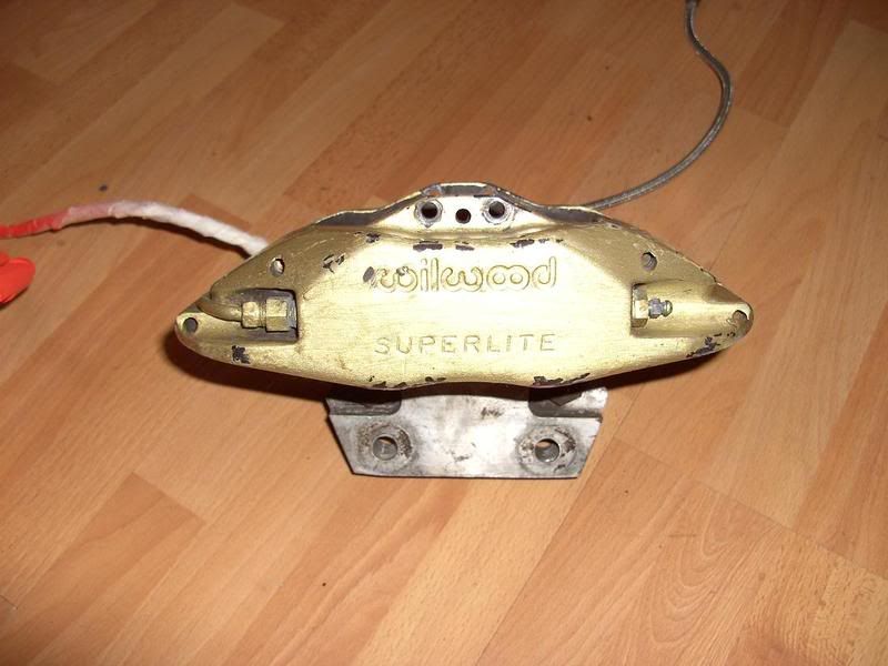

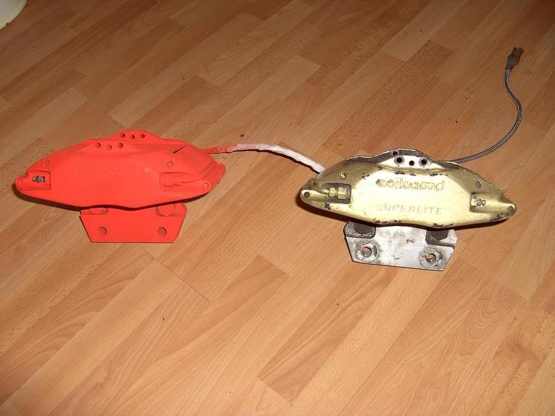

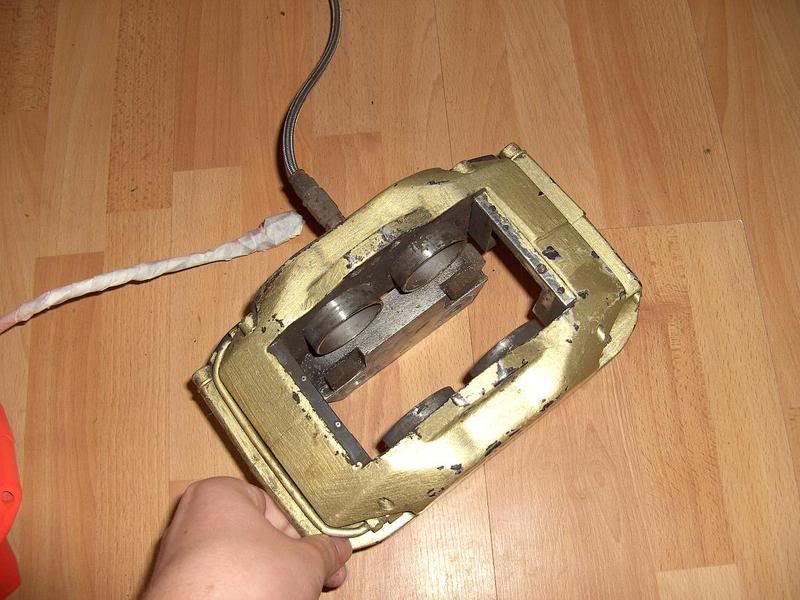

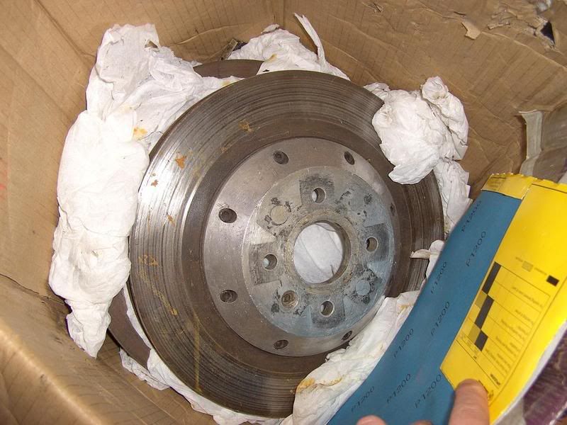

Forgot to mention ive got my new brakes today, well they are second hand, but new to me.
They are a nice pair of wilwood 4 pot calipers, need a good rub down and re-paint, but all in all seem great. I'll post some pics sometime soon.
I need to order a pair of 5 stood bells to suit yet, going to cost yet another small fortune! sad.gif

well they are all owned by GM and ya wouldnt put saab badges on it would ya? laugh.gif
just me being picky, i have a unique taste with cars and i don't like seeing cars badged up as something they are not.
hey at least it's not chav as fook with a big TURBO badge on the back of a N/A car laugh.gif
its a nice grill though, cant ya get a de-badged one or are you not into de-badging?

 laugh.gif  no i deffinatly wouldn't put saab badges on it, but the thing is both Opel and Vauxhall are basically the same company, both of them make the exactlly same car, just one says Opel, the other for the UK and northen ireland says Vauxhall, else where in the world, identically the same car just with Opel badges.
If saab made Astras exactlly the same, i'd expect some people to ride round with saab badges on them, though the thoughts of it do seem quite horrible indeed.
Lol yeah i'm not into the chavvy stuff, when i do drop the Z20LET in i was considering keeping the badges on it to say its only a 1.8 laugh.gif should deffinatly be good for a laugh when people pull up along side and think its something its not, bring on the SRi-T!!
Yeah mate i'm into de-badging deffinatly, ive looked at alot of grills and i think this is the best looking one out of all ive seen (and the most expensive for that matter, not that this comes into it) i just thought the opel badge is nice, and rare to see in the UK, and i love the honey comb mesh and the styling to it. Its got a kind of standard look, but when you look properly its far different, i thought it would give a nice look to the front end  happy.gif
I'm going to give it abit more thought before i order one, i'm really not sure which direction to go with it to be honest, though i do love the look of that grill.

Ive got my 6x9s wired up in the parcel shelf, i disconned the rear door speakers and ran complete new wiring from front to back with some uprated wiring to get the best possible from the head unit and 6x9s and the sound difference and volume is great, i just need to upgrade the front door speakers now and i'll be more happy!
Ive also swapped the exhaust, original plan was oval as this one is, but a DTM upswept style, however as this is a temp measure, this one looked good so i bought it and fitted it, personally i'm loving it at the moment, can't go wrong with some good stainless steel system!
Also, ive bought and fitted the OPC grill i had shown you all before, i know Grim, your not too keen on the opel side of things, but i couldn't resist  tongue.gif
All in all, i'm very happy all round, the car is looking great i think so everything is on track so far.

New exhaust, please also note i need to cut a little bit out of the under side of the bumper to make it fit abit better, i'll do this when i replace the exhaust bolts as the ones i'm using at the moment aren't much use!
Next up the 6x9s in the parcel shelf, please excuse the mess, i'll give it a good clean when ive finished off mounting them in 100%
Lastly, heres the new grill fitted, personally i love it, really transforms the look of the front end.
Haha yeah i do, i think i'll eventually remove the vauxhall badge, not sure if theres a small hole behind it or not though. In the event there is it'll have to wait for abit as ive got more important things to do before that.  smile.gif
Thanks for the feedback on the grill though, glad you like it. I'm very pleased with it at the moment.

Also ive still got to finish the refurb job on the Wilwood calipers, they were second hand and in crappy condition when i bought them, hence the price i paid, but i got a good buy. Theres nothing wrong with them as such other than they looked crappy. Someone decided it was a good idea to paint them gold, and all the paint is chipped and rubbish so ive been sorting one of them out and been spraying it with red temp paint. Infact i'll do a little update below with some pics and details for everyone to see.  pop.gif
As i was just saying to TS above, ive been working on one of the Wilwood 4pot calipers, they are the superlite calipers and weigh very little!
When i originally got these, i got them second hand and some fool decided it was a good idea to paint them (doing a crappy job aswell) in gold, they have been kicked around abit and alot of the gold had chipped off etc.
So what ive been doing is refurbing them, ive been giving them a really good sand down, clean and spraying up in a red heat proof paint. I'm not 100% sure on the exact tone of colour though, but i think if i paint the text back in, using some black paint then they'll be looking good.
When i do get my wheels sorted and paint them in the dark metalic grey, these should look amazing behind the wheels!
Anyway heres some pics, you can see the one ive been working on thats now red. Ive photographed the other so you can get an idea as to what they originally looked like.
Oh and heres a shot of one of the bells and rotar, other than the sheer size of these things, they don't look too impressive so i'm really considering getting some new rotars aswell, i was hoping for some drilled ones or something as i think they'd look stunning with the rest of the setup.
You can see from the picture these things are big.
I'll hopefully be doing some more work on these shortly, and i'm hoping soon i'll have the wheels sorted and these sorted aswell so i can get them straight on the car.

nice work, you must have a lot of experience in this you look like your doing a good job on well everything. I really like the sat nav display you did.

Thanks mate, ive got a decent ammount of experience with car modding, and general work so i do my best when it comes to the stuff on my car. When you get your car you should buy some nice parts too wink.gif to be honest the majority of what ive done so far is straight forward and easy. I enjoy making my car what i consider better looking, increasing performance in almost any respect, and of course getting the customised look to how i like it.

Looks good m8, love them headlights!
Been thinkin of getting an angel eye kit for me beamer.

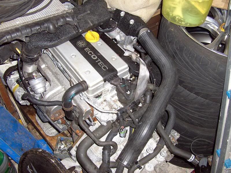

As ive said a few times in this thread, ive been wanting to drop a Z20LET in place of the current engine (2.0 turbo engine)
Ive been looking for one of these engines ever since i got the car, as this has always been my intention, they only made these GSI turbo spec engines till 2004, so thats as new as i can buy second hand really.
After much research i finally found a guy that lived 200miles from me who had exactlly what i wanted, the engine came from a write off nearly 2 years ago and had been sat in storage since as he didn't end up using it, best bet is its come from a garage with a receipt for guaranteed mileage.
Basically ive got the engine, gearbox, turbo, ecu, wiring loom, drive shafts, hubs, brakes, steering rack etc etc basically everything from the front end of the car for complete conversion, minus a few things such as radiators, intercooler etc.
The engine has genuinely only covered 7,000 miles from new, so the engine has barely ran in at the moment.
Its still sat in the back of my garage, but i'm piecing together everything else i need and will hopefully start making progress with fitting the engine in the next 1-2 months.
Heres a couple of pics i snapped, also note you can see my new wheels stacked up there in the pics, though i need new tyres on them, and still need to paint them, so they are still not on the car as of yet!
(IMG:http://i71.photobucket.com/albums/i159/Dano2k000/PICT2679.jpg)
(IMG:http://i71.photobucket.com/albums/i159/Dano2k000/PICT2676.jpg)
Ive got alot of confidence in this lot, in the future i'll be doing many mods including bigger turbo, inlet cam, etc etc.
Oh and heres one for Grim that said the car needed a good polish, it did indeed and now it looks a different car again, sadly it rained on it before i got to take any pics, but you can see how good the paint looks now, its very shiney and reflective, personally i think its one of the best reds ive seen on a car! Sadly the rain doesn't do it any justice and really does take away from the look when dry.
(IMG:http://i71.photobucket.com/albums/i159/Dano2k000/PICT2681.jpg)
(IMG:http://i71.photobucket.com/albums/i159/Dano2k000/PICT2687.jpg)
Took those pictures down at my fiancees house by the way for those that will release its not on my drive.
Enjoy the pictures and we should be seeing good progress in the near future.

Nice mate, the polish looks really good. Looking forward to hearing that 2.0 turbo muhaha.gif  cool.gif

Cheers mate, glad you think shes looking good.
I'm very happy with how the paint work ended up, needs abit more work in a few areas but all in all shes back to good looking flame red.

Better yet, i really can't wait to see what power this thing has to offer, with a few tunning mods i should be seeing a good power gain on the standard 200bhp, in the future with the VXR turbo, VXR injectors etc and a good remap with a front mount intercooler i should be saying power well on the way towards 300bhp, gona go for the performance inlet cam too.
After this stage, it'll be time for some forged pistsons and rods or else somethings gona give!
I'll be happy with somewhere in the region of 300 though, should be a very fast car.

Post by: grim_d on August 23, 2008, 01:58:00 PM
told you mate, she scrubbed up well, looks 1000 times better, paint acctually looks red in the photos. Infact she loks brand spanking man.
Looking forward to seeing that lump in, should be a bit of a monster. what you SHOULD do is forge the fooker before you even put it in, quaife/ppg high ratio gearset and a 3071, but thats the dream lol.

Wow. This Vaux really came together. Are those Wilwoods Standard or Aftermarket on those cars? If they Standard, America need to step it up. lol Anyway, I like the overall look of the car. You did the exhaust yourself. how hard was it to do? I been thinking about removing my muffler on my car and running a Straight Pipe for a better sound aong with a few more Horses.

The brakes won't be going on for a little while sadly, instead for the time being i'll be upgrading to the 308mm disks and calipers i got with the engine lot that i bought, i will however be going to the 4pots in the future, i have to fabricate some brackets for mounting them properly and need to figgure out what bells i'm going to use. I started modifying the others to suit my car but realised it would mean pushing the wheel out more than i would allow it to, as such the tyre would have scraped to hell in the front arches so i'm not going down that road, i need to give it some carefull thought and get them on in the future, for the time being however the 308s should make a good difference, might even paint the calipers up so they'll look nicer behind the wheels.

The brakes youve seen in the pictures are aftermarket sadly, would be nice to get some 4pots standard though  muhaha.gif as above i was explaining they'll be going on in the future due to some complications which i'll be sorting out as and when i get time really, ive got far more important things to sort out first, so for the time being i'll be putting the 308mm GSI brakes on the front, who knows i might even get some better disks, we'll see.
Yeah i did the exhaust, pretty much any exhaust is a piece of cake in my opinion, if youve got a basic range of tools you'll have no problem swapping the exhaust, sometimes the originals can become stuck together depending on the type of fitting, but they usually aren't a big deal. If you can buy an aftermarket pipe for your car, should be dead easy to swap it over. Just watch out for how much of the exhaust you swap, and what type you swap to, or else you might find its abit too loud  laugh.gif
Soon enough when i fit the turbo engine, i'll be swapping the exhaust completely on my car for a full tunned system for some good gains, i think i'll porbably be going with the milltek system so should be good. smile.gif

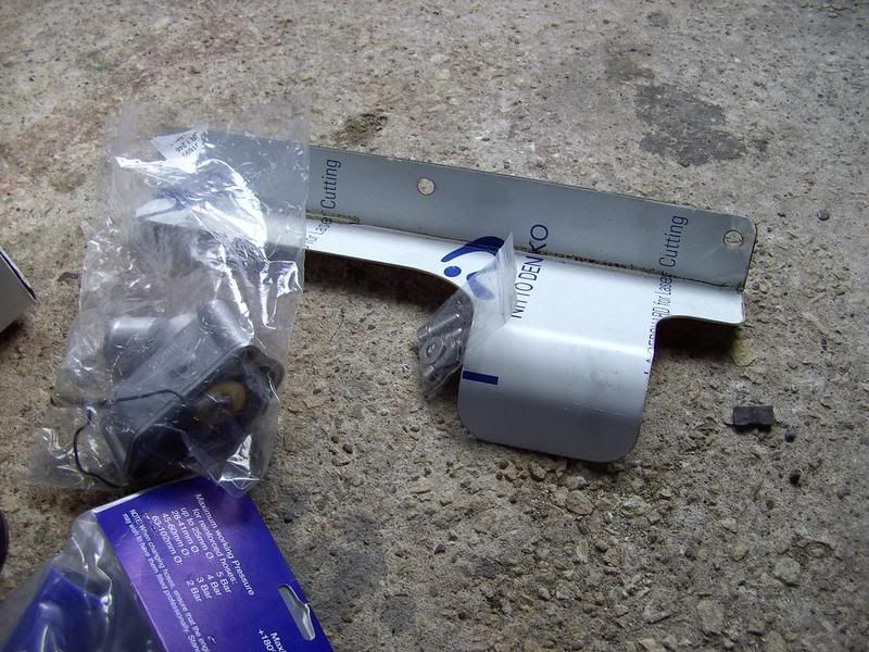

Ok guys, well haven't had time to go round snapping pictures of all my bits and pieces as of yet, will try and do that soon. I did a while back however snap a few pics of some of the bits i had got, so will post those for you all to see.
Basically other than whats in these pictures, ive got my front mount intercooler and all pipe work, map sensor, first lambda sensor, bailey dump valve, metal boost pipe with samco joiners, brand new radiator to suit, battery jacket, alloy fan casting with fan, multi function display and some other odds and ends ive probably forgot to mention.
As you can see in the pictures below, ive basically got the samco water hose kit, air flow sensor, stainless air intake pipe with blue silicon joiners, alot of hose clips of various sizes, cool running stat and exhaust heat shield etc, the heatshield however still has its protective film on in the pictures.
(IMG:http://i71.photobucket.com/albums/i159/Dano2k000/PICT3246resized.jpg)
(IMG:http://i71.photobucket.com/albums/i159/Dano2k000/PICT3245resized.jpg)
(IMG:http://i71.photobucket.com/albums/i159/Dano2k000/PICT3244resized.jpg)
(IMG:http://i71.photobucket.com/albums/i159/Dano2k000/PICT3243resized.jpg)
When i'm next back up home, i'll snap some more pics of some of my other bits for you all.
I was hoping the engine would have been in a good while ago now, but unfortunately ive not got round to it and sourcing everything i need has been a pain at the best of times.
Fingers crossed, the main things i now require are only, second lambda sensor and complete exhaust front to back with sports cat. Once ive got these more or less sorted, i should be starting the conversion very soon so we should be seeing alot of progress very shortly.

Post by: bucko on October 21, 2008, 12:04:00 PM
Sweet they look good build quality and blue is my favourite colour biggrin.gif

Post by: grim_d on October 21, 2008, 12:06:00 PM
cant beat an engine bay crammed full of samco hoses laugh.gif bet you are dying for some boost lol.

Yeah mate, samco hoses are the way forward in my opinion, great build quality compaired to the OE hoses.

Yeah Samco'd engine bay is mint, doubt i'll have an engine bay full of samco so to speak, but should be looking pretty smart none the less as almost all hoses will be in blue including the ones for the front mount intercooler.

New wheels and tyres (the wheels ive had in the garage more or less since i got the car  laugh.gif )
Carbon bonnet
New interior half leather / half alcantra

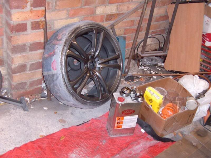

First on the list was sorting out the wheels and tyres, the new tyres ive bought were hardly cheap, 35 series profile made a nice hole in my wallet..  sad.gif
Anyway, Toyo Proxes T1R's all round.
Wheels needed a good refurb, sanded them down, tried them on the car with the old tyres on first for fitment with her being so low, primed them, only to find out there was going to be a reaction so another sand down, re-prime, paint and laquer.
I'll let the photos do the talking of the process (didn't take many, was too damn busy lol)
Obviously in the above pics, the centers weren't in, neither were the dust caps on.
Pics of wheels on the car:
My new bonnet fitted:
I always did say i never intended getting a carbon bonnet with vent, this one came up second hand and the price was a reasonable ammount less than a new one, so i took the chance and bought it.
Over all i'm happy with it, looks good on the car in my opinion, and i came to the conclusion the vent may be good for when the turbo lump goes in, the more heat i can get rid of from that exhaust manifold, the better!

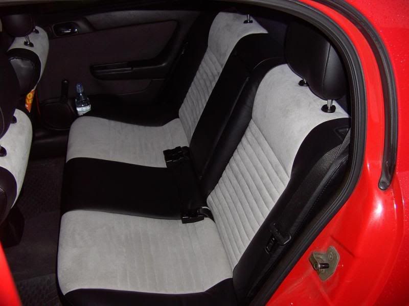

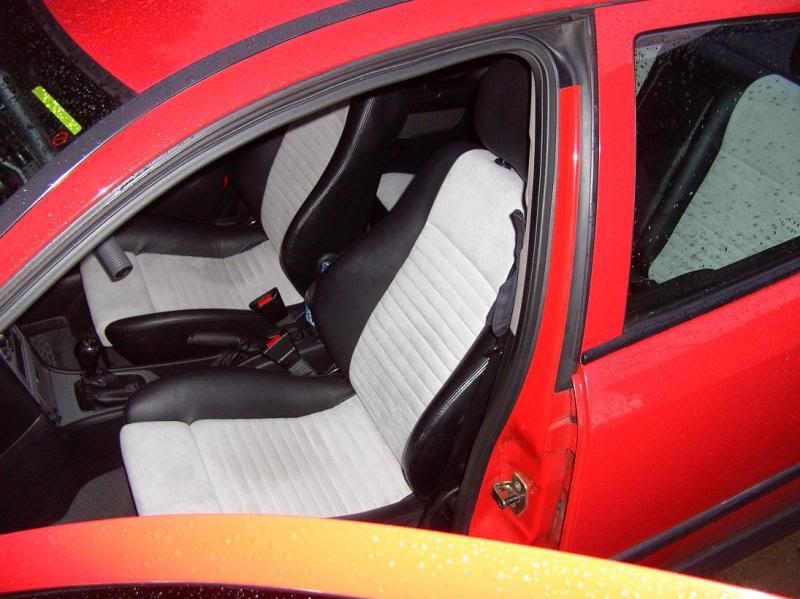

Lastly my new interior, half leather / half alcantra, got this at a reasonable price, needed a damn good clean though. Do please note, the alcantra is nice and clean, it may look funny in the pictures, but its because some of it is brushed one way, and the other is brushed other ways. If you rub your hand over it, it looks different again lol.

Thought i'd post these here also, a couple of pics i snapped off in the dark.
I know they aren't great pictures, quality is pretty crap, its dark and cold outside aswell so it didn't help..
I'll post some better pictures also when i take some.
In the mean time enjoy.

thats a beaut really nice work
Post by: grim_d on December 07, 2008, 06:32:00 PM
those are some nice wheels mate, excellent colour, i see we use the same tack rags laugh.gif
need those big brakes on peeking out, the red calipers will look sweet
glad you got a carbon bonnet they look the nuts, vent or not.

Perhaps it's just the pics, but the wheels look a bit small and don't seem to fill the arches properly... both width and circumference. I don't know much about modding cars, so what do I know? tongue.gif
I love the everything else though mate, especially the seats.

QUOTE(grim_d @ Dec 8 2008, 02:08 AM) View Post
are you going to paint the side skirts and splitter? would look very clean with only the bump strip black.
yah gti was sold when i phoned sad.gif constantly on the lookout for a fairly clean example for about a grand that i can take on as a mini project and make immaculate. My new work has a warehouse that i will be able to use for working on any car i get so dropping a standard sr20det in could be an option also.
Cheers mate, yeah i love the look of the wheels on the car, colour really suits the car. Where you get your tag rags, fancy using same ones  laugh.gif I get my paint and other kit from a local paint shop, cracking guys that work there, they sort all sorts for me.
Over-all i'm well pleased with the carbon bonnet, gave the car a whole different look, i wasn't too sure for a long time on the vent, but its kind of working for me now, should deffinatly help with the extra heat that it'll soon be recieving.
Ive got to get some better brakes on, with these 18s on they look seriously small  laugh.gif Hopefully in the somewhat near future i'll be fitting the 4pots, got some more complications to work out though, but once they are on should be cracking. In the mean time, when i get the engine conversion on the way i'll be upgrading to 308mm disks, ive got the carriers etc for the conversion, would have been nice to get some drilled disks on to make it abit smarter, but we'll see  smile.gif I'll get the calipers paint up a nice red aswell when i get those new ones on.
Gutted for you on the GTI mate, will be great when you get cracking with a good project, be sure to drop me a message when you get sorted, it'll be nice to see what your up to. Yeah also get yourself a SR20DET could be quite a machine with a few tuning mods  muhaha.gif
Nice one mate, and cheers for the good feedback, nice to know you think its going the right direction.

QUOTE(jimbobjim @ Dec 8 2008, 10:10 PM) View Post
Must just be the pics mate  laugh.gif the wheels are 18" they deffinatly aint small, the wheels are too wide for the tyres, the tyres are stretched onto the rims, i can't get anything any wider on though or else it would scrape seriously bad at all times, especially at this ride height lol.
I think half of what might give you that impression may be the very thin side wall.. 35 stetched serious tyres.
The overall diameter of the tyre is exactlly the same as the original wheels if you get me.. like from floor to the top of the tyre is exactlly the same height as the original, it had to be to keep the speedo within reason lol or else it would end up giving the wrong speed.
It needs lowering more on the back end, might take it down abit more in the near future.
Looking back at the picture, i guess with it being so dark, the wheels tyres and arches being black, it gives a false sense of how big the wheel / tyres really are.
Looking back at the original wheels, you'll probably get the idea..
Cheers for the comments on everything though mate, yeah i too love the interior, most deffinatly much nicer than the original, a good bit more comfy too.

Ive finally got around to sorting the garage out a little, got my engine out and have been doing abit of work on it.
Firstly i stripped the auxillery belt off, removed the timing belt covers, ready for swapping the timing belt.
I also then went onto swapping most of the hoses on the engine to my new samco ones.
Fitted the new cool running thermo stat, along with the nice shiney exhaust heat shield.
As you can see, abit of rust and general dirt has found its way around the engine, having said that it hasn't ran for about 4 years now  laugh.gif Ive had it less than a year so thats not nearly all my fault..
Although i haven't taken pics, ive now replaced the timing belt, just need to rebuild the covers and bottom pulley.
I also need to put the crank shaft sensor back in, borrowed it on another job.
Anyway heres the pictures of how it was and how it stands roughly now.
Since these pics i have put jubilee clips on the breather pipe i originally stuck on as a temp measure when i borrowed the original. Also as above, ive replaced the timing belt, just hnaven't taken pics yet,
I'm gona give it a blow off tomorrow with the compressor to get the rubbish off and build back up what ive took off.

Haha yeah i know where your coming from, a few people have made up daft stuff out of the reg plate at different times.  (IMG:style_emoticons/default/tongue.gif)

I bought a brand new set of 308mm drilled and grooved brake disks aswell while i was on the job, thought it would be worth while. I think they will be looking great behind my 18s.

Lastly one in the 'bay showing how shes looking, still plenty of bits to be getting on with.

Heres the pictures now shes back together anyway:
First of all i'll show the new exhaust then i'll just get on with the rest.
(IMG:http://i71.photobucket.com/albums/i159/Dano2k000/PICT4637resized.jpg)
(IMG:http://i71.photobucket.com/albums/i159/Dano2k000/PICT4625resized.jpg)
(IMG:http://i71.photobucket.com/albums/i159/Dano2k000/PICT4626resized.jpg)
(IMG:http://i71.photobucket.com/albums/i159/Dano2k000/PICT4628resized.jpg)
(IMG:http://i71.photobucket.com/albums/i159/Dano2k000/PICT4633resized.jpg)
In this pic you can also get a sight of the new brakes fitted, look much better behind those wheels than the old ones did.
(IMG:http://i71.photobucket.com/albums/i159/Dano2k000/PICT4642resized.jpg)

There is still plenty that needs doing, shes going strong at the moment though and has loads of power to play with.
When the weather is abit better the bumper needs coming off, tidying up and some modifications making.
Over-all i'm very happy with the conversion its gone brilliant. Just a few minor issues to work out then all should be good.

Hmm, I prefer how it looked in the beginning pictures. Just needed a good mop and bits like the SRI alloy trim cover replacing. and a GSI kit with all OE performance styling mods but thats just me. It's your car so do whatever you wish biggrin.gif

brakes looks much better than those old bottle caps.

Lastly the new Morette headlights, very happy with these i think they suit the look alot better than the angel eyes did.

The morettes look great and even better they are real ones. much much more classy than angel eyes i think.

Yeah i'm well pleased with the Morettes Grim, they suit the car much better and things have made it go from strength to strength looks wise as i now have new wheels which tie the morettes in even more so.

First of all, colour coded door handles and a good clean, made a huge difference to the sides of the car, just awaiting on colour coded side skirts now.
Next up was a prodrive rear splitter, no fiberglass on this, its the genuine pro drive GRP type part, very rare was originally on the SRi-Turbos.
Had to remove this from another bumper where someone had bodged it on, then re-paint it in the colour of my car and heres the result, looks 100x better in my opinion.
Also ive now got a new set of wheels, i was getting abit fed up of the 18s, the side walls were too thin for our country, i was fed up of the pot holes, so i down sized to some 17s. Also another issue i had with my old wheels was cleaning them, they were a nightmare to keep clean due to the lack of space between spokes etc.
Anyway i decided on the wheels i wanted, which have much bigger spokes, painted in black aswell biggrin.gif
I think they suit the car alot better than the old wheels, think general feedback pretty much everyone agrees. I kind of miss the 18s but i love how it looks more with the new wheels on.
(Please excuse the fact its dirty in these pics, also wet through as it had rained)
Overall i'm very happy with the most recent modifications, looking much more like i wanted.
Future plans now are theres various little bits i'd like to sort out, i have also aquired a Pro drive front bumper, which needs alot of prepping, painting and fitting, i also got some GSI sideskirts, and rear arch spats which need painting and fitting also, plus a GSI spoiler which needs the same work aswell. Once these are done and on, i'll be far more satisfied with the look of the car. No doubt i'll come up with more to do on it, but its getting time to begin concentrating more on power wink.gif
I have got quite big plans for the power of the car, in the near future i'd like to be pushing in the region of 350bhp, and in the future from this point on ideally i'd like to be going above this, but for now 350 is a realistic target and will be plenty for now. Just going to be a case of deciding for sure what parts to buy and slowly buying them all in, going to ideally need forged pistons / rods, arp bolts, piston rings, possibly some new bearings while i'm there, tubular manifold and i think turbo wise i'll go for something like the GT28RS. Also going to go for an uprated inlet cam at least, possibly do both.
When i get chance after which point the head is going to have some work done aswell, but this is going to be a good bit down the line now.

EDIT: Just for the crack of it, hard to believe this is what it was like just abit after i got her, in these pics only mods was lowered and exhaust  laugh.gif
Just thought i'd post those for anyone who cares, hard to remember when it looked like this lol.

Dano, what kind of IC is that and where did you get it from, price?
ill be looking for one similar in size shortly.
