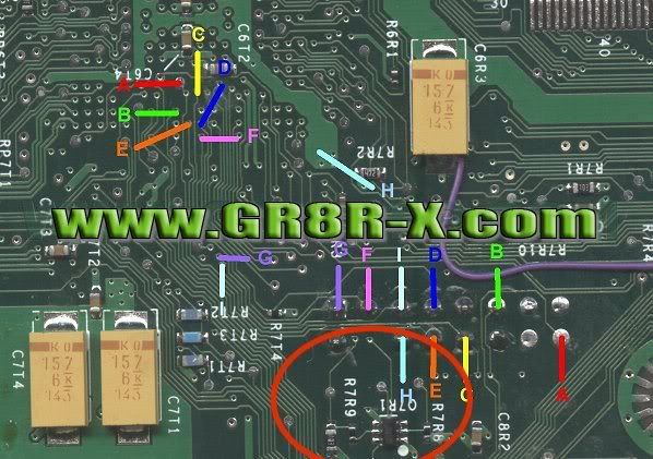

I haven't got any further with this much, but decided to test the same points on a "normal" FRAGing board and on that one there is 3.3V in that area (after the 3 boot attempts). Meaning that having 0.0V there is specific to FRAO boards.
What does this IC do? I took readings off it on my v1.0 FRAO and a normal v1.0 and they are different:
(IMG:http://www.meltdown.fsnet.co.uk/pics/XBOX/lpcicfrao.jpg)
(IMG:http://www.meltdown.fsnet.co.uk/pics/XBOX/lpcicnormal.jpg)
I don't know enough to find what I'm looking for, so it needs more able techs to solve it.

Post by: ferrari_rulz_02 on August 31, 2005, 03:34:00 AM
have you got a fully working board that you can take the same measurements off?
Title: Tries To Boot 3 Times Then Flashes Red And Orange
Post by: PimpleX on August 31, 2005, 11:44:00 AM
QUOTE(ferrari_rulz_02 @ Aug 31 2005, 11:09 AM)
Bottom pic above is v1.0 normal working mobo.
Cheers,
PimpleX
Post by: ferrari_rulz_02 on September 01, 2005, 02:22:00 AM
ok, the first thing id be doign is backtraking the 3.3 on teh workign board.
check with the non-working board at the same time, following the trace.
Post by: AfterTheInsanity on September 08, 2005, 05:08:00 AM
I just had this problem with mine, but I actually got it working. Give this a shot for yours:
Do this
Then run a wire from the back D0 to the front D0
And if you have emptied out your LPC holes, fill them.
Thats exactly what I did step by step and now mine boots up fine.
Post by: ferrari_rulz_02 on September 09, 2005, 02:52:00 AM
QUOTE(AfterTheInsanity @ Sep 8 2005, 10:19 PM)
well ill have to remember this thread then
Post by: PimpleX on September 09, 2005, 03:48:00 AM
QUOTE(AfterTheInsanity @ Sep 8 2005, 01:19 PM)
Do this
To be blunt there is absolutlely no reason for that to work at all sorry. And doing them one after the other in some voodoo fix is even more bizarre.
The red-orange "fix" is only IF the small trace you are bypassing is broken. (test with multimeter)
The D0 to D0 will do exactly NOTHING unless the D0 to D0 link trace is broken. (test with multimeter)
Filling the LPC holes may fix a bad LPC point, (again test with multimeter to see if it actually is a problem), plus  won't help on v1.0 which seem to make up a fair proportion of FRAO boards as they already have the LPC holes filled anyway.
I'm telling you the two most likely candidates for this FRAO problem are looking increasingly likely to be an IC that is fritzed, or else the RAM has gone bad.
Cheers,
PimpleX

so u guys think if i do this   http://www.xboxscene.com/articles/red-orange.php   it'll fix my problem
also wut gauge wire should i use for this fix?

I tested my mobo today, and found oh my, 0.2 volts on pin 5!!  I am going to try the tut fix and hope very strongly that it works.  I will let you all know if it works.

Post by: omg0t on October 03, 2005, 09:23:00 PM
could someone show me a big, good quality picture of where exactly i should solder in this tut http://www.xboxscene.../red-orange.php
also wut gauge wire should i use?
and can i still boot the tsop with this and boot from the modchip with my smartxx v2.0?

QUOTE(omg0t @ Oct 4 2005, 02:34 PM)
just use something small, so that you can easily mould it to where it has to go
Post by: thedominor on October 04, 2005, 01:26:00 PM
I have a wire harness from a xecuter install with some really small wires left over, and i used that.  I think the best gauge to use is around 30, very small, but its kinda hard to find in stores i think.  Unfortunately, I tried that tutorial, and it didn't work for me.  I still get .2 volts on pin 5.  Although i think that it is fraging now instead of Frao?  i'm not sure though.  also, If anyone has suggestions I will certainly try it, because since there is so little i've seen about this, I am going to order another mobo, so this one is an Anything-Goes.  Anyone know for sure what happens when the mcpx dies? or GPU?  the no video is what is making me suspicious.  as for a good picture, I found one using the forum search for frao.  If it was in other frao thread but the picture uses a different point on the lpc, and via that is connected to pin 5 i guess. good luck! and let us know how it goes.

i'll try the pin 5 to lpc fix sometime between now and saturday, i'll tell u all how it works out for me on saturday
Post by: omg0t on October 05, 2005, 09:54:00 PM
didnt work, anyone got any ideas on wut i should do now?

Post by: Dallas186 on October 20, 2005, 03:11:00 PM
Hi Guys,
sorry to jump into this thread right at the end but i recently had exactly the same problem with a V1.0 that was brought into the shop which was FRAO, I don't normally repair Xbox's only PS2's but it was worth a go, no fix no fee.
pin 5 (RST) of the LPC was showing 0.17V which i knew couldn't be right from trawling data from this site.
Initially i couldn't find the problem but was 100% sure that it wasn't a broken trace but had a gut feeling that the problem lay around the LPC area, (initially supecting R7R5 even though the meter said not) but after changing all 4 resistors it showed no change. so stuck at this point i bought a working V1 motherboard from ebay and compared readings like for like.. the significant factor was only 0.17v coming out of the 6pin chip on pin 6 as opposed to 3.2V on the working board!
swapping the chip off of the working board (very carefully) and soldering it onto the non-working board solved the problem , 3.2V on pin 5 and the box booted normally.
unfortunately now i'm left with a broken v1.0 board and no profit but hey smile.gif
PimpleX threw up a very nice photo of the board at the start of this thread so iv'e stolen it (sorry m8) to show the chip that i'm referring to (it's ringed).
Now if any of you guys that know far more about the Xbox than i ever will can identify what this component is I too would be mucho grateful!!
I took a photo of that part of the board when comparing the 2 boards side by side and have reference to the voltages at most points around that area and resistor values from the working board if you would like me to post it.
strange thing was R7R8 read 47k on the non working board and 20k on the working board (ummmm)
I hope this helps anyone else that is showing low V on pin 5.
Best,
Rich

Post by: Dallas186 on October 21, 2005, 04:32:00 AM
QUOTE(Dallas186 @ Oct 20 2005, 10:46 PM)
Hi,
decimal point missing, sorry 4.7k is the correct value for the resistor R7R8, reading 2.0k was more than likely pulldown from something else.
just going back to this IC for a second, Iv'e got a theory that it's actually a dual transistor in SOT-28 format.
I have now also bought a (repaired-now working) 1.4 board and can confirm that the component is the same on version 1's and V1.4's so it's a fair bet that the component is common to all versions though this is a hunch.
I'm tempted to pull this component off the 1.4 board and see if i can work out what it is (wish me luck)
can anyone else with the FRAO problem just confirm that they see low voltage on pin 5 of the LPC and the SAME voltage on pin 6 of that 'IC' at least then it shows a theme to the problem and not that the FRAO just means that a component has gone duff and could in fact refer to ANY component as was so eloquently described in an earlier post...lol
that would really help me.
Best,
Rich

Post by: Dallas186 on October 21, 2005, 07:01:00 AM
QUOTE(PimpleX @ Oct 21 2005, 12:37 PM)
You mean changing this q7r1 IC fixed it after all??:
I just figured I must be barking up the wrong tree when I considered it to be that, then because the traces mostly go to the MCPX I figured it must be there instead due to likely heat failure LOL...I will have a go at swapping one over soon.
Cheers,
PimpleX
Yes, i'll almost guarentee that if you can change Q7R1 for a known good one then you will regain 3.2v on pin 5 of the LPC, whether that would will cure your FRAO problem remains to be seen but i WOULD love to know.
when i get home i'll compare your voltage readings with the ones i took on the duff IC before it was changed out.
Rich.

Post by: PimpleX on October 21, 2005, 07:36:00 AM
Ok I changed it on my v1.1 and yes I get good volts on the LPC now, ....but still 0.0v on the MCPX and it FRAGS.
Volts on the MCPX look much better during 3 boot attempts though than they did previously, but still 0.0v after the 3 boot attemts. Whereas "normal" FRAgging boards have 3.3V on the MCPX I'm pretty sure I tested for before now and that's right,.... correct me if that's wrong though.
There are also two more of these ICs the same markings on top of the board, one near the MCPX and one near the TSOP,..... I've measured the volts on them and the one near the TSOP gives almost the same readings as the q7r1 IC on the same board, so make an easier measuring point to check I think. However I'll try that all again just to make sure that's correct. There are also two flavours of this IC that I've found so far, one like the photo above looks like MA-I the other looks like MAk, still not enough info to look anything up about them though...
This was really fiddly to change mind and I made a bit of a mess of it to be honest (about 5 x harder than the 1.6 tranny change I'd say) and I had to redo it twice LOL and you have to get it the right way around. Mind you I'm using an ordinary 18w soldering iron and tip, nothing fancy, I think I'll put wires on the next one and solder them to the pads instead for a more "certain" result.

Post by: Dallas186 on October 23, 2005, 04:10:00 PM
Hi again guys,
ok, done a lot of thinking/searching/head scratching on this one and FINALLY sorted it!!
the component in question is indeed a dual transistor of the NPN flavour, it's a MBT3904DW1T1 manufactured by 'Motorola' and the format is SOT-363. Basically it's a dual 2N3904 general purpose signal transistor.
you can grab the datasheet for it here
from the datasheet we get that
Pin 1. Emitter Q1
Pin 2. Base Q1
Pin 3. Collector Q2
Pin 4. Emitter Q2
Pin 5. Base Q2
Pin 6. Collector Q1
this now all makes perfect sense!
just to prove the point i did a bit of a test using actually 2 BC337's as it's the nearest i could find to hand, soldering them onto the motherboard in place of the blown MA IC and it worked, booting into the dashboard without any problems.
it's not pretty but proves the point!!
Tomorrow i'm going to try and buy some proper MBT3904DW1T1 IC's.
but really this is not a noob fix, soldering these in place on the MB is a complete nightmare and just heating them for a fraction too long blows them, so although not pretty the 2N3904 or indeed BC337 alternative is really actually easier and only cost 13p each! it's just working out where to solder each leg that's tough smile.gif
To determine if it's this chip that has blown (which incidentally caused a FRAO on my V1 and a FRAG on a V1.4) test the voltage on pin 5 of the LPC, if it's less than 3.2v then this is the problem. to further determine do a search on the web for 'testing a transistor using a DVM' though you will almost certainly need to desolder the IC to thoroughly test it anyhow.
I hope this helps those that are suffering with this problem
Best regards,
Rich.

Post by: PimpleX on November 02, 2005, 07:19:00 AM
Results:
Now I have a smaller tip and some desolder wick things are a whole lot easier to do.....
Fitting the trannie corrects the 0.196v (0.2v) problem on LPC pin 5 on both my boards (v1.0 and v1.1), they now show 3.3v as normal ......BUT they both boot 3 times then FRAG and have 0.0V on the MPCX. The LPC is all good, but both still frag. During the 3 boot attempts the volts on the MCPX do hit 3.3v, then are 0.0v when it's running and flashing red and green though.  blink.gif
Possible scenarios:
1.The dual trannie does two jobs, one for the LPC pin 5 and one for the MPCX and I fried the MCPX half of the trannie on install...but that's doubtful on two boards and careful and neat install.
2.My MCPXs have died
3.On my boards there's another fault besides the dual trannie killing power to the MCPX.
I have double checked my soldering.
Cheers,
PimpleX

Post by: PimpleX on November 02, 2005, 07:40:00 AM
Just to correct the above post: (edit time ran out)
Results:
Now I've got hooked up on this 0.0V thing on the MCPX and it turns out to irrelavent as all FRAGing board do that!!! I just tested it by earthing D0 on a working board and it does exactly the same thing, funny I'm sure I tried this before and got 3.3V ...anyway I now think 0.0v on the MCPX doesn't matter as long as it hits 3.3v during the 3 boot attempts then the MCPX part of the circuit looks good. (that's my now theory anyway!!) blink.gif
So I'm back to fragging board with good LPC volts,....I have double checked my soldering.
Suggestions?
Cheers,
PimpleX

Post by: Dallas186 on November 03, 2005, 08:15:00 AM
np mate, glad that you received them so quickly.
ok, the original MA was clearly duff as at least now you have 3.3v on pin 5 which has gotta be a move in the right direction.
i'm not convinced that this particular component is responsible for powering the MCPX chip anyway, primarily because at 200ma (MAX forward I) it wouldn't have the guts to drive it.
IMHO you need to be looking at something more like the MTD3302 NFET transistor but i really am NOT an expert on Xbox hardware, (i'm learning so please bear with me) so i really could be talking b0llocks.
I assume that you have another working board from which to take some comparative readings, if not i have a breadboarded v1 on the bench at the moment, let me know if you need any data from various points on the board.
I'm sorry that replacing this dual tranny didn't solve your problem, but just to confirm that it IS the right IC for the job i soldered one in place of those 2 BC337's on a V1.4 board (from earlier in the thread) and voila! it worked perfectly, though obviously this board had no other serious problems.
Rich

Post by: PimpleX on November 07, 2005, 02:48:00 PM
Right, just thought I'd share this little enlightenment with you. ...this may at 1st appear to be off the FRAO topic, but bare with me it isn't...
I got a 1.3 mobo today and replaced some missing resistors and away she went...so i flashed the TSOP and unlocked the hard disk and was 1/2 way thru FTPing the hard disk to my standard Evox setup and then it froze and the FTP failed.
On reboot and it boots 3 times and FRAGs (yes flashing RED and GREEN)
I am gutted I can tell you, WTF??? I measure the LPC volts and they several are off, I didn't write them down, but Pin 1 and pin 5 were defo miles off
So I take the last dual transistor I had left from Dallas186 and decided to try that....
Well it worked, volts are normal and it's working fine again.
Soooo, what does this mean I hear you ask?
Well, I'd say it rules out the Q7R1 dual transistor as being the SOLE cause of FRAO motherboards, as my boards' Q7R1 had clearly failed and it was FRAGing. replacing the Q7R1 trannie fixed it.
On a secondary note: I've also confirmed 0.0V on the MCPX on FRAGing boards, so that measurement is now totally irelavent and needs to be ignored as misinformation (started by me LOL) when looking for FRAO board solutions. So drop the 0.0v on MCPX now please, I have.

QUOTE(edbtz123 @ Nov 21 2005, 05:47 PM)
Has anyone tried to bypass the NPN transistor, by instead of replacing it, connect the emitter to the collector?  I think this will fix the problem, as long as there is not anything else wrong.  Read on before attempting this.
I think the transistor is used as a fuse (a 200mA fuse), to protect the circuitry on the board.  When people start adding a bunch of things (Modchops), it increases the current needed making this fuse more suceptible to blowing.  Another reason this fuse may blow is that people accidently cause a short when doing some work on the board (i think this is what I did when installing some RAM).  As for the unmoded xbox's with blown transistors, this can happen over time just like it can for a fuse.
To verify this Follow the base (aka gate)  lines of the transistor and see if they are always wired to an on logic (i think it would be 0 volts, or a low voltage for this transistor).
If this is the problem I would recomend replacing the transistor with a transistor rated at a higher current (say 300 mA instead of 200 mA) especially if you have added components to your board (like a modchip or extra RAM).
For people who replace the transistors and fixed a FRAO and is now FRAG, I bet you did something to the board (maybe u made a short) which then blew the transistor, and then when you replaced the transistor the initial problem (possibly a short) is still  there.
I am going to probe my mobo a bit and check to see if the base is hardwired to a certain logic level.
-Mike
I'll try it as long as you tell me which pins do what again LOL...I have many mobos now as I bought a load of faulty ones off Ebay and have found at least 6 v1.0 and v1.1s among them with classic FRAO pin 1 (0.0v)and pin 5 (<0.2v) voltages showing (despite they ALL FRAG non are FRAO!!) so look good candidates for the q7r1 dual tansistor.
This is how it is on the XBOX which pins do I join? (red line is those pins joined on the XBOX already, Pin 1 and 4 are on Ground (that's Earth for us UK peeps) :
(IMG:http://www.meltdown.fsnet.co.uk/pics/XBOX/q7r1pins.jpg)
Cheers,
PimpleX
This post has been edited by PimpleX: Nov 22 2005, 06:49 PM
Post by: edbtz123 on November 22, 2005, 12:18:00 PM
Connect Pins 1 to 6.   WHich is basically hooking ground to pin 6.
By the way the problem with 3.3 Volts not going to pin 5 is due to some logic on the MOBO not sending 3.3 Volts, it tries to send it and gets a problem so it puts the voltage back low, i tries 3 times, hence getting that double reset thing.  The 3.3 Volts that should be coming into pin 5 is an INPUT to the transistor.  When there is 3.3 Volts the transistor turns on connecting pin 4 to pin 3 which would then turn transistor Q2 off.  If there is 0.2 Volts (typical FRAO) on pin 5 Q1 would be off which would leave pin 3 pulled up to 3.3 Volts which would turn transistor Q2 on connecting pins 1 to 6 (this I belive signals the xbox to FRAO).
Let me know what happens
Post by: PimpleX on November 22, 2005, 03:43:00 PM
So let me get this clear...
Connecting pin 1 to pin 6 on the q7r1 on GOOD board will make it FRAO? (not what we want at all BTW!!) or.....
...you mean connecting pin 1 to pin 6 on a FRAO / FRAG board with classic LPC pin 1 0.0v and pin 5 <0.2v will do something favorable to it like make it work? (which IS exactly what we want BTW!!)
Your description leads me to version 1 of those two.

Ok guys I looked into it into further detail, I was confused that 3.3 Reset Voltage should be coming from pin 6 of the transistor which is an output to it (not an input as I previously thought, i thought that it was connected to pin 5 of the transistor which is an input).  This makes a lot more sense now.
If pin 5 of the transistor (this is hooked up to the lower of the small two VIAs (holes) on the LPC) is 0 volts then pin 6 of the transistor (this is hooked up to pin 5 of the LPC) should be 0 Volts.  If pin 5 of the transistor is 3.3 Volts then pin 6 should be pulled high to 3.3 Volts (in a V1.6 board the resistor that pulls this voltage high has been depopulated, im not sure why).  If these votlages do not match your transistor is probably blown.
Disconnecting pin 6 of the transistor will pull the signal to 3.3 Volts like it should be, this may fix the problem.  This basically bypasses the transistor logic.
Post by: ferrari_rulz_02 on November 26, 2005, 12:54:00 AM
QUOTE(hedbanger @ Nov 25 2005, 06:02 PM) View Post
Someone said that the 3rd symbol on the transistor shows the week its been built.
i dont think so. markings are usyally just to tell what tehy are, not when they are made
Post by: PimpleX on November 26, 2005, 05:17:00 AM
QUOTE(edbtz123 @ Nov 25 2005, 07:56 PM) *
Well done, I can confirm that you are correct and lifting pin (the leg) 6 on the on the Q7R1 pulls volts on LPC pin 5 back to 3.3V (IMG:style_emoticons/default/smile.gif)
That just leaves the LPC pin 1 LCLK which is still 0.0v instead of 0.2v otherwise all the volts are good.
On a 1.6 FRAO board it now FRAGs after doing the pin 6 leg lift. I have several other mobos that are FRAG boards but with classic Q7R1 symptoms of 0.2v on LPC pin 5 and 0.0v on LPC pin 1 though, I tried one of them as well and it pulls 3.3v on pin 5 but still FRAGs with 0.0v on pin 1.
So now we need a way of correcting the LPC pin 1 volts WITHOUT replacing the Q7R1 and we are home and dry I think .......That being said, I do have a motherboard with all correct LPC volts and that still FRAGs LOL!!
Replacing the Q7R1 usually corrects both pin 1 and pin 5 volts together (I'll try that on the FRAO 1.6 mentioned above and report back if it fixed it as this is the only FRAO board I've got now to verify if the Q7R1 actually fixes the FRAO problem or not...as long as there are no other problems with the board that is of course.)
EDIT: ...I just pulled off the Q7R1 and tried it naked (not me, the motherboard without the Q7R1!) and it's the same ...3.3v on LPC pin 5 and 0.0v on LPC pin 1. You sure we can't just use 1 trannie on the 3 Q1 pads instead?
Post by: DarkMatter on January 04, 2007, 02:53:00 PM
Pimple-X: Where did you score the picture from???
(IMG:http://i146.photobucket.com/albums/r243/DarkMatter_photos/lpc2.jpg)
