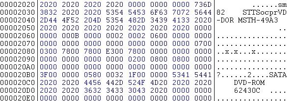

this is basically a xtreme or ixtreme samsung firmware spoofed as a benq 64930C which can already be done with fwtoolbox or a manual hex edit, let me check it out and ill post some more info later.
edit:
FWToolbox Spoof:
(IMG:http://i12.photobucket.com/albums/a246/Grim187/fwtoolboxspoofsector.jpg)
Spoof Sector from These Fw's:
(IMG:http://i12.photobucket.com/albums/a246/Grim187/TSspoofsector.jpg)
not much difference, i think this is for those of you who have the 2nd fw version, either way its really simple to change that text to what ever you want it to be so this really isn't a great accomplishment, i sure hope there aren't gonna be ppl running around thinking there's a ixtreme fw for benq now.
