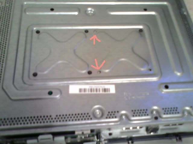

Ok guys Some pics from when I did this mod, My 360 was dead wouldn't boot. After doing this mod and applying heat it has worked perfect since..
Bear in mind I was happy to try this mod had no warranty, Didn't want to try the x-clamps first in case it didn't work after all the effort. I am personally gonna try x-clamp replacement 2 when rjbtech has an updated guide for it. This mod (penny trick) is for the in between and hey if it keeps working I may just leave it like this..
Thanks to kidderboots for the idea, Just changed it slightly..
Ok you will need
A roll of electrical tape
8 or 12 pennies depending on how much pressure you want to apply (I used 8)
Kit to open an xbox360
I was getting these freezing crashes, With a nice checkered pattern and crackling sound effect to go with it.
After a these crashes became more frequent eventually it would no longer boot up just red lights of death
So what to do is get your self some electrical tape and some pennies I used 8 pennies = 2 pennies for each replacement thermal pad for the ram
So cut the electrical tape long enough to wrap around the pennies. I wrapped 2 bits of tape around each twice
When you have your 4 replacement pads, Double up some tape i.e so its sticky both sides then attach them to your motherboard
When you have finished that re assemble your xbox360. Put back all of the screws including the gpu and cpu heatsink (x-clamp) screws and do them all up nice and tight
When you have fully re asembled your xbox360 try starting it up. If it doesnt work and you still have 3 red lights don't worry (yet). This is when you need to apply heat, I used towel trick for 18 mins.
And then hey presto its working again!

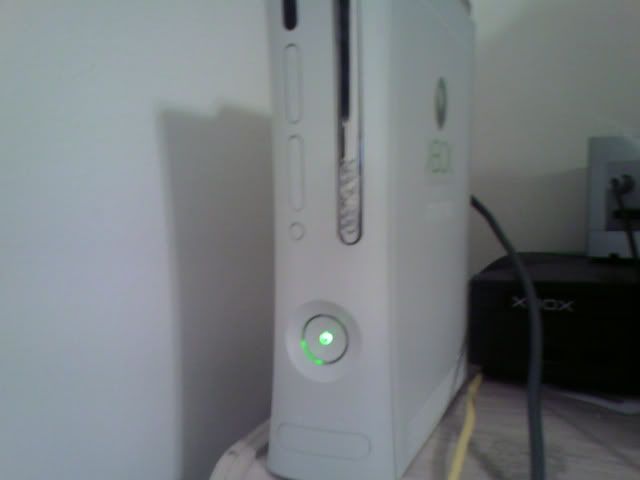

I used the penny fix,
Nothing,
Currently doing the Towel thing to see if that helps. (IMG:style_emoticons/default/happy.gif)
This post has been edited by Major Cottenham: Jun 9 2007, 11:00 AM
Ok well I've done it but the fans are really really loud and i'm getting two red lights which according to the error codes means its overheating :S
This post has been edited by Lastrite: Jun 9 2007, 04:30 PM
QUOTE(Major Cottenham @ Jun 9 2007, 10:58 AM)
Nothing,
DO NOT attempt the Towel Trick. It can only damage your console.
It seems to have corrected my previous problem, prior every second start up would result in the three red lights. Now the machine starts perfectly but as I said it's very loud and it seems that it's overheating.
Perhaps I tightened the screws too much?
yeah its possible your tightening to much. alter this method how ever you need the important part is that its working again. If this method doesnt work for you post the things you've tried previously so i can revearse the methods and see what is most harmful and detrimental to this not working. thanks
I managed to sort it out
I had to remove most of the screws to lower the tension, now the fans operate at the normal speed & during initial testing now my games work perfectly.
I believe it was probably because I used three pennies per chip whereas two would have sufficed.
So thank you kidderboots! I can confirm that this has fixed my 0020 error!
mines still up and running but fans are at max so gonna try loosening some of the screws
My 360 is still running fine not a single crash, Freeze or red light since the fix. Hope the pics helped you other guys out (This really does work) well worth doing if your warranty is shot. Can't wait for alan wake and mass effect...
By the way when I had 3 pennys on each ram chip I couldn't screw in the gpu/cpu heatsinks, The fans were really loud and fast. So I changed to just two pennies for each ram chip and it solved the problems, The fans were almost normal speeds slighlty faster than stock (I use talimoons) and I can screw all the screws back in the normal way..

The penny trick works for me, I did it last night and I have had my console on for 3 hours straight now and no problems. I used 3 pennies on each ram chip and wrapped them in electrical tape, I don't think that the pennies are really there to dissapate heat though, I think that it is more the space they provide for airflow and the pressure they put on the motherboard that does it.

Also if you cannot get the Gpu and Cpu screws back into the metal case, press down on the cpu and gpu from the top of the motherboard when you are tightening them from the bottom, also save those for last, I managed to get every screwI took out back in and every port on the 360 lines up.

Initially I had the exact same problem if you read my earlier posts . . . take all the screws out and turn it on, it should now work without overheating, then keep adding screws and testing it until it overheats then you can remove or lower the tension of the offending screw.

Its been 10 days since I did this fix, Its still running perfect
. Played colin mcrae dirt tonight for a couple hours no probs with it at all. Seems to be a stable fix will update again.

Mine is still working perfectly

great fix! The 12 pennies worked like a charm for my 360, but I had to add the black screws for the GPU and CPU for the fan to go back to normal state, with the black screws out the fan was going at full blast even after cleaning the heatsinks and using AS 5.
I had exactly the same problem the fans were running full blast with 3 pennies on each ram chip and no screws in gpu/cpu heatsinks. When i dropped down to 2 pennies for each stack I could screw all gpu/cpu screws back in teh case and the fans are at a normal state

I think i would at least screw in the 8 black heat sink screws. Maybe not tighten them more than a quarter turn once they are flush. Or AT LEAST the top two cpu heatsink screws because otherwise you are relying on just the crappy x-clamp to distribute the weight.
Got the 3 red rings last night and fixed it this morning using this method. Worked like a charm.
The biggest trick for me was setting the black screws back in. Ive tried putting them in as tight as possible, then tightening just enough that they are flush with the case and finally only two twists in and every time the fan goes full blast even on the dashboard. If I remove the screws entirely the fans seem to work as they are supposed to. Im going to keep the screws out and see what happens.

Oh now it turned on and went to the startup screen then it turned off 2 lights...I turned it off and on again and it came on to the startup screen and then it turned off agian and now it wont even turn on .. oh damn..
OH thank god it came back on and went even farther this time to the game start screen but after 1 min it shut off with 2 red lights..I have a extra fan hooked up as well so i guess ill try another screw and see if that works..but its getting farther and farther so .. it seems so close but so far away ..
Put all screws except one and now its works holy #@#$ but it works so far playing gear of war 20 min strong now .. so all so good ..
Very good to hear!! like i said in previous posts some time syou need to mess with it a little- thanks for the post
HAD... Three dead....The dead rise !!!! Great find excellent way to fix an ever so recurring problem. Like i mentioned before..HAD 3 dead one's, now all up including my X360E...Awesome...Thanx a lot. Oh... and i only had to do the towel trick on one...after doing the pennies....
26 days since I did the fix! Still works perfect, Doesn't get hot anymore temps seem totally normal. It has endured hours of the darkness, Flatout carnage and gears of war and not a single crash or lockup.
I am however getting disc read errors lol one problem after another hoping this is becausce of the media I am using to burn my games...

Shucks...spoke too soon. The Elite just went down again. No more 3 lights of doom but now no matter what game i play, around 3 minutes in, the screen decides to go black. The X360E is on and the lights are on in the console and controller. If i let it sit by itself in the dashboard for 10 minutes or so it doesnt freeze or go to a black screen.

Wait a minute here. There's something that doesn't make sense. Those black screws that you're not supposed to put back in, don't they hold down the heatsinks?
Maybe that's what's causing the overheating issues, people's heatsinks are falling off.
I'll try this tonight, but those black screws are staying in. The weight of the pennies should counteract the force of the X-Clamps anyway.

First things first. To fix the problem, you must understand the problem.
You see, the reason your xbox overheat/3rl is because of poor motherboard integrity. the xclamps on the bottom of the board causes the board to flex under heat. And with M$ slathering too much thermal compuond on(some needs to teach them how to apply TC lol) the GPU and CPU heat has a hard time transferring to the sinks. When your board flexes, vital solder points break causing loss connection between logic chips(or w/e).
The purpose behind xclamp mod was to improve the integrity between case and mobo. This helps heat transfer faster and eliminates flex. However, the procedure is a bit hard to attempt and risky.
The purpose for the penny fix is to apply a slight permanent flex to the board. Nullifing anyother flex heat might cause. This keeps the soldering in tact. So therefor the way you tighten the black screws to your GPU/CPU is vital. Also how many pennies you stack to your RAM plays an important role.
To answering your question. You have to play around with your black screws a bit. From what I read it's different for everybody. This can be very faustrating.

1. Disassemble Xbox 360.
2. Place 4 stacks of pennies, 2 pennies high, covered completly in electrical tape, should bare copper touch metal your motherboard will be fried, on each of the 4 RAM chips on the bottom of the motherboard. Should you have any of the foam on any of the RAM chips, take them off. Use hot glue to keep the pennies down, or the foam can be used as a tape as mentioned earlier in this post.
3. Begin reassembly. When you put the top back on, ensure all the screws on the bottom half are tightly screwed in. Place all the black screws in tightly as well. My recommendation is to not leave the black screws out, these hold the X-Clamps which in turn hold the GPU/CPU heatsinks in place. If they are left out, the motherboard can flex a lot and cause the 3RLOD yet again.
4. Test assembly. You should hear the fans quickly come to max, and then shut off with 2 red lights appearing. This is fine. If it works fine, go directly to step 7.
5. Remove one of the black screws from the right X-Clamp, assuming the Xbox is flipped so that the back faces you.
6. Test again. If there is no change, screw in the screw you just removed, and take the one out either above or below it. If there is a change, the fans should not gather as much speed so fast or the fans should return to normal. If the fans return to normal, you are done. If the fans still gather speed, then there is still unequal pressure on the motherboard. Locate the screw you just removed and also take out the one the X-Clamp seems to be "connecting". This should resolve your fan woes. If it doesn't, reinsert all screws, and try again using the left X-Clamp. You may have to adjust both before you come to a happy medium, or you may have to remove all screws, which I don't recommend.
7. Fully reassemble your Xbox. Test again, this time by plugging it into the TV. Heating the chips should not be necessary, but be careful if you need to. DO NOT USE TOWEL TRICK. If it should freeze, leave it frozen for approx. 30 minutes, and turn it off and let it cool for 45 minutes. Same applies for the 3RLOD. If it boots and you can shut off the Xbox using the controller but there's no video, let it heat again and see if that helps. If not, disassemble and follow steps 5 and 6 but testing with video each time. This scenario is very uncommon and it wouldn't surprise me if no one needs to follow it.
8. If all works, play for a couple of hours or so, and then let it cool for an hour, and play again. If all works, then you're all set!
Hopefully this guide will help those which the original penny fix did not resolve their 3RLOD issues.

What I did differently, kidderboots, is I left as many black screws in as possible. If you leave the black screws out, the X-Clamps no longer push up on the motherboard, and causes the pennies to do the same thing the X-Clamps did, except pull down, and put pressure on the motherboard, causing the turbocharged fan issue, which is technically a bad thing. The turbocharged fans mean the temperature sensor is malfunctioning with this extra pressure.
If you leave the black screws in, the X-Clamps push up while the pennies pull down, and the pressure is balanced out = no turbocharged fans = working sensor = no long-term motherboard damage.
The rest I just rewrote to help clarify things for some people who may not understand a lot about hardware and just want to fix their 360.

Hi guys!
I just wanted to thank kidderboots for this fix, it works great!
A few days ago my 360 started to freeze midgame while I was playing Dead Rising.
I was pretty close to the end of the game and shortly after it started freezing, it started giving me 0110 red ring of death after it froze when I tried to restart it.
So anyway, my 360 was not totally dead, but wasnt able to play anything without freezing a few minutes into the game either.
Yesterday I read about this and used 2 eurocents in tape instead of the pennies today and tried this fix.
Left out the black screws for now, and it's working very well.
Been playing Dead Rising for about 40 minutes now without a freeze and I was able to finish it! yay!

Ok, i have a bit of a problem here.
april got 0102, then did the bracket replacement that doesn't require drilling, worked for 2.5 months perfectly. Then 0102 3 rings after a few game crashes. I then opened it up again, replaced the x-clamps EXACTLY they way the 360 originally was, and tried the 12 cent fix, but used 8 pennies and cut in half the sticky pads that were already on. I also the same day applied a fresh coating of AS on both gpu and cpu. After attempts, i screwed in the 4 black screws over the gpu and none over the cpu, and i got VERY QUIET fan speeds, and a perfect xbox360 for another 3 weeks / 30 hours of play. worked even better than the bracket replacement. Then it began to do the same thing, graphic hicups, then crashes. so i took it apart, then i placed 2 more screws over the far side of the cpu from the gpu like this : : _ : It worked for another 2-3 days, and now once again, it crashed 0102. What do you guys suggest?
Janus, those screws sound really finicky for you... only advice I can give is to keep messing with them.

this is my feedback for this fix , its my friends 360 and has the 3 lights , so we tried towel trick , it came back 2 life for a momnet and back 2 the lights ...
so i decided to try this method since its easier than the xclamp method , so i used 3 coins , sticked them to each other using a glue similar to that used for fixing carpets (urgent glue) , no tape at all , removed the funny things on the rams below , and also sticked the 3 coins sets to each of the 4 rams using the same glue, fixed the heat sinks , the crazy xclamps , and started it with all 8 heatsinks screws fixed but not tightened , it worked for about 3 minutes , and thsshshsshshshs , gpu failed , ok now tightened the screwes then on , fans gets crazy and 2 lights in about 3 seconds .... so losen them again and removed all of them completly , now start , worked for about 5 minutes and failed , no 3 lights or 2 , just frozen screen , then i noticed that the front usb port is a littttle lifted so , i tried pushing it down , well it worked for 20 minutes and failed , so i used only one screw on the gpu heat sink , and tried it without pushing the usb down this time , worked , ........ for more than 2 hours , tried GOW , Forza 2 , viva piniata ........ i hope it stays like this
now the big challenge is keeping it in same position while closing it back , and also after putting the hard drive........
i will close it back later and c .........
so the good about this fix is that the 3 lights really disappeared ......

I started unscrewing certain screws in the back and discovered that when I unscrewed one of the gold screws that holds in the power adapter plug in (the gold screw NOT next to the corner (there are two screws holding in the power adapter plug in)), that the fan calmed down and no more overheating. Hope this helps anyone with this problem. (IMG:style_emoticons/default/smile.gif)

Hey squidney, I HAD that issue, but it went away when I removed one of the gold screws. Specifically one of the screws holding in the power adapter area.
Have you tried removing all the gold screws too? or were you only referring to the black screws.
Gold screw...like on the mobo?? or one of the long screws holding the case down??

(IMG:http://i9.photobucket.com/albums/a74/Soad179/mobo.jpg)
Also, to completely fix the 3RLOD, I would keep the black screws out (the ones that screw into the x-clamps) and if it still 3RLOD's after putting the pennies in, then somehow block airflow to just the gpu (the cpu has the thermostat in it). I turn my 360 off, shove a pencil through the grate in the back on the gpu fan side to jam up the gpu fan. This way the 360 thinks it is cool, but the gpu is actually getting hot enough to melt the solder under the chip.

My 360 doesn't have thermal pads, I guess because it's a launch 360. As for taking out the black screws, I don't have them anymore since I've done the X-Clamp replacement, and it would probably get fairly messy if I took out those screws. (IMG:style_emoticons/default/wink.gif)

I got it to work a little bit... Here's what I did and what would happen:
- let 360 overheat
- 360 loads up dash, no problems
- 360 loads up Burnout Paradise, freezes after roughly 3/4 minutes of gameplay
- reboot 360, freezes once it gets to main dash screen
- reboot 360, freezes once the intro video with large 360 logo plays (before dashboard)
- reboot 360, 3 red lights
So I really have no idea what else I can do... I can keep playing around with the screws but I can't figure out why it keeps freezing, as the temperatures are basically stable each time I reboot and use it again.

Happy to report that this fix has worked for me. I used 8 pennies instead of twelve and it worked first try. Just finished playing Gears for about 45 minutes. Thanks for this fix kidderboots! Now I can use whats left of my paycheck for the Iron Maiden concert in June!

I did with 16 Pennies now is work.

Ok, I've been sifting for a 2 months studying 3RLOD. I've done both X-Clamp and 12 penny fixes with 100% success. i believe both are stable fixes since they both accomplish the same goal. now for those who still have the problem after the penny fix this is what you do. adjust all the black TORX on the X-Clamps antil they're just flush with the metal casing. install the dvd, fan and shroud. put the top metal cover and hook up the machine. if you still get 3RLOD adjust all black TORX on X-Clamps clockwise 1/4 turn then check again. keep doing this until you start getting a startup followed by 2 red lights. when this happens you are close! now adjust the TORX in at 1/8 clockwise turns. do this once or twice and you'll be in buisness. this is what i've done on 6 box's so far. Another little thing you can do since the cover's are off is drill some holes through the top metal and plastic cases right where the large heatsink sits. it's easy since you'll see an outline where the sink hits the metal plate. I use 5/16 holes in an X pattern. this helps the sink release heat straight out of the case. I even used a small fan from cheap usb powered xbox cooler and glued it over where i drilled the holes. i positioned so it blew into the case like a pc intake fan. this will create serious air flow through the box which we all know it dosen't have. this also happens to be a viable fix for anyone who has 2 red light problem

Hi there. I was soooo happy, my penny tricked 360 had been working like a charm for 1 year 1 month and 6 days (since July 7th 2007) BUT... today all of a sudden all hell broke loose.
At first I noticed some weird corruption, my kids were playing Rayman Raving Rabbids and the characters had some weird dots all over them, not the whole screen only Rayman and the Rabbids.
I booted Soul Calibur IV and noticed some vertical stripes all over the screen.
I rebooted and... BAM one red light flashing (lower right) and error code 74 displayed, with secondary code 1022.
I tried removing the AV cable and reseating it but no luck.
Should I open the 360 and see if the pennies somehow moved or what?
I read somewhere that 74 has been fixed with Xclamp replacement and applying heat gun. Any news on that? I already penny tricked the 360 so I don't think I need to do the Xclamp trick. Maybe I can apply heat and re do the pennies trick?
Please help!!!

When i reassembled the xbox i tightened all the silver screws really tight, same for the black screws.
This reduced my 3rlod to a normal boot followed by the overheating/turbo fan problem (2 blinking red lights).
Supposedly this is caused by to much pressure on the mainboard/heatsensor, so loosening some of the black screws is the way to go.
In my case the solution was removing 3 of the black screws on the leftside X-clamp (CPU) on the bottom of the xbox (assuming you flip the xbox over sideways). This was a bit of a trial and error thing as i started removing the top left black screw and tried to boot. I still had the overheating problem so i removed the bottom left screw. Then it booted normally 50% of the time... almost there... so i removed the bottom right screw as well. Now my xbox is working like a charm on normal sound levels!
Keep in mind you might have to loosen different screws, but from what i have read in this thread most people had to loosen some of the black screws on the CPU x-clamp to get it to work again.
Remember: no need for Toweltricks or other overheating tricks... just play with the CPU x-clamp screws and dont give up! once you have the overheating/turbofan error you are nearly there!

Me again...sorry adding to the earlier post. I tried loosening the black screws and then the fan went out of control the I got two red rings. So I tightened the screws back up and it did the same thing. So I fiddled with the screws and got it back going. But the fan is still racing....it just keeps going faster and faster. i don't want to make the system worse. Should I take the two pennies out and try three? Thanks for your help guys

The most important thing is to fidget with the black screws to prevent the fans from spinning to fast and preventing the red rings... it can be a long battle but as this thread shows it can be done!

Son's Xbox 360 died a death last week. My other half and i had tried taking it apart and cleaning the CPU and GPU and reapply silver thermal paste and although we had it working a couple of times, within 20 mins it would switch off. Then the graphic on the screen began to have lines across it... we were about to try again when we found a post showing how to get the error code and find out exactly what was wrong.
Got the RAM error code of E20 (0110). Thought that was it and there was no hope.
Then i came across this trick on a google search. Can't believe this has thread has been running nearly 3 yrs..lol
Decided to give it ago and OMG it works.!!!!!! my son's Xbox is now worth 12p more than before and so far he has been playing for 30 mins no problem...which isn't long but is a record since the 3RROD last week.
So to KIDDERBOOTS ...
You have helped put a smile back on my sons face..
i will update over time with how long it lasts..THANK YOU SO MUCH..
