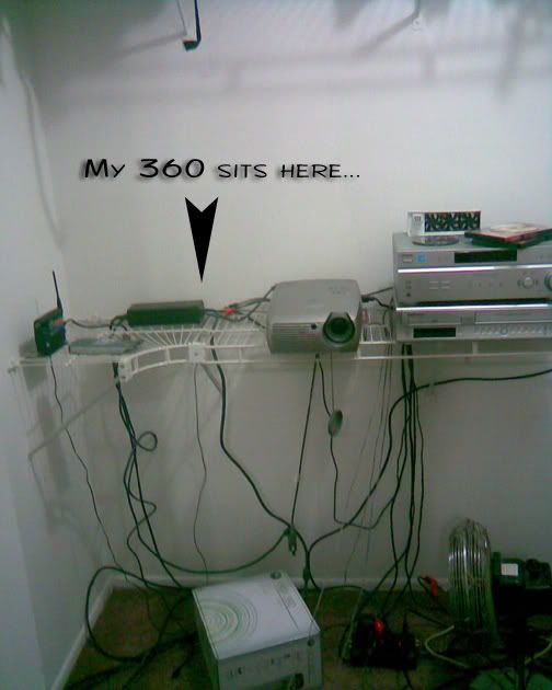

I know this has been discussed before, however, I'm getting extremly irritated by this 3 Red Flashing Lights that I'm getting. MS JUST sent me a new (Refurb) 360 on Friday. (This is my 4th X-Box) I turn it on Sunday night, and BAM, after about 20 minutes, 3 Red Lights. So, my room mate buys a 360 yesterday. We hook it up in my room (I have and HDTV InFocus Projector, it's amazing to play on) He bought the Core system, so I attached my HDD and the Intercooler, first time we turn it on I get 1 Red light, lower corner. I turn it off, then back on again, it's fine. Again, after about 20 minutes, it's got 3 Red lights. Mind you, this was a brand new 360 out of the box. (Manufacter date 6/12/05) Now he has to go return this one from GameStop and get a new one, I feel terrible. Do I have the worst luck in the world, or is this my Hard Drive/Nyko Intercooler causing this problem, or could it be my set-up? I will try to post a picture of my set up but for now I'll try to describe what I have. I have it set up in a closet in which I have a fan running at all time almost directly on the 360. The temp. difference from my closet compared to my room is at least 3-5 degrees cooler in the closet. (It is a pretty big walk in closet.) Halfway up the wall I have a wire rack in which the 360 sits, so there is plenty of ventalation above and below the 360. To the left of the 360 about 10-12 inches away I have sitting my wireless network adapter by Linksys and the 360 Power Supply. To the right of the 360, again, about 10-12 inches from the 360, I have my projector. Is there something wrong with my set up? Maybe something causing interference or could it be my HDD or Intercooler? I don't want to get a new one from MS in 2 weeks just to attach my HDD and it to start flashing on me again. MS Customer Care doesn't seem to have any answers for me, so I figured that this would be the best place to go for answers. I really appreciate any and all help that you guys could give me. Thanks alot!
Edited to insert picture.
Here is my set up:
(No, I do not have the 360 set on top of my power supply. I move that over to the left of the screen by the wireless adapter)
(IMG:http://i20.photobucket.com/albums/b248/nschoren/360SetUpcopy.jpg)
This post has been edited by ASpecialFriend: Feb 6 2007, 06:37 PM
Title: Could My Hdd Be Bad?
Post by: RDC on February 06, 2007, 12:16:00 PM
I don't see anything at all wrong with your setup, in fact having it exposed top and bottom like that on the rack is probably better for it, except maybe the back of the 360 is too close to the wall and with the Intercooler attached that would be even closer.
Ditch the Intercooler, also lay the 360 flat, horizontal, if you're not already and make sure it has room at the back for the heat to get out.
