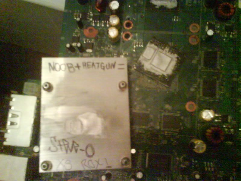

my brother in law had t 3light day and i TOLD him bout the heatgun trick but clearly stated only use it as a last resort, i pointed him to all the tuts for doing it and left him to his own will. i got a call bout 3 hours later it was him saying he thinks he did it wrong, so he gave me his board to take a look at, and as horrible as i looked at the time i PMSL, here is a pic
(IMG:http://img.photobucket.com/albums/v216/supersteve/DSC00300.jpg)
remember n00b + heatgun = disaster!!
