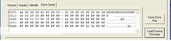

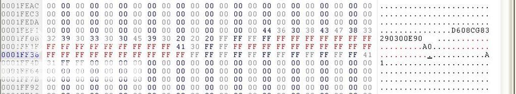

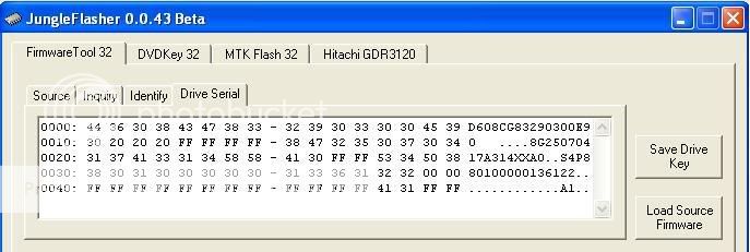

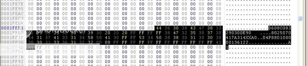

Title: Liteon Incomplete "drive Serial" (please Read All)
Post by: OggyUK on January 27, 2009, 04:18:00 AM
Ok, heres a little more visual proof.
0000: 44 36 30 38 43 47 38 33 - 32 39 30 33 30 30 45 39 D608CG83290300E9
0010: 30 20 20 20 FF FF FF FF - 38 47 32 35 30 37 30 34 0   ....8G250704
0020: 31 37 41 33 31 34 58 58 - 41 30 FF FF 53 34 50 38 17A314XXA0..S4P8
0030: 38 30 31 30 30 30 30 30 - 31 33 36 31 32 32 00 00 80100000136122..
0040: FF FF FF FF FF FF FF FF - FF FF FF FF 41 31 FF FF ............A1..
(IMG:http://i330.photobucket.com/albums/l432/OggyBST/n1222230561_292267_7458.jpg)
And
(IMG:http://i330.photobucket.com/albums/l432/OggyBST/n1222230561_292266_3592.jpg)

Quick Noob guide to identifying and repairing.
Good dummy.bin shown in JFv043b
(IMG:http://i330.photobucket.com/albums/l432/OggyBST/goodummy.jpg)
Area shown in a Hex editor
(IMG:http://i330.photobucket.com/albums/l432/OggyBST/01ff00areagood.jpg)
Same Dummy, with 01ff00 missing
(IMG:http://i330.photobucket.com/albums/l432/OggyBST/baddummy.jpg)
BAD 01ff00 area in Hex Editor
(IMG:http://i330.photobucket.com/albums/l432/OggyBST/01ff00areabadJPG.jpg)
Note the Red FF FF's
Replace with data found here
And, here
(IMG:http://i330.photobucket.com/albums/l432/OggyBST/n1222230561_292266_35922.jpg)
Simply replace these values over the red areas shown, save, then use as source

Does this serial data looks good??
0000: 44 36 30 38 43 47 38 33 - 31 38 31 36 30 30 55 58 D608CG83181600UX
0010: 31 20 20 20 FF FF FF FF - 38 47 32 31 31 36 33 32 1   ....8G211632
0020: 31 37 44 35 31 34 58 58 - 41 30 FF FF 53 34 50 38 17D514XXA0..S4P8
0030: 37 32 39 30 30 30 30 30 - 32 32 33 39 33 31 00 00 72900000223931..
Post by: Demonmirc on January 30, 2009, 02:07:00 AM
QUOTE(gaatjenixaan @ Jan 30 2009, 08:14 AM) View Post
Yes, that looks good.

Nevermind that was a stupid question but ive a new question.My drive serial looks like this
0000: 44 36 30 38 43 47 38 33 - 34 38 30 39 30 30 33 51 D608CG834809003Q
0010: 30 20 20 20 FF FF FF FF - FF FF FF FF FF FF FF FF 0   ............
0020: FF FF FF FF FF FF FF FF - 41 30 FF FF FF FF FF FF ........A0......
0030: FF FF FF FF FF FF FF FF - FF FF FF FF FF FF FF FF ................
Why dont i have the SS hiden data?
Ic you released that program 4days ago smile.gif great

The "Drive Serial" can be read from 0x1ff00 in the dummy.bin file created by the tool or directly from the target spoofed firmware, with an hex editor or using jungleflasher (load from dumped data).
A typical incomplete "Drive Serial" looks like this:
0000: 44 36 30 38 43 47 38 33 - SS SS SS SS SS SS SS SS D608CG83SSSSSSSS
0010: 31 20 20 20 FF FF FF FF - FF FF FF FF FF FF FF FF 1   ............
SS SS SS = My hidden data.
"FF FF FF ..." may be "58 58 58 ..." if the serial data is read from the target firmware prepared with firmtool 1.3.1+.
Searching for those dumps over internet i found some interesting patterns and source for intuition. So found that
a typical complete "Drive Serial" can be this (call this A0 version) :
0010: 31 20 20 20 FF FF FF FF - YY YY YY YY YY YY YY YY 1   ....YYYYYYYY
0020: YY YY YY YY YY YY 58 58 - 41 30 FF FF ZZ ZZ ZZ ZZ YYYYYYXXA0..ZZZZ
0030: ZZ ZZ ZZ ZZ ZZ ZZ ZZ ZZ - ZZ ZZ ZZ ZZ ZZ ZZ 00 00 ZZZZZZZZZZZZZZ..
or this (call this non A0 version):
0020: YY YY YY YY YY YY 58 58 - KK KK FF FF ZZ ZZ ZZ ZZ YYYYYYXX....ZZZZ
0030: ZZ ZZ ZZ ZZ ZZ ZZ ZZ ZZ - ZZ ZZ ZZ ZZ ZZ ZZ ZZ ZZ ZZZZZZZZZZZZZZZZ

OK here's my Serial information from the corrected dump from "Giampy's Dummy Fixer".
0000: 44 36 30 38 43 47 38 33 - 30 38 30 39 30 31 31 45 D608CG830809011E
0010: 30 20 20 20 FF FF FF FF - 38 47 31 35 30 31 31 31 0   ....8G150111
0020: 31 37 44 34 31 34 58 58 - 41 30 FF FF 53 34 50 38 17D414XXA0..S4P8
0030: 37 32 34 30 30 30 30 30 - 31 37 37 37 32 31 00 00 72400000177721..
Now I've compared mine to the example posted by Giampy and there is some serious issues going on with my information here. I don't understand what is causing this to happen. Jungle Flasher keeps telling me that my serial information is bad when I check by going to the "DVDKey Extract" and selecting "Get Key, Select Dummy Bin, Open as Source. Can someone please analyze this for me and post your thoughts? What do I need to do to get this drive to fire up originals, DVDs and backups?
