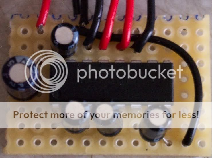

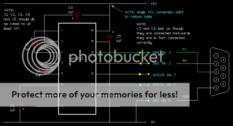

There seems to be quite a bit of confusion about the max232's. The 3232 shown on the diagram works the same as a 232 but the 232 will operate with 5v aswell as 3v. The 232 and 3232 are common place with modem hackers and are used to read/write the flash chips in them...the flash chips are 3v the same as the ones in the lite-on, so they will work just fine.
They can be built for less than £10 and a trip to a maplins store to get the parts, only very basic soldering skills are needed to build one!

I have a parts list and diagram for building the max232 if anyone needs it

Post by: fastflow on August 26, 2008, 02:20:00 PM
Anyone needing the above (max232 stuff) pm me with with email or messenger details as i cant upload it to the forum

You're better making a max233 as you don't need to use capacitors as they are already in the ic:
All you need is
1- max233a ic
2- db9 female connector
3- some wire

that adapter will work fine, you can either use the MAX232 or MAX3232 chips or any equivalent TTL converter. only difference between MAX232 and MAX3232 is the 3232 was made to work at 3.3v although the 232 will do the same it was designed to work at 5v

Do I solder 3.3v wire to v5 shown on the image?
(IMG:http://img.auctiva.com/imgdata/6/5/7/6/6/3/webimg/106146524_o.jpg)
Title: Liteon Update! Key Readable By Soldering Serial Port.
Post by: Tidyboy89 on August 28, 2008, 01:13:00 AM
QUOTE(xlinkx @ Aug 28 2008, 07:27 AM) View Post
Yes

Post by: IronSavior on September 03, 2008, 08:32:00 AM
Hello to all.
I have a few questions for you experts.
1) If you make something wrong to the construction of the RS232 to TTL converter, when you start the procedure of dumping the key can you damage the drive?
2) As i read you can construct the RS232 to TTL converter by using the MAX232 chip. As i checked the datasheets of MAX3232 and MAX232, it seems that the do the same job with the difference that the MAX232 requires 5v in order to operate whereas MAX3232 can work either by 3.3 or 5.
My question is:
If i supply the MAX232 with 5V from the PSU of my PC and not with the 3.3 of the XBOX360 controller, is their any chance to damage the drive?
3) I built an RS232 to TTL converter based on ST3232 chip. I did not manage to dump the key although i followed the guide (WITH NO CONNECTIVITY KIT) step by step. The error i was accepting from DVDKEY was the following:
c:\DVDKEY>dvdkey 9000
Port 9000
Drive Present
Wait about 20 seconds
It didn't work, sorry   reg1: 54
DVD key:
00000000000000000000000000000000
Seems NOT a good DVD Key!!! 00 00
KEY.BIN saved
I am sure that the COM communication is ok as i tested my RS232 adapter by looping the tx and rx cables to the hyper terminal. Also my port has the right setting (3F8/IRQ4).
I tried several times with a lot of different variants of the dumping procedure with no result i was taking the same error all the time.
After testing and testing i realised that i had missplaced the tx,rx cables to the RS232 adapter (to wrong RS232 pins). I corrected them and tried to dump again with the same outcome (same error as before).
The problem is that now when i turn on the 360 it starts up ok no errors on the screen but when i put either games or movies to the drive, it does not read them and then i get "Unreadable error".
Is it any chance that i destroyed my drive or just i had a laser de-calibration?
If it is the second case i will build a new converter based on the MAX3232 chip and not to the ST3232 as it seems to have differences.
Thank you all in advance, i will appreciate your help.

Post by: IronSavior on September 04, 2008, 02:37:00 AM
QUOTE(IronSavior @ Sep 3 2008, 03:32 PM) View Post
Hello to all.
My question is:
Port 9000
Drive Present
DVD key:
KEY.BIN saved
Anyone please??
Also, if you use the connectivity kit is it mandatory to join the two jumpers/solder pads for TxD and RxD on the drive?
If you use an RS232 to TTL converter MAX232 based, will the IC operate if you supply it with 3.3 volts and not with 5V?

I've just pulled a phone data cable apart and found a Sipex SP237ACT, this seems to be practically the same as a max3232 only with more inputs/outputs, I've found the data sheet for it and it has all the same connectors so would I be right in thinking I can use this in place of the max3232?
Soldering iron is heating for the start of the operation!!

Post by: Tron[ADS] on September 07, 2008, 05:43:00 PM
Be aware if you have purchased this serial adapter off ebay :
http://cgi.ebay.co.uk/MAX3232-RS232-to-TTL...p3286.m63.l1177
Mine has the TX and TX pins incorrectly labeled. If you are struggling with it, and keep getting 0's for a key, have a check that TX goes to pin 11 and Rx goes to pin 12. Mine didnt, and on inspection I figured I must have made a soldering error on the 2 wires, but found I hadnt. It was as simple as swapping them round.
So if you have one of the adaptors above, KIV that it may be the same for you.

It's pretty common that you'd have to connect the device's transmit (tx) to an adapter's receive (rx) and device's receive (rx) to the adapter's transmit (rx). Sometimes pre-made devices have them labeled to the serial port, sometimes they have them labeled to the device being hooked up - an annoyance that requires one to know their hardware.

I'm trying to fault find the Max2323 that I've got while I wait for the new one. Can anyone PLEASE confirm that there should be connectivity between the pins 14 and 11 on the diagram below. I get a connection between pins 11,12 and 13 when rx/tx are shorted. It seems pin 14 has no connectivity to any any other legs on the MAX2323 except legs 6 and 7, which I think are grounded on my MAX2323 dongle. But by looking at the diagram there should definitely be a connection between legs 14 and 11.
It would give me a lot of piece of mind knowing all my problems are due to the faulty MAX2323 chip itself.
(IMG:http://i67.photobucket.com/albums/h296/a1133973/400px-Xbox_360_lite-on_rs232_build.png)

Post by: XPunked on September 18, 2008, 06:52:00 AM
Could someone PLEASE spare 3min of their time to pull out their multimeter and report back on the resistance reading between legs 14 and 11 on a working MAX3232 chip, it would be very helpful to me. I am desperate to know this.

Post by: ILikeMeat on September 18, 2008, 02:50:00 PM
I really don't think they should be connected. Don't know, but really don't think they should.
Post by: buddy6 on September 22, 2008, 09:56:00 AM
This is what I am building now just to try it got all parts from maplin except the serial connector for £4.50
(IMG:http://i409.photobucket.com/albums/pp176/buddy6_photos/max232.png)
Post by: cribbo85 on September 22, 2008, 11:52:00 AM
QUOTE(buddy6 @ Sep 22 2008, 04:56 PM) *
you might aswell shoot me in the head ,way out of my league mate

This is The rs232 that I said I was going to build all the parts from maplin cost about £4.50 got 5 Volts from power supply on computer the red wire 5 + volt  black for ground ,took abot 1 hour to build works a treat
just need to add a serial connector  I put  little plugs on my rx tx and ground wires and plugged them into the back of my computer serial port works ok but need to do a proper job hope this helps somebody
FD92A   MAX232CPE            1 off
VH03D   Minelect 1uF 63V     5 off
some stripboard
(IMG:http://i409.photobucket.com/albums/pp176/buddy6_photos/max232-1.jpg)

Post by: buddy6 on October 02, 2008, 01:17:00 PM
QUOTE(X-hacker @ Oct 2 2008, 02:36 AM) *
I know this might sound stupid and forgive me if I'm wrong...
This is one diagram I have used to build the device...
(IMG:http://img379.imageshack.us/img379/1039/liteonrs232buildzg2.png)
I have a few card programmers which I've nicked the parts from. I've built the device, but I cannot get it to work with my Liteon...
The only component different I am using is the actual IC, I am using a ST232CN instead of a MAX232...
I checked the datasheets, and the only difference I can see is that the ST232 uses 5v but is the EXACT same pinout as the MAX232.
Here's one on ebay...
http://cgi.ebay.co.uk/ST232CN-Line-Driver-...id=p3286.c0.m14
All I get from Realterm is '00' and thats it. I'm using a 5v DC adaptor, but like I said, only the IC is different to the one specified. Should I just bite the bullet and go get a MAX232 from Maplins?
Can anyone advise on this?
looks a but different to me
(IMG:http://i409.photobucket.com/albums/pp176/buddy6_photos/NewPicture.jpg)

Post by: Vauxfan on October 02, 2008, 03:14:00 PM
Can someone confirm which way round the capacator goes between pins 15 and 16?
Thanks.

Post by: buddy6 on October 02, 2008, 04:13:00 PM
QUOTE(Vauxfan @ Oct 2 2008, 10:14 PM) *
Thanks.
(IMG:http://i409.photobucket.com/albums/pp176/buddy6_photos/NewPicture1.jpg)
max3232
This post has been edited by buddy6: Oct 2 2008, 11:16 PM

Post by: Vauxfan on October 02, 2008, 04:56:00 PM
Thanks, for some reason I made my 1st dongle wrong, I have just redone it while I asked my question and had turned the capacator round.
Hopefully When I retest, it will work.
Post by: Vauxfan on October 02, 2008, 08:36:00 PM
I have my key!
Thanks to Geremia and everyone else involved, I now have a nice flashed Benq, much quieter than the liteon.
Also, thanks buddy for confirming the capacator was the wrong way round, I also changed my capacators to 1uf, worked flawlessly.
I might give away my Dongle to someone else that needs it since I can confirm it works 100% just needs tidying up as its just 5 caps soldered directly to the max chip LOL.

Post by: Jadgamez on February 03, 2020, 10:05:00 AM
Yes i have. I have two RS3232 Chips as i have two devices. I have atteched some pics. This is really bugging me as i have no clue what to try next.
http://img337.imageshack.us/my.php?image=screenyf5.jpg
http://img337.imageshack.us/my.php?image=devicevt0.jpg
http://img337.imageshack.us/my.php?image=setuptw8.jpg

Post by: Jadgamez on February 03, 2020, 12:02:00 PM
Update: Moved from the 3.3V supply to 5v supply and am now getting full loopback. COM1 port is 100% working now. And i am 100% certain my device is working too. When i connect Rx & Tx to Liteon i still get all C's for the keys  (IMG:style_emoticons/default/sad.gif)
Compleatly run out of things do now.
(IMG:http://img72.imageshack.us/img72/314/loopbackst3.th.jpg)

I'm pretty good at soldering but I can't read these schematics. Can anyone post a simple version? Thanks

I Build my own converter from scratch with a max3232. Loopback is fully
funktional, in realterm and with hyperterminal. But i get only CC CC CC..... as key.
Im sure my Converter works, but when i Solder it to the drive i dont get the "01010101"
with realterm. Here are my questions:
1.: Does the drive always give "01010101", no matter if the tray is open or closed?
2.: Is there any known source for working converters in Germany?
3.: Should i build up a new circuit even if loopback works?
Thanks in advance!

Post by: DOGZ BOLLAX on November 26, 2008, 05:04:00 AM
After Reading What i can in this thread. Is it possible to just use a Serial Plug with TX & RX wires to the liteon TX & RX, then use a ground and 3.3v elsewere 2 the liteon?
Thxs
Dogz
Post by: zita212 on November 26, 2008, 08:07:00 AM
QUOTE(DOGZ BOLLAX @ Nov 26 2008, 01:04 PM) View Post
Thxs
Dogz
Not possible. RS232 from your serial plug outputs ones as +12V and zeroes as -12V levels. The Liteon uses 0v for a zero and 3.3V for a one.

Post by: Kurt Hectic on November 26, 2008, 08:44:00 AM
Some conclusions:
1. Paperclip method doesn't work for me when cutting power when tray closes... but this works:
- power on xbox360
- eject tray
- close tray
- pull the power cable for dvd off the xbox 360 motherboard
- now use the paperclip to pull off the tray
- plug the power for dvd back into the motherboard
- start PC and read the key.
2. When using VIA 6421A sata cable can be plugged into liteon all the time smile.gif
3. Dongle build on Sipex SP3232ECP istead of Maxim 3232   works as well. smile.gif Just do NOT switch the Rx and Tx. I read so many posts here telling to switch it, that I did it when trying for the first time. In my case it should be exactly as on the picture. Tx-Tx, Rx-Rx, not Tx-Rx, Rx-Tx
I also had to connect it to a PC without a cable. Just stick the 3232 dongle into COM1 port. Using null-modem cable and gender-changer doesn't work - which is odd, because I see this method on some of the tutorial pics and I've got "connect the device through 9pin RS-232 null-modem cable" in the manual of... there you go. They sent my a manual for Maxim 3232 with dongle built on SP3232ECP. tongue.gif
4. After hours of searching on the net I can share some advices based on other people posts:
if it doesn't work - try to:
- change the power. Some guys couldn't do it unless changing from 3.3V to 5V (of course if your 3232 dongle supports 5V ) or just using 3x AA 1.5V batteries which equals 4.5V.
- the COM port might be the problem. Some guys had to connect some points on the motherboard port COM in order to make it work - or just use another computer.
Hope it helps someone in the future.
Now I just have to learn what to do with a brand new (manuf. XI-2006) Samsung MS28 and "The End"  biggrin.gif
(do I have to read it first or just take ixtreme1.4.bin from xbins and inject there a key and spoof info? )

I maked a rs232 converter following the schematics on this forum but i can't find max3232 in the store, only max232. Can I use it ?? Thanks
Post by: neocon on December 03, 2008, 07:08:00 AM
QUOTE(defrag86 @ Dec 3 2008, 11:55 PM) View Post
Yes, just supply it 5v and not 3.3v, see  http://forums.xbox-s...o...59565&st=60
Post by: defrag86 on December 03, 2008, 08:21:00 AM
QUOTE(neocon @ Dec 3 2008, 03:44 PM) View Post
Ah ok! But in the tread you linked me they say of solder the 3.3v wire (I think the wire with the supply voltage) to the V5 pad of the image not to solder it with a 5v wire...  uhh.gif  uhh.gif
Post by: yaywoop on December 03, 2008, 08:24:00 AM
QUOTE(defrag86 @ Dec 4 2008, 02:57 AM) View Post
the 5V pad is just to the right of the 3V pad. see this image if your not sure  http://i197.photobuc...oop/360/sch.png
Post by: defrag86 on December 03, 2008, 09:17:00 AM
QUOTE(yaywoop @ Dec 3 2008, 05:00 PM) *
the 5V pad is just to the right of the 3V pad. see this image if your not sure  http://i197.photobucket.com/albums/aa189/yaywoop/360/sch.png
Thanks! I think of supply the converter from the psu of my computer because I'm not a good solderer
