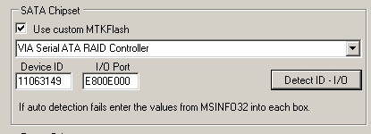

We need to setup Xtreme Boot Maker.You can find it in the Start Menu>X-Projects.Run the program.
(IMG:http://img411.imageshack.us/img411/3241/bootmakerar9.jpg)
1-- Open your xtreme firmware(here i used 3.3 .The latest one is extreme 5.0 but i find v3.3 is good enough)
2-- Click "Use Custom Mtkflash and choose your sata controller.
3-- Hit "Detect ID -I/O"
4-- Click "Ms28 Bad Flash Compatibility" and "Apply Boke's Patch For Ms28 Drives"
5-- Choose your usb memory stick or floppy ( I recommend USB stick since floppy is not so stable everytime.It may come up with a bad sector and that may cause a bad flash.USB Stick is much less riskier)
6-- Click "Format and Make Bootable"
7-- Hit "Prepare Drive" .In about 10 seconds your usb stick or floppy is ready.

Here is a screen shot of a few of the settings:
I have not tried editing mtkflash separately as I seem to have a few problems grasping the fundamentals of this process  unsure.gif ……therefore any help would be greatly appreciated and all the best for 2007!

@CaPtBlaCk is your card raid version of 6421? If so find a way to disable raid.
Turn pc on , boot into dos , turn 360 on , type mtkflash r /m orig.bin ,options come up , turn off 360 , choose the corresponding option , wait around 10 sec , turn 360 on . You can try different timing too.

yes, it's how i do.I'm using a simple via6421a sata card for it. I'm not using those crock clips because i have a long sata cable and 360 and pc don't touch each other.I'm using a thick book to put 360 on. You need to be careful about it.I empty everthing on my table(especially metal ones) and i don't touch 360 during the whole process.I only use power button to turn it on&off.

- No special trick but just perseverance with the 10sec method using VIA6421 chipset SATA...
- The procedure used was the same as 10sec method, but changed the timing slightly
- It worked when I power on the xbox360 DVD and simultaneously hit the keyboard to select VIA6421 port
- Had to try many times (>20) to get it wok but it paid off

Did you follow the tutorial? Did you setup drivers for via card ? You need to turn 360 on after booting into DOS.Did xtreme boot maker find your card ?

@VerbatimDL24X  Boke's patch is about plugging a mtklash compatible ide drives.Before boke's edited mtkflash,we needed to have a mtkflash compatible ide drive and it's not needed anymore.However, there are some problem with even 6421 sata cards and it might be an option to have or not.

you need the xtreme boot maker to detect your sata address otherwise, it simply wont work

Please help i'm stuck. I'm trying to flash my ms28 and i've got to where I type in mtkflash r /m orig.bin choose my drive. I get prompted with 4 options
1: Xtreme Pri Master
2: Xtreme Pri Slave
3: NV nForce3 Pri Master
4: NV nForce3 Pri Slave
No matter which one I choose it gets stuck at Port: 9f0, Master/Slave: a0. There is a 10 second waiting rule that I need to follow. Please advice. thanks.
I have an ECS nForce3-A with onboard SATA chipset.

btw .. just saw ur post d70 , do you have a via pci sata card ? you won't be able to flash ur drive with the nforce chipset , cheers

@d70 gestach is right.Just look up the previous posts where i gave the link for that card.

So to flash a Samsung drive with ms28 firmware, I need to have a VIA VT6421L or A card period, correct? Tutorials always say compatible SATA chipsets and stuff and I thought my nForce 3 onboard SATA was compatible but turned out false. Can someobdy explain this?
Anyway, moving forward, I'm getting http://www.newegg.com/Product/Product.asp?Item=N82E16815124023 from Newegg. It's a raid card. gestahl, is this the card you have? If so, could you let me know you tweaked it to work? Thanks.
Title: Step By Step Tutorial On How To Flash Ms25&ms28
Post by: myfranco on January 26, 2007, 01:27:00 PM
Anyway, moving forward, I'm getting this card from Newegg. It's a raid card. gestahl, is this the card you have? If so, could you let me know you tweaked it to work? Thanks.
Your sata controller is fully compatible with ms25 but not with ms28.The card you're buying is a raid card.It works with ms28 but you need to disable raid.I'm sure you can see how to disable raid in its manual.If you can find the same card without raid go for it.

Would that MB work with MS25? It does say "Chipset Type VIA UniChrome Pro K8M800 / VIA VT8237R"
And that's VIA, but i am confused, any help would be apreciated.
edit: yea, and xtreme boot maker doesnt say sata, it just say VIA VT8237R RAID controller, and some other things.
Do i need another OS? Becouse i am running Vista, if thats any problem.
Post by: myfranco on January 28, 2007, 03:31:00 PM
I haven't setup vista ,i have Xp.I don't know if it works with vista.However,that card -as far as i know- works with ms25. It's via8237 chipset which is compatible.You need to disable raid from bios menu though.
Post by: tension on February 14, 2007, 05:28:00 AM
I've read through all the posts in this thread and I've been reading tutorials and watching videos all day, I think the tutorial in this thread sounds the easiest to do.
I know my drive is a Samsung but I havn't opened it up yet so I don't know if its a MS25 or MS28.
I took a screenshot of Xtreme Boot Maker and I was wondering since my onboard SATA has been detected if it would work with a MS28 drive ?  If not I will go and buy a VIA card.
Note that I am using Xtreme Boot Maker v0.5.0.0 because I tried V0.3.6.14220 and when I try to load the firmware it wouldn't load and I get an "unknown firmware" error.
Also one last noobie question, which option of the Xtreme Firmware is most common ? A,B,C or D ? From reading Textbook's PDF file I would of went with option A but from what I've been reading options B and C seem more common.
Post by: myfranco on February 14, 2007, 06:41:00 PM
@fulltimes420 i think he made an error. It would be nice to see ms28 flashed via another chipset but there are lots of people with that chipset and it would be known longtime ago.However,if that's true,it makes ppl happy.
@tension 0.36 is giving that error,there is nothing to worry. I believe ichx are good to go if it's ms25.
Post by: DuBob4432 on February 20, 2007, 11:49:00 PM
just a quick question, after setting it all up and booting from the usb device, i get the choices of ide pri slave, ide sec master and xtreme pri master.
shouldn't i be seeing the via chipset in the options?  i have read pretty much this whole tutorial but i may have missed something.
i have tried 2 known working 6421A cards, both ports and at this point this is where i am at.  i have xtreme boot maker 3.6.x and am going to be flashing to 5.2d. hopefully.
i have unplugged all other drives on this machine and still get the same results.  i have followed the many videos correctly with starting the 360 when i see the dos prompt or even right as i start up the machine with the exact same results.
i tried to try it on another machine but errored out when looking for the i/o addresses, and yes i have the most current versions of .net (both 1.1 and 2.x) and have tried it running both win2kpro and xp pro.

Post by: DuBob4432 on February 21, 2007, 01:14:00 AM
QUOTE(DuBob4432 @ Feb 20 2007, 11:20 PM) *
UPDATE - just to see what would happen i selected the XTREME pri master option and low and behold it worked (actually i had a floppy in the drive for testing and i hit the 3 and it started to read the firmware without the 10sec trick, it just read it to my surprise, then i did it the "correct" way with a usb drive - don't want to flash from a floppy if i don't have too.  i also used the /sata switch too just to make sure.  i don't know if i missed this in all the reading but am glad i tried it out.  and i have tested it to work with both backups and orginals, both of which seem to boot at the same speed smile.gif
i really hope this helps somebody out as it took me nearly 3hrs to figure it out....
Post by: myfranco on February 21, 2007, 06:18:00 AM
Good you made it worked. xtreme pri master is the sata controller where 360 is plugged.Anyway,you figured that out No prob smile.gif

So tried on motherboard #2 which is MSI K8N NEO3-F NFORCE4. the drive shows up in bios.. Disconnected ./disabled all ide channels drive hooked up to sata 1. followed the guide  used xtreme boot maker 3.6.14220
chipset : NVIDIA nForce4 Serial ATA Controller
Device Id: 10DE0054 I/O port : 09F00970
Same error it just hangs doing nothing, get "error 00 should be 70". i am stumped and out of ideas I tried diffrent timing, waiting 20 seconds even a minute etc etc. Throwing in the towel for today..
it wil not read the firmware! Any solutions with getting these chipsets to work? (other than buying another card and vcc)

No way.You have to buy via 6421 sata card or a motherboard with via8237 or vcc trick.

I beleive thats the compatibility list for MS25 flashing.  MS28 NEEDS the VIA6421 chipset.  I just ordered http://www.newegg.com/Product/Product.asp?Item=N82E16816132009 from Newegg, and in the reviews nearly every other person says "used to flash my 360."

Ok VCC switch got me as far as error 80 should be 70 on the nforce 4 sata ..which is progress I suppose. But beyond frustrating right now. This should now work no..is it timing issues still with vcc?
I boot with xbox on first, the drive detects..i d othe mktflash r /m orig.bin
it detects my sata chans..and then i flip the switch and press enter
and it still just hangs
except that instead of 00 shoudl be 70 like before I get 80 should be 70
Okay tested on the sis 964 get the same results..
it detects the sis 964 chipset..switch the vcc to off..press enter wait a lil and switch on...it keeps hangign there
escape out and now it also says
port: ac00 master/slave: a0
Status=80, should be 70
ERR: user break
What am I doing wrong?

@johnny666x are you sure your mainboard drivers are setup correctly?
Post by: johnny666x on March 05, 2007, 01:04:00 PM
actually i got that fixed - msinfo32 was not installed on my pc. go figure

Xtreme Bootmaker... I couldn't get it to detect my I/O ports, and I tried hundreds of times.  I launched MSINFO32, and then hit detect, and it came up each time that was open....
I had to start the PC, 360 DVD plugged in and powered on, otherwise DOS/PC would hang (and constantly beep) if I turned the xbox on after the PC was powered on.  It would beep after the flash as well
10 seconds trick....  more like .10 seconds.  I'd select the # corresponding to the sata card, and I'd have to hit the power on button right away (1 hand on the keyboard, the other hand on power button for the 360)

You haven't read properly then.You can't flash ms28 with ich5.You need to buy via 6421 sata card for it.Read the previous posts and you'll see plenty of links to via 6421

nevermind lol, i never knew the XTREME Primary Port was the drive lol, i thought it was my disk drive for some reason.  anyway works perfect, nice tutorial
Post by: myfranco on April 03, 2007, 06:07:00 PM
@Sha what are the options you see when you type mtkflash r /m orig.bin .It must be Xtreme primary master(slave)

when I click on the use custom controller.   should I then select standard dual pci ide controller?
the mb has via vt8237 chipset.
thank you for your help and hard work on this tutorial
I'm still using 0.3.6 and i think you need to open a firmware first.There must be a via controller tab to select.
If you want ,you can add these two screenshots and we can decide what to do

when I typed the mtkflash command, I got 2 options.  extreme controller and via vt8237.  I chose the first 1.  It read my firmware.    then back to windows to use xbox firmware toolbox ver2.0.   extracted my key. backed it up. wrote it down. emailed it etc.   then opened the 5.3 firmware and pasted and replaced the key.   flashed my ms28 drive and it said it was done sucessfully.

You need to setup its drivers and use the interior port of via 6421.Ms28 is firmware locked and you can unlock it by:
-mtkflash r /m orig.bin   enter
-Before chooisng extreme primary or secondary master turn 360 off
-Make your selection
-Wait 10 sec and tur 360 on.
you do the same for flashing too.This is called "10 sec trick"
It can be different timing sometime such as ~12-15-18 sec.
