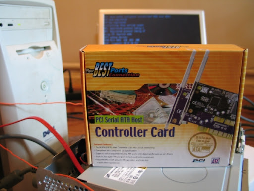

Lite-On SOHW 832s
Asus a87nx-e deluxe
SiL 3112 pci sata card
Memorex DVD + DL Media bought from Best Buy
Works perfect!

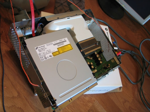

Post by: SAPHiREX on August 05, 2006, 12:32:00 AM
Update: Finally flashed my 360!
(Please see page 15 for previous details)

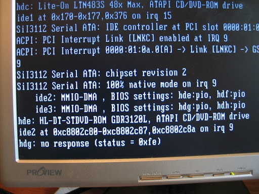

Motherboard: OLD AZ dell computer very nice and simple.
PCI SATA Card: SIL3112 (Listing has pictures
Silicon Image Sil3112 2-Port Serial ATA PCI Controller) IT WORKS VERY WELL 1st TRY the VT6421L did not work at all. (I waited 2 weeks and will never do anything, but slax method!) $400 brick is so heavy, we have so much of them here @ xs we can make a 4 story building.
Burner: (on my other complex pc): Pioneer DVR-111D Firmware 1.23 Stock.

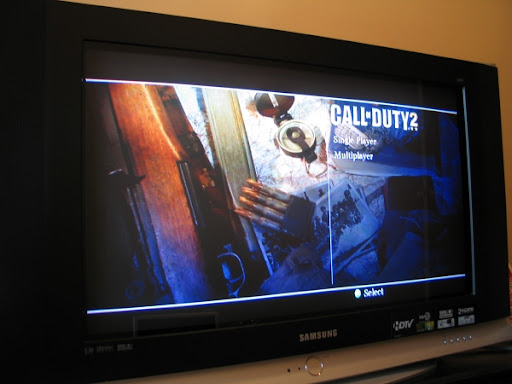

Xbox Drive: Hitachi 47DJ baby!! Boot everything without tricks or magic. Feels like a dreamcast.
Media: Verbatim of course (10@ $12 at newegg.com)
Success Rate: 100%
Success Rate: 100%
Check it out.
(IMG:http://lh4.google.com/SAPHiREX/RNROyse5ABI/AAAAAAAAAAU/Jd_MZf3n5AM/lg_IMG_4592.jpg)
(IMG:http://lh3.google.com/SAPHiREX/RNROy11HABI/AAAAAAAAAAc/6H8ZKn6mSiU/lg_IMG_4593.jpg)
(IMG:http://lh5.google.com/SAPHiREX/RNROzTaLABI/AAAAAAAAAAk/TvETlngWjV0/lg_IMG_4590.jpg)
(IMG:http://lh4.google.com/SAPHiREX/RNRO0XrKABI/AAAAAAAAAA8/pdANslYYCAQ/lg_IMG_4597.jpg)
(IMG:http://lh5.google.com/SAPHiREX/RNRO1rBWABI/AAAAAAAAABU/8KF68cHeE6E/lg_IMG_4596.jpg)
Ye-Yea!

CAn you give me a link to that SATA card? thanks and did you need a modifiled mtkflasher for it, if so please upload and give us linky.
and where is that 10 for $12 deal i cant find it on new egg.

kind of late reply...but i dont check the forum often after i flashed (IMG:style_emoticons/default/unsure.gif)  (IMG:style_emoticons/default/tongue.gif)  (IMG:style_emoticons/default/laugh.gif)
anyway i got the sata card from ebay, used buy it now for a few bux.
There is a MUCH BETTER DEAL GOING ON AT NEWEGG FOR SOME VERB>DL
http://www.newegg.com/Product/Product.asp?...N82E16817130008
$1 for each dvd after MR. and you get a cd/dvd kit and free shipping. NEWEGG is the sheeet!!! (IMG:style_emoticons/default/laugh.gif)

Post by: BuckeyeNUT on August 17, 2006, 04:12:00 PM
SATA PCI Card: SIL 3112 ($22 shipped from geeks.com  (IMG:style_emoticons/default/biggrin.gif) )
DVD Drive: Hitachi 47dj
Burner: Pioneer 111d (DB 1.23 firmware)
Slax Boot Cd worked perfect first time!
Burned two coasters before the pioneer arrived at the house, but the first burn with the 111d worked like a charm. No soft reset needed. Using Memorex media...
OPA 7in1 v2_1
Thanks Gary!

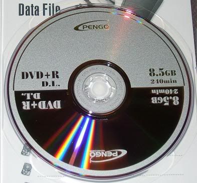

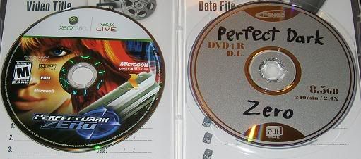

I started out using Pengo discs, and they worked fine.
Pengo Box:
Working Pengo Disc (Original is there so I don't get banned for Piracy):
Later, I went back to buy some more Pengos. They had the same box, but the discs looked different. It turns out that my Xbox360 can read the first layer fine, but can't read the second layer. I was half way through a game, when it just froze up on me. After killing another disc, and trying to rip the backups, I found that it couldn't read the second layer! So heres a picture of the BAD Pengo discs. Remeber: the boxes look exactly the same.
BAD Pengo Disc:
I then had to switch to Ritek, which are working fine (plus they are on sale - 5 for 1,580 yen!).
Ritek Box and Disc:
Conclusion: I wouldn't risk buying any Pengo DVD+DLs, because you can't really tell if your getting a working disc until you open the packaging.

Pci Card: Silicon Image SIL3112A
Mode B: With slax CD
Drive model: Hitachi 59
Firmware: OPA 2.1
Burner: Pioneer DVR-111D ( 1.19 firm)
Media: Verbatim 8x dvd+r
I had problem with flashing and slow booting windows. Ejecting the drive while booting to windows fixed the problem.
