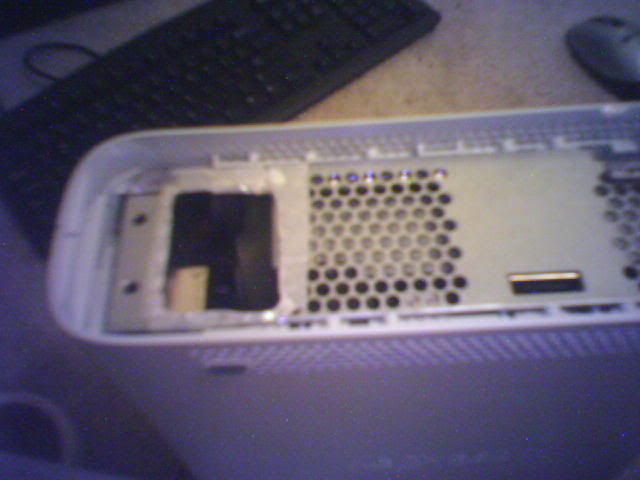

Post by: Theta on May 17, 2006, 11:21:00 PM
Pic 1
Pic 2
Pic 3
Female to Male Extender, Right angle SATA cable...
Tight fit, NO drilling.
Works great!
Hope this gives you all more ideas!

I built my own sata extender by cutting a broken PCI network card pins (whose pin width is exactly the same as sata) and pushing it into the male connector.
But then I realised I cant get the plugs out of the 360 case without bending the USB/LAN port so I dropped this idea. Would be great but I cant see how I could get the cables through without violently bending the case.

Hey Theta, One quick question. How did you manage to get the wire through the back where the RJ-45 connection is at without breaking it? I can't seem to get it through the back.

Post by: uk_dan2k on June 22, 2006, 07:43:00 AM
QUOTE(Joergen @ May 18 2006, 04:24 PM) View Post
QUOTE(vnwiseman @ May 28 2006, 07:16 PM)
I thought i had the same problem, but i unscrewed everything to take the motherboard out and fans etc, so that your just left with the empty bottom case. Then i put the cables through the usb/ethernet hole on the case and bent them 2 springy metal pins at the top of the usb/ethernet little box and put the motherboard back in. It was a bit of a squeese but it all went in fine and works biggrin.gif

Post by: Topho on September 16, 2006, 07:02:00 PM
How do I go about getting the Sata cables out the back of the Xbox 360 via the USB Port without cutting anything?Do I open up the USB/Eth Box? How do I do it? Do I bend something? A picture would be awesome.
The original pictures are gone and Loto_Bak's pictures don't show the inside of the case.....Please...help me... Thx.

Post by: johnyb62 on November 04, 2006, 07:03:00 AM
Thanks for the advice on this forum. For UK owners, here's how I did it.
(1) Purchased sata backplate via enay
SATA BACKPLATE
(2) Used tin snips to cut hole into inter mesh
(3) Unscrewed one of the two sata connectors from the backplate
(4) plugged one end into the back of the xbos dvd drive, and used a glue gun to stick the other end on top of the network port casing.  I did this at a sligh angle to ease access in future.
Once reassembed looks like the first image:-
Pictures
So the cable that usualy plugs into the back of the DVD drive (from the xbox motherboard, simply plugs into here...(2nd image)
The lead from the PC motherboard can now be plugged straight into the female socket for firmware upgrades.

Post by: STICKY_BUD on November 14, 2006, 06:10:00 PM
if you cut the space in the right area you can screw the extension right into place and make it easy on yourself
i use some electrical tape to avoid a ground connection from the cage to the female sata port
i suggest using this method for FW upgrades, but you should also be able to use it for making backups - the samsung d162c is so much easier though

Would it be a good idea to get this
(IMG:http://img25.imageshack.us/img25/7724/xsjinn.jpg)
I'm trying to make it as easy as possible for me to flash my drive and a few of my friends drives
Title: Sata Cable Extension / Split - No More Opening Case!
Post by: fahrenheit on March 18, 2009, 11:25:00 PM
QUOTE(jinn @ Mar 18 2009, 04:05 PM) *
No. eSATA is not what you want.
