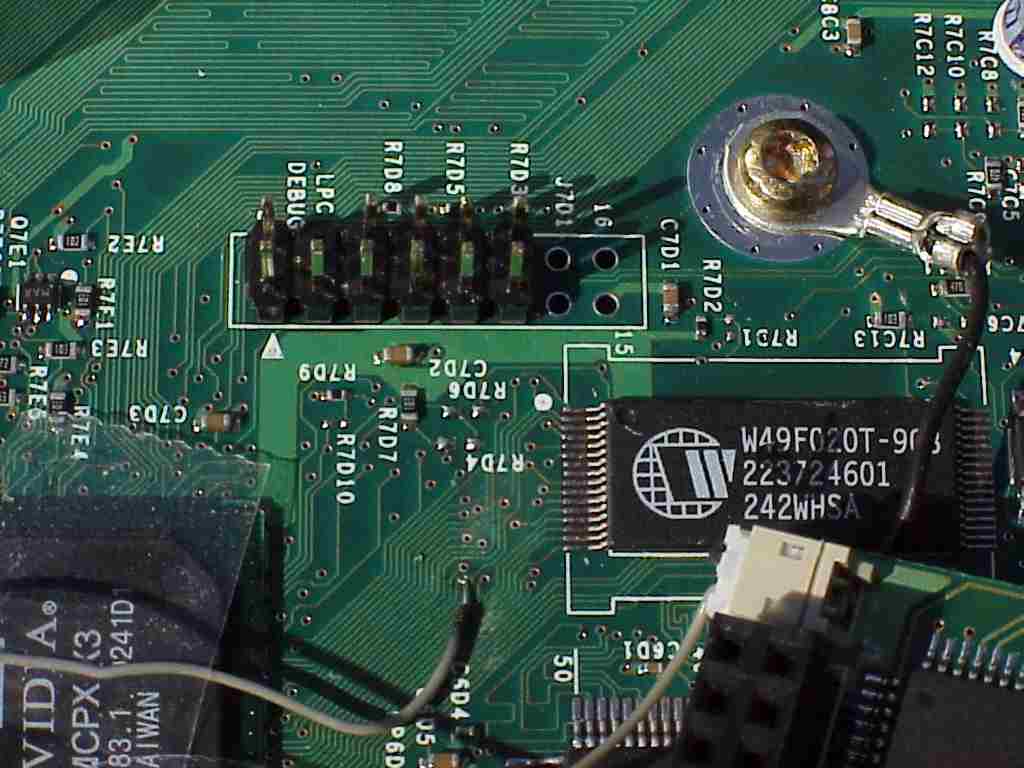

Has anyone had any sucess installing the X-Ecuter II lite in the New XBox Ver. 1.2 yet? Or anyother Mod's.
If you have, please post with your results and how you dit it.

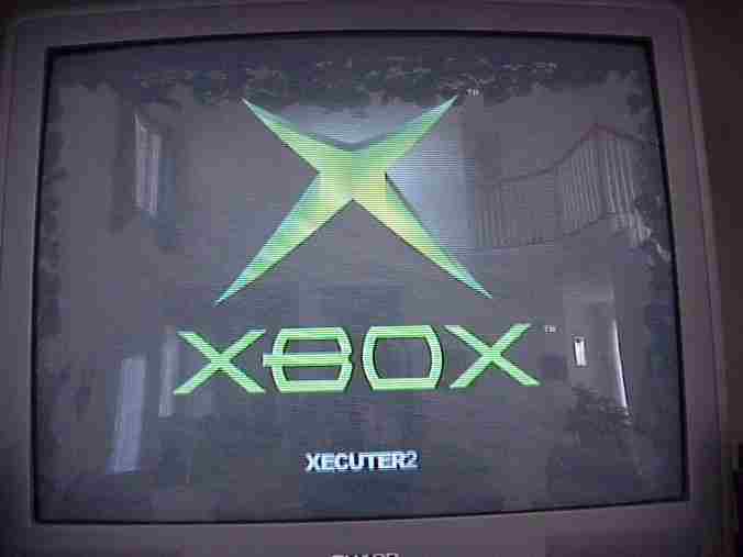

OK This is how far I got with this install. I hope someone else can help with getting this thing going.
I Installed the X-Ecuter II lite in the XBox v1.2 using the v1.1 steps and the d0 that was shown in another post (the small grayed dot.)
I booted the machine with the original HDD and it showed the X-Ecuter II where the MS logo was.
I booted again using my customized Slayer's automated installer DVD, everything looked normal.
I removed the original HDD and installed a Maxtor 120 gig. (Making sure the jumper was in the right place) and rebooted the machine again. This time I got an error 06.
I removed the 120 giger and installed a different but original untouched HDD and rebooted then got the error 06 again.
I removed the HDD mentioned above and reinstalled the original (the one that came in this XBox and rebooted again with my customized Slayer's again and all seemed normal again.
OK this is all I know, can anybody help me from here.

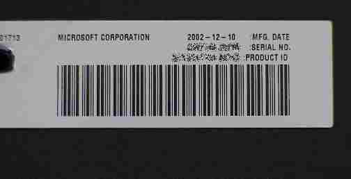

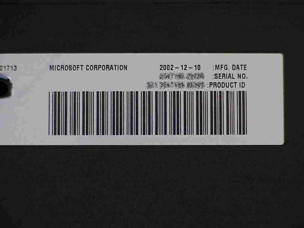

If you do have the progress you've stated so far, PLEASE get us confirmation in the form of digital pics of your system with the mod installed.
IF you are being truthful (once bitten, twice shy), it sounds as though everything is perfectly normal. Installing a hard drive will illicit an error, merely becuase it hasn't been formatted.

The first three are clickable to larger versions.
These were posted by IBNewB over in the Team Xecutor forums.
