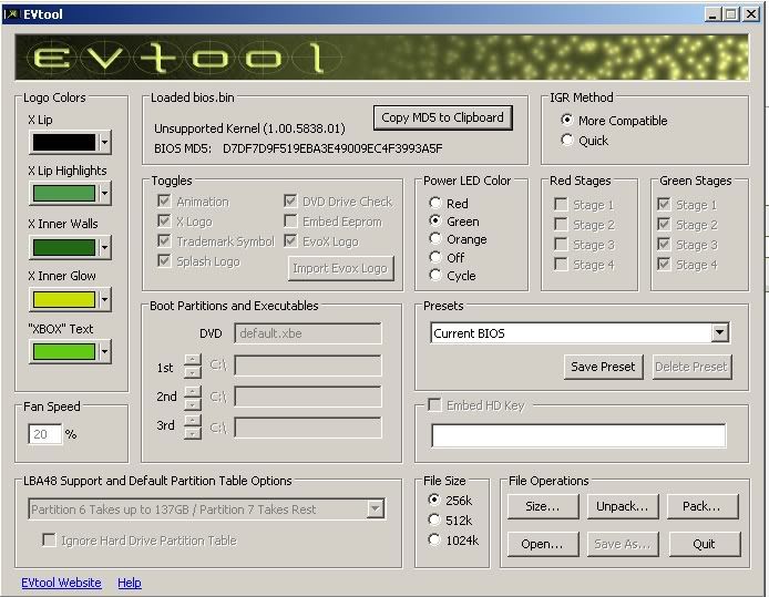

I understand that - it just sounded like you were putting your burned media in once the MS dash had booted.  Do you know exactly what bios you flashed?  Can you open the image in evtool and see what settings it had?

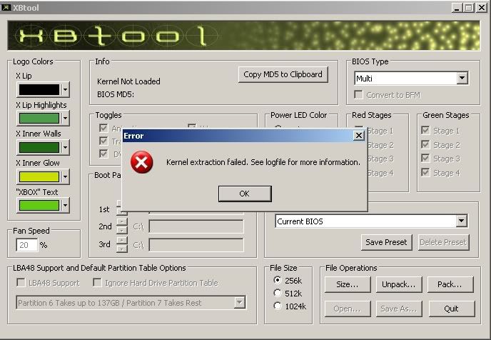

« Reply #5 on: November 29, 2006, 06:05:00 AM »
Not sure what this means.
Log:
 == 11/29/06 08:48:32 == Open ==
Loading ROM image file 'C:\Documents and Settings\Norm\My Documents\XBOX Krayzie Ndure SOFTMOD Pack\XBOX Krayzie Ndure SOFTMOD Pack\Krayzie Ndure Pack\007\007 save\UDATA\4541000d\000000000000\bios.bin'...
Extracting 2BL image...
Extracting compressed KERNEL image... Invalid config params for kernel extract!
