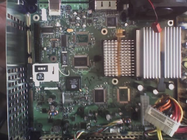

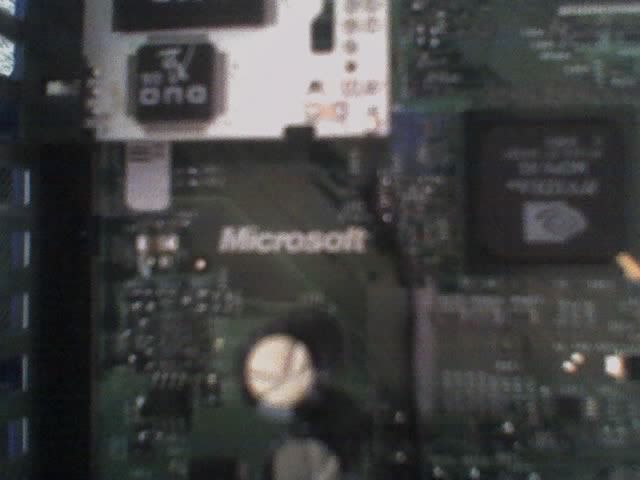

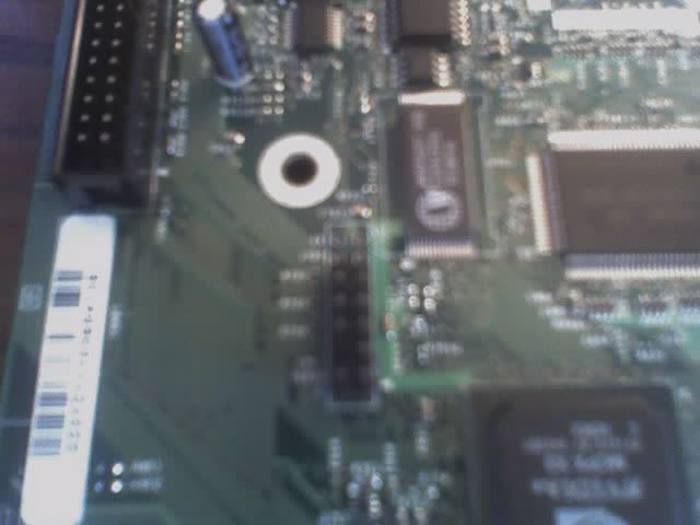

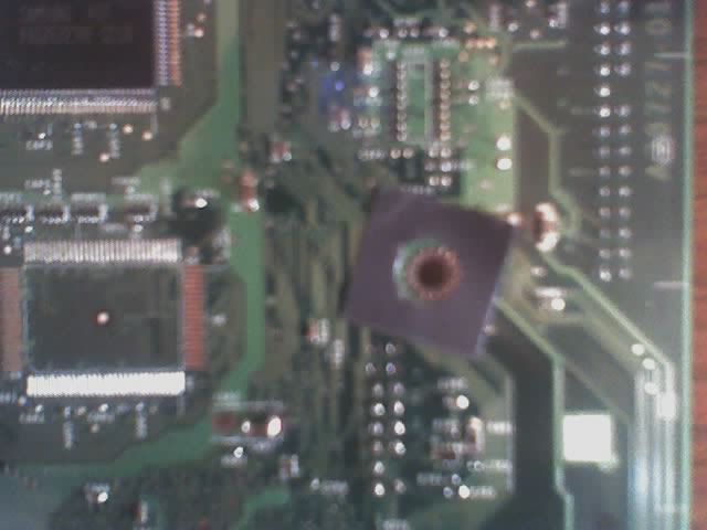

Heres the best pics i can get of the install (Cell phone cam)
IPB ImageIPB Image
IPB ImageIPB Image
IPB ImageIPB Image

From what i can make out from the pics the soldering looks pretty good. what do you think?
One thing i am worried about is in the pic he used the top D0. And he said its now installed with the bottom/alt D0. Plus he tested with a X2 .. which means hes soldered on the D0 at least 3 times sad.gif. From what i understand the D0 is pretty dleicate ......

NM he used the top D0 to test and the bottom D0 for the final install .. and the same wire for the X2 .. I was under the impression that the top and bottom D0 where the same point and while they lead to the same place they are actually 2 diff points heh..
