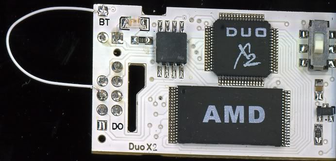

I have a 1.0 xbox modded with a duox2 lite. I dont see any light flashing when the xbox is booted (i dont know whether the lite has a led or not..). It boots to ms dash when either power or eject buttons are pressed.
It is either the d0 or the bt because i have checked the lpc and it looks good. Also to note is that the BT pad fell off (!), so I had to solder to the via, and I checked continuity between the BT on the xbox(behind eject) and BT on the chip(one of the legs of the chips where the bt trace leads to) and it was good, but the connection seems a little weak.

Try an always on install.  Wire BT to Pin 9 on the Duo(picture below).  Take D0 from the motherboard and ground it on a screwhole.
It should be the same for the Lite.  The Lite doesn't have the LED.
