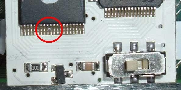

I just noticed this solder blob on the DuoX2's TSOP and  idont know if it shoud be there. Heres a pic.

« Reply #8 on: July 19, 2005, 01:02:00 PM »
yes its there on the blue ones so will be there on the white
