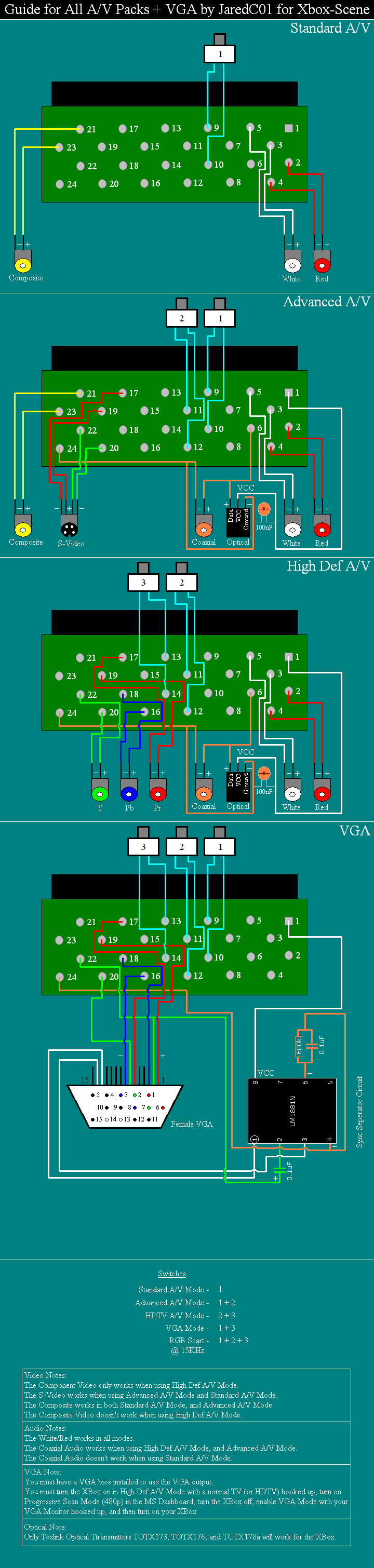

How To Add Composite Out On The Back Of Xbox?
« on: April 08, 2012, 04:49:00 PM »
That's all you need
I suggest to mount a component output (much better video quality, 480p, 720p, 1080i available!)
Xboxee
« Reply #1 on: April 08, 2012, 07:11:00 PM »
Thanks for the quick reply man! I don't understand one thing on the schematics, what this green thing with numbered pins represents, is that the top view of av connector inside the Xbox?
Heimdall
  • Posts: 3862
« Reply #2 on: April 08, 2012, 07:23:00 PM »
It's the Xbox motherboard. Here's the post that picture comes from, in case you need a few more details.
Xboxee
« Reply #3 on: May 25, 2012, 07:48:00 AM »
