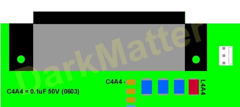

There's an excellent chance that you fault lies with an open circuit video choke.
See picture for location. Its the one marked: L4A4:
You'll need the aid of a multimeter set for continuity. Measure to see if it does have continuity. If not, then its most likely open circuit. You can fix it by bridging a thin piece of wire across it.
Please let us know how you get on.
