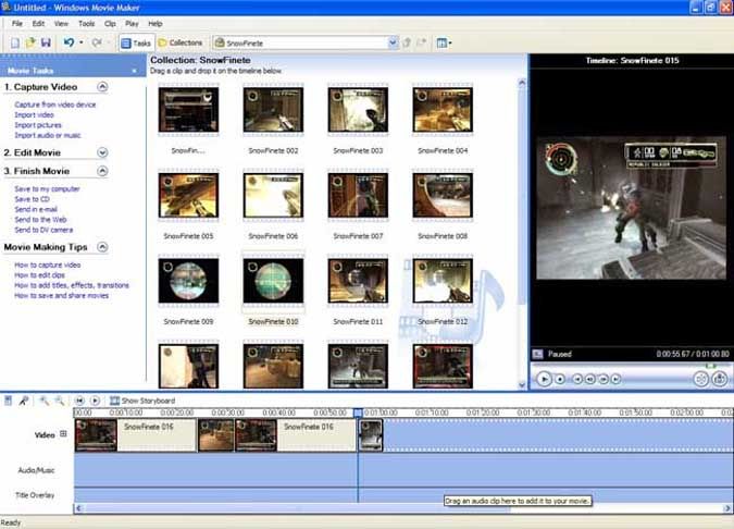

EDITING WHAT YOU CAPTURE (WINDOWS MOVIE MAKER, WHO KNEW)
Now that you captured a 20meg video of some game, you may want to edit it by cutting out unwanted scenes or adding fade-ins, special effects, voice overs, text, audio tracks or some photos like your sig.
You may not realize this, but if your using Windows XP you already have a movie editor already installed. That movie editor is Windows Movie Maker. Just click on the Windows Start button go to programs, and Windows Movie Maker is one of the last icons.
Windows Movie Maker is a basic movie editor, but you can use it to do everything I mentioned earlier, and more. Plus its easy to learn, though not that easy. You’ll definitely need to play around with it for a while to learn how to use all the features.

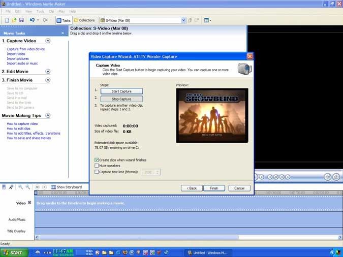

Another feature, is that you can record right to Windows Movie Maker. Heres how to try it:
In Movie Maker click file, click capture video, then under available devices you should see your tuner card BE SURE to choose S-Video in the Video Selection Box and check the Audio Input Source box you might have to select “What U Here” for an audio selection (you may have to play around with this setting if you don’t record sound), now you’ll be able to name your video and choose where to save it, click next, now you can choose the quality to save your video, click next, click start capture, then when done recording click end capture. Can’t get much easier. And since it captured right to Movie Maker you can start editing.
When it comes to the output quality of your video, you’ll need to test what settings are best. Try the recorder software that came with your tuner and compare it with Windows Movie Maker. The software designed for the tuner may do a better job. But that’s up to you to experiment.

Here are some Windows Movie Maker Screenshots

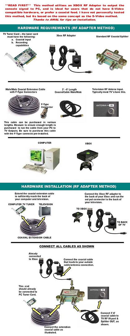

I'm putting together another tutorial for the Xbox RF Adapter method, which will be posted in this thread, so people can have a choice of methods. Though I feel the S-Video method provides a nice clean output, and doesnt interfere with the normal operation of a tuner card. However, the RF Adapter does not need all the splitters, which some may prefer.

The above tutorial now includes an alternative "RF Adapter" method.
The "RF Adapter" method has been added to provide an alternative solution to the original "S-Video" method. Either method outputs the Xbox signal to PC via a TV Tuner card.
I have not personally used an "RF Adapter", therefore I cannot comment on the quality of the signal output via this method in comparison to S-Video transmission.
Please review both methods to determine which suits your needs best.
Thanks to AWAL for advice on installation & hardware setup utilizing an Xbox RF Adapter.

I never had to spilt audio that many times, so I cannot give an answer based on experience. The splitter you show does appear to be designed for the purpose you intend to use it for, but I do not know if feedback may occur.
You can always go the RF Adapter method, since the coaxial will also carry sound, freeing you of the need for an additional audio-in. However, I do not know if the quality will be the same as S-Video.
