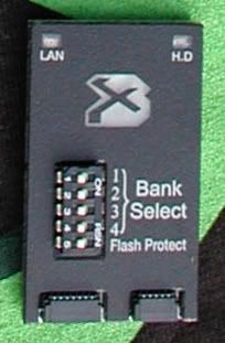

Are there any external switches on the Xbox (like the one top right, third picture down here, or seventh picture down here, or at the bottom of the third picture down here)?
Install and run BIOSChecker, it will give you a chip ID that can be helpful in narrowing down the chip type - or at the very least allow you to work out what size BIOS the chip can hold.

It's definitely an Xecuter chip; the logo comes up on the screen at startup, and there is an external switch module.  Heimdall provided a picture of the exact one in the third link (I've cropped it):
(IMG:http://i6.photobucket.com/albums/y218/k8track/xecuterchip.jpg)
I went into Settings and couldn't see any explicit mention of which BIOS it's using, but under Settings - Main Options - Misc Info, I did see this: Xbox 1.6 detected.  Does all of this help to narrow down things somewhat?
Should I still go ahead and install and run BIOSchecker, and if so, could you tell me how to do that?  Or if not, any suggestions on how to proceed from this point?  Is this either an Xecuter or Avalaunch issue, and should I post a question in one of those forums?  Thanks.

So you have an X3 - that's excellent news. Press and hold the white controller button while you boot, and if you have an X3 BIOS it should load X3 config live. At that point you'll be able to check the BIOS version easily, reflash a new BIOS, set up how the BIOS uses the disk, etc.
