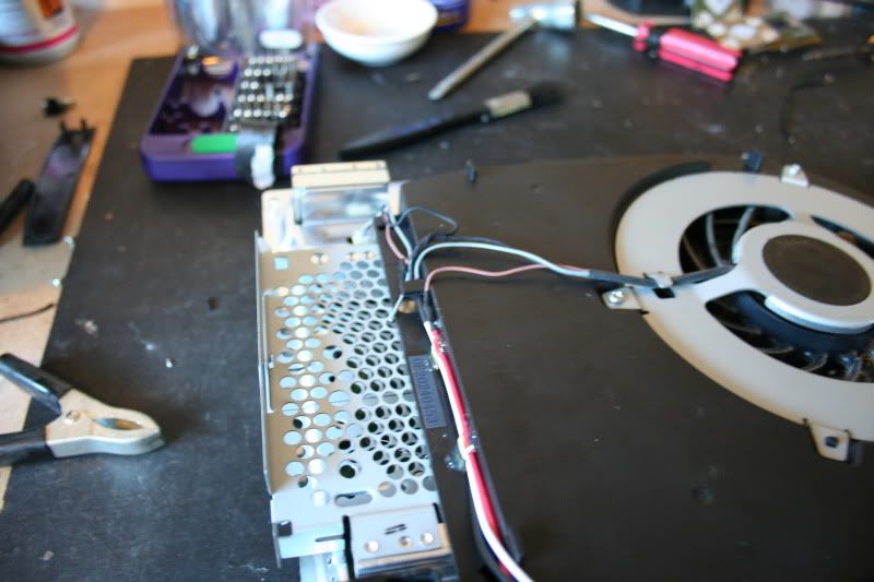

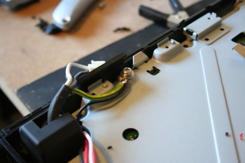

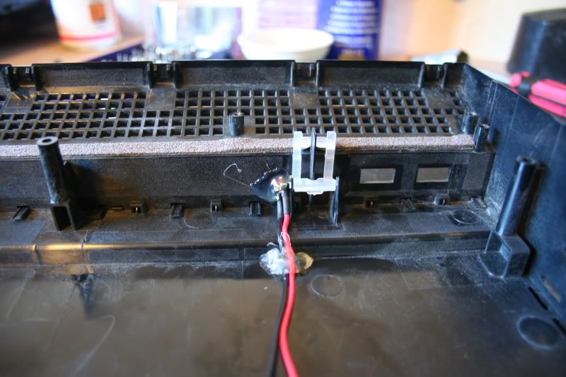

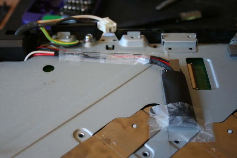

I do have an install pic:
This one is the diode version. Different capacitors and diodes require different value resistors to get the speed just right when using the diode variable duty version.
After soldiering I just wrap in tape and tuck in over the fan connector.
