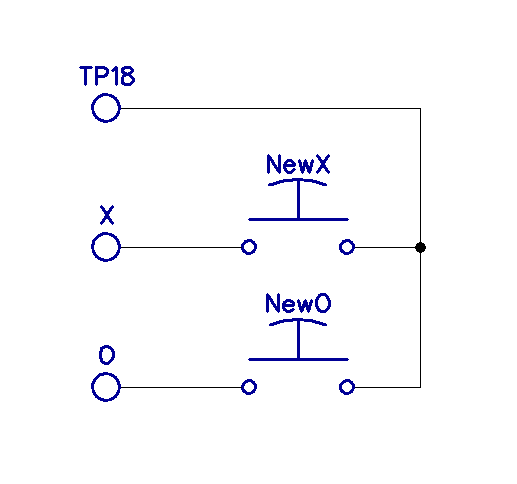

TP18 is only the common connection for the X and O buttons. One side of each of your new X and O buttons will go to TP18. The other side of X and O will need to go to the X and O buttons spots respectively.
Those X and O spots are shown in the PS3 Controller Versions and TP Spots thread in this forum section.
Also, I feel really stupid not seeing the MSU_VX3_008. Thank you for that too!

You'll have to prep a couple of Vias to solder the X and O wires to, then you'll use TP18 for the common connection for them.

TP18 is the common connection (COM2) for the X and O buttons. That would go to one side of your new buttons, then the other side of each of them would go to the X and O Vias that you prepped. So when you press your new X button, you're connecting the X and COM2 lines together, same thing for O.

You can run 1 wire from TP18 to one of the new buttons, then another one from that button to the other button, or 2 different wires from TP18, it's all the same electrically. The black dot just means those 2 lines connect.
