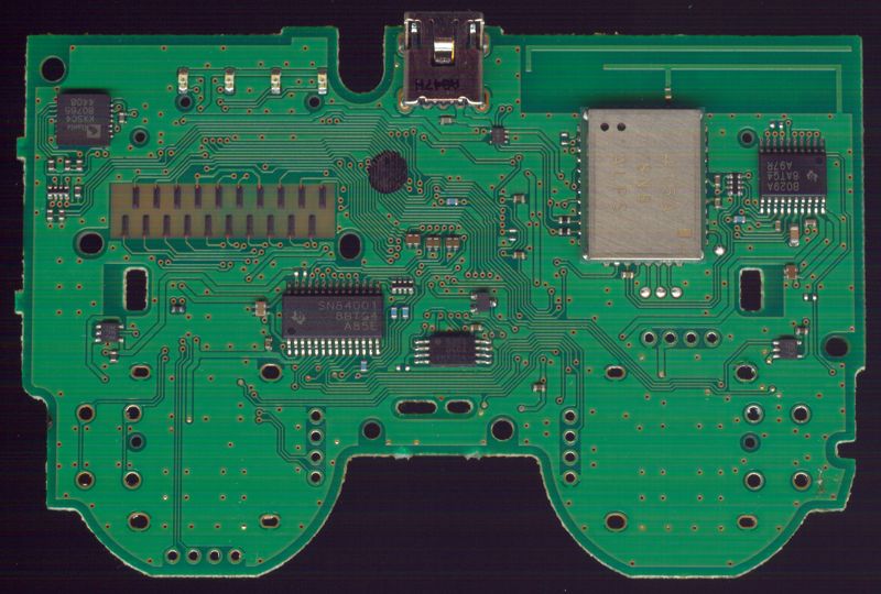

MSU_VX 1.03 (DualShock 3, The first version of it that I'm aware of)
BOTTOM
(IMG:http://i50.photobucket.com/albums/f320/RDCXBG/PS3%20Six-Axis%20and%20DS3/MSU_VX103Bottom.jpg)
TOP
(IMG:http://i50.photobucket.com/albums/f320/RDCXBG/PS3%20Six-Axis%20and%20DS3/MSU_VX103Top.jpg)
Here the DualShock 3 controller has been updated slightly. The main difference is the way the daughter board connects to the main board. They've done away with the connector completely now and it's just a pressure fit connection. This makes for taking the thing apart much easier as the whole thing doesn't have to be torn down now to unplug the daughter board. The brace is white in this version of controller also, where it's black in the older version. The TP spots are also different on this version of board compared to the older DS3 version.

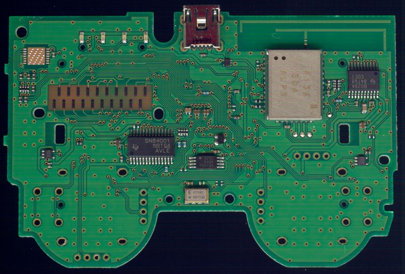

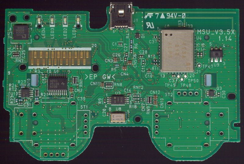

MSU_V3.5X 1.12 (DualShock 3) There is also an MSU_V3.5X 1.14 Bottom - Top
BOTTOM
(IMG:http://i50.photobucket.com/albums/f320/RDCXBG/PS3%20Six-Axis%20and%20DS3/MSU_V35X112Bottom.jpg)
TOP
(IMG:http://i50.photobucket.com/albums/f320/RDCXBG/PS3%20Six-Axis%20and%20DS3/MSU_V35X112Top.jpg)
New Daughter Board Connection
NOTE: If you take any controller version apart that has this type of Daughter board connection (and all versions from here on do) make sure that small Black Foam piece doesn't get lost. If it's not in there the Daughter board isn't going to make a good connection against the controller board when it's all put back together and the buttons will not work.
(IMG:http://i50.photobucket.com/albums/f320/RDCXBG/PS3%20Six-Axis%20and%20DS3/MSU_35X112Daughterboard2.jpg)

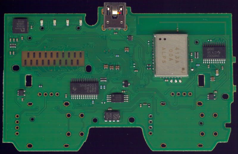

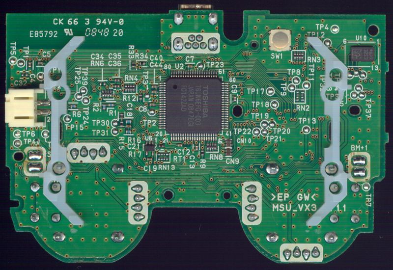

Well here we go with the latest version of the DS3 and all of it's revised goodness. The board version number is below, but you can tell if ya have this one before even opening the controller as they have redone the bottom half of the shell and made it all once piece instead of having the small filler pieces between L1/R1 and L2/R2 like every version before it.
(IMG:http://i50.photobucket.com/albums/f320/RDCXBG/PS3%20Six-Axis%20and%20DS3/MSU_VX3_007001.jpg)
This doesn't necessarily mean if it has that bottom half it's this exact version, newer versions may also use this redesigned shell, but it's a pretty quick way to tell ya don't have one of the older DS3 versions without having to open the controller up.
Inside the controller they've done away with the metal brackets that hold the Rumble motors and made the Daughter board brace hold them, PS2 controller style. The Daughter board still uses the same type of pressure fit connection as the V3.5X has, as well as the same Daughter board.
(IMG:http://i50.photobucket.com/albums/f320/RDCXBG/PS3%20Six-Axis%20and%20DS3/MSU_VX3_007003.jpg)
MSU_VX3_0.07 (DualShock 3) There is also an MSU_VX3_0.08 (DualShock 3) BOTTOM - TOP and an MSU_VX3_0.11 (DualShock 3) BOTTOM - TOP
BOTTOM
(IMG:http://i50.photobucket.com/albums/f320/RDCXBG/PS3%20Six-Axis%20and%20DS3/MSU_VX3_007Bottom.jpg)
TOP
(IMG:http://i50.photobucket.com/albums/f320/RDCXBG/PS3%20Six-Axis%20and%20DS3/MSU_VX3_007Top.jpg)
The Triggers pivot pin has now been made from plastic instead of having a metal pin, this was most likely done to reduce costs, and it makes the older L2/R2 incompatible with the newer design, so if ya ever need to replace them for any reason on this version of controller they'll have to be this newer style.
(IMG:http://i50.photobucket.com/albums/f320/RDCXBG/PS3%20Six-Axis%20and%20DS3/MSU_VX3_007004.jpg)
And yet another revision change, this time around has some more changes as well, similar to when they went to the VX3 versions above, but this is the VX4.
(IMG:http://i50.photobucket.com/albums/f320/RDCXBG/PS3%20Six-Axis%20and%20DS3/MSU_VX4_009White.jpg)
The Daughter board has been updated slightly, though it works the same way as before. The Daughter board brace is slightly revised also and holds the Rumble motors a bit differently, as well as clips into the controller shell now.
(IMG:http://i50.photobucket.com/albums/f320/RDCXBG/PS3%20Six-Axis%20and%20DS3/DaughterBoard.jpg)
One of the slight changes is the D-pad, instead of the older 2 piece design shown on the left, it's now just the once piece shown on the right.
(IMG:http://i50.photobucket.com/albums/f320/RDCXBG/PS3%20Six-Axis%20and%20DS3/D-pads.jpg)
The major change is the Left Stick has been mounted 180 degrees from previous board versions, which makes the board slightly smaller.
MSU_VX4_0.09 (DualShock 3) There is also an MSU_VX4_0.10 (DualShock 3) BOTTOM - TOP
BOTTOM
(IMG:http://i50.photobucket.com/albums/f320/RDCXBG/PS3%20Six-Axis%20and%20DS3/MSU_VX4_009Bottom.jpg)
TOP
(IMG:http://i50.photobucket.com/albums/f320/RDCXBG/PS3%20Six-Axis%20and%20DS3/MSU_VX4_009Top.jpg)
I'd really like too have 1/10th of the money Sony is dumping into all of these revision changes when almost none of them are any improvement or even necessary in the least.
This post has been edited by RDC: Sep 7 2011, 05:24 AM

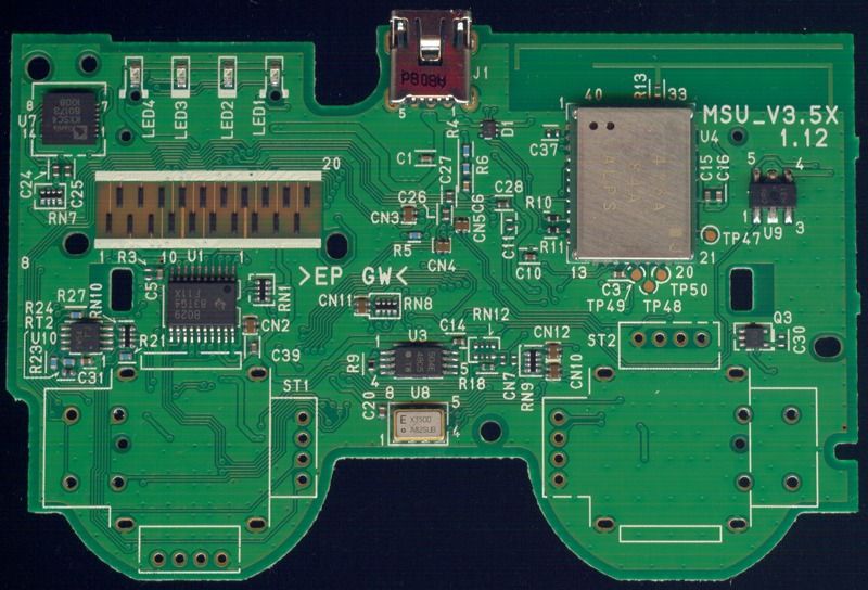

Here's yet another board revision, this time it's the DualShock 3 controller that has been updated slightly. The main difference is the way the daughter board connects to the main board. They've done away with the connector completely now and it's just a pressure fit connection. This makes for taking the thing apart much easier as the whole thing doesn't have to be torn down now to unplug the daughter board.
BOTTOM
TOP
(IMG:http://i50.photobucket.com/albums/f320/RDCXBG/PS3%20Six-Axis%20and%20DS3/MSU_35X112Daughterboard1.jpg)

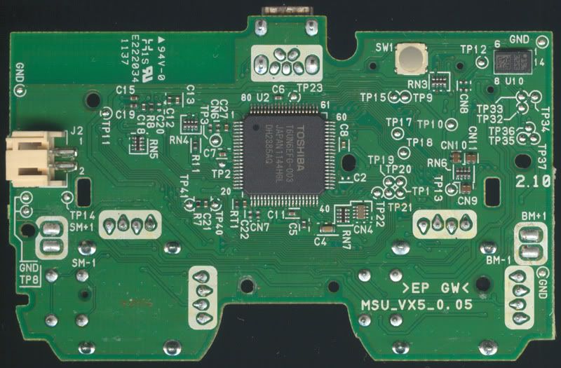

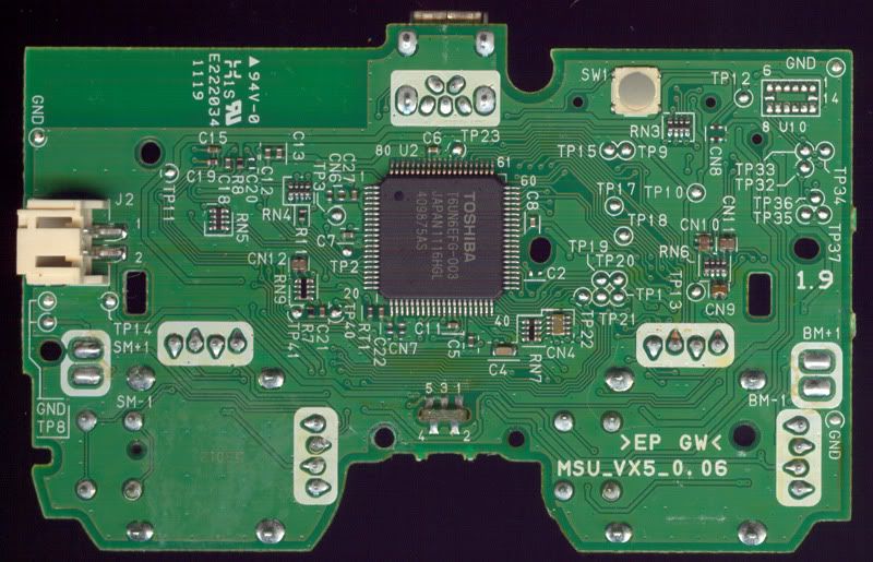

Here is the latest VX5 version board. Just minor changes since the VX4, mainly the Battery, smaller Bluetooth board and a few other ICs.
MSU_VX5_0.05 (DualShock 3) There is also an MSU_VX5_0.06 (DualShock 3) BOTTOM - TOP
BOTTOM
(IMG:http://i50.photobucket.com/albums/f320/RDCXBG/PS3%20Six-Axis%20and%20DS3/MSU_VX5_005Bottom.jpg)
TOP
(IMG:http://i50.photobucket.com/albums/f320/RDCXBG/PS3%20Six-Axis%20and%20DS3/MSU_VX5_005Top.jpg)
The Battery has been changed to do away with the plastic spacers needed. It's now an LIP1472, but everything else is the same as the LIP1359 (see above posts) and it can be swapped for any of the other battery versions or vice-versa with the correct spacers.
(IMG:http://i50.photobucket.com/albums/f320/RDCXBG/PS3%20Six-Axis%20and%20DS3/MSU_VX5004.jpg)
The Daughter Board has been slightly updated, but still works the same as the others do, and the rubber pieces are now clear instead of white.
(IMG:http://i50.photobucket.com/albums/f320/RDCXBG/PS3%20Six-Axis%20and%20DS3/MSU_VX5DB.jpg)

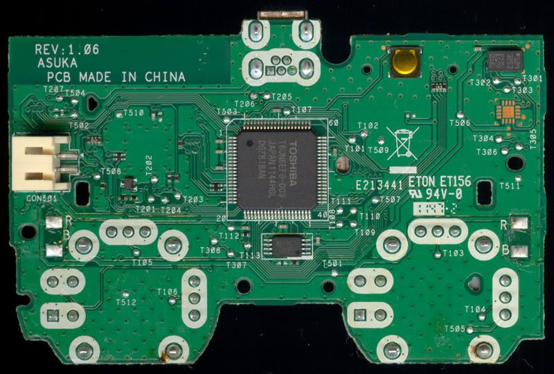

Introducing the Asuka. (Special Thanks to odingalt for donating this controller)
Sony has either decided to go as cheap as possible with these controllers now, or some 3rd party manufacturer has access to the good MCU used in them.
The 4 leg Hall Sensor style Sticks are gone, back are the old 10k POT style, but still not the 'typical' size, so replacing them is again a hassle.
(IMG:http://i50.photobucket.com/albums/f320/RDCXBG/PS3%20Six-Axis%20and%20DS3/AsukaRev106010.jpg)
The Daughter Board hasn't changed any, aside form looking like it was cheaper to make, but that goes along with pretty much everything about the controller. Even the shell feels a little different and the white color doesn't match the older ones. This thing was designed from the point A to point B standpoint, nice and simple and done, it just doesn't seem to be built with the same quality as any of the earlier versions.
(IMG:http://i50.photobucket.com/albums/f320/RDCXBG/PS3%20Six-Axis%20and%20DS3/AsukaRev106011.jpg)
For the most part, nothing has really changed at all. It still uses the same COM line configuration as all of the other versions, thus it works the same way, so please no "will this or that modchip still work on it" questions, that was just answered.
ASUKA REV: 1.06
BOTTOM
(IMG:http://i50.photobucket.com/albums/f320/RDCXBG/PS3%20Six-Axis%20and%20DS3/AsukaRev106Bottom.jpg)
TOP
(IMG:http://i50.photobucket.com/albums/f320/RDCXBG/PS3%20Six-Axis%20and%20DS3/AsukaRev106Top.jpg)

MSU_VX3
(IMG:http://i50.photobucket.com/albums/f320/RDCXBG/PS3%20Six-Axis%20and%20DS3/MSU_VX3_007Vias.jpg)
The TP spots for the buttons have all been removed from this board version, so that means hitting a Via to attach wires, and they're about 1/3 the size of the ones in a 360 controller, so even if you're pretty good at landing a wire on those you'll have to be a a lot more careful scraping down and landing one on these things.
Right now this is probably the best spots to hit for an Arcade Stick or duplicate buttons, and until I use this board for something they should suffice, so this part here may be updated after I've done some more work on the board wiring it up to something and seeing which methods and spots work best. They were nice enough to leave the COM1 and COM2 TP spots behind, though that hardly makes it any easier if you were making an Arcade Stick from this version of board and it'll make building a PS360 with this version of board a little more fun as well. (IMG:style_emoticons/default/wink.gif)
There isn't much in the way of useful TP spots, but here they are, and like all of the other versions of controller the USB TP spots are still the same.
TP11 - LED + and V (Common Line for Home Button)
TP13 - 2.8v (Switched, Power for Sticks)
TP14 - Battery +
TP17 - COM1
TP18 - COM2
RST is the Reset or 'off' button on the bottom of the controller that pretty much no one uses I'd imagine. The other side of it is Ground and any spot will work if you want to duplicate that button for any reason.
Again there is no TP spot for the COM3 line and the best place to use is one of the solder joints for the L3/R3 buttons, or you can hit a Via for it if you like.
For any Arcade Stick builders using this board version, soldering to the Vias on these controllers isn't exactly the easiest thing to do, flipping the board over and using the contacts for the Daughter board is really the best option.
The black carbon material needs to be removed if these spots are to be used, and this can be done with an X-acto knife or some fine sandpaper, just be careful and when you get to the shiny copper, STOP, you're done. Tin it up with some solder and there are your spots to use. Try and use a 30awg wire, or 28awg at the largest, and make sure to secure the wiring with some hot glue after you make the connection, but don't glue over the solder joint you just made, secure the wire to the board back from the solder joint, in case you ever have to get to it again for any reason.
The Pull-Up Resistors (7.5k) also need to be put back in the circuit as they're built into the Daughter board and when it's removed they're not, and the controller will act up on you if these are not in circuit, why Sony decided to do this back with the PS2 controllers and carry it over to the PS3 is beyond me, it's really lame. There needs to be 2 of these Pull-Up Resistors installed, one goes from V to COM1, the other goes from V to COM2. If you don't have any 7.5k Resistors you can use anything from 6.8k to 10k really, but they do need to be installed since the Daughter board is removed, and all of the PS3 controllers are setup this way and need those Pull-Ups if the Daughter board is removed.
(IMG:http://i50.photobucket.com/albums/f320/RDCXBG/PS3%20Six-Axis%20and%20DS3/MSU_VX3_007Connection.jpg)

MSU_VX5
Pretty much the same deal as the VX3 and VX4 above, again just a little different layout.
(IMG:http://i50.photobucket.com/albums/f320/RDCXBG/PS3%20Six-Axis%20and%20DS3/MSU_VX5_006TP.jpg)
TP8 - Rumble +
TP10 - LED + and V (Common Line for Home Button)
TP14 - Battery +
TP17 - COM1
TP18 - COM2

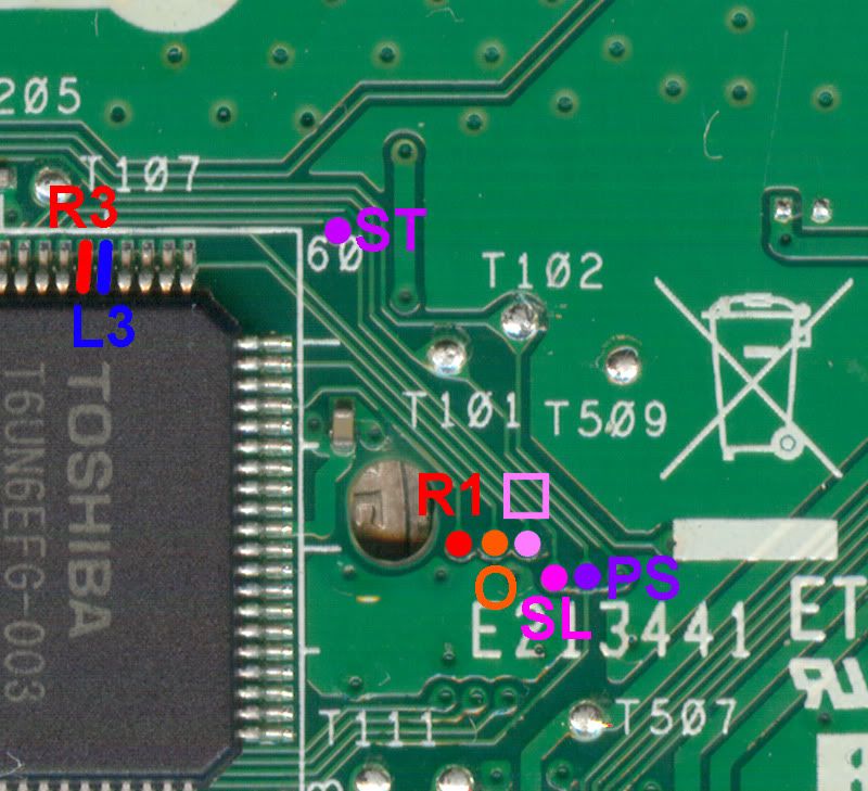

ASUKA REV: 1.06
As with earlier versions, there are no useful TP spots for any of the buttons, and just about every useful Via on the bottom side of the board is gone from this controller as well, so you'll be going top side for extra buttons on this one.
BOTTOM
(IMG:http://i50.photobucket.com/albums/f320/RDCXBG/PS3%20Six-Axis%20and%20DS3/AsukaRev106TPB.jpg)
TOP
(IMG:http://i50.photobucket.com/albums/f320/RDCXBG/PS3%20Six-Axis%20and%20DS3/AsukaRev106TPT.jpg)
T101 - COM1
T102 - COM2
T103 - LSX
T104 - LSY
T105 - RSX
T106 - RSY
T205 - D+ (USB)
T206 - D- (USB)
T207 - 5v (USB)
T301 - Accelerometer Z-Axis (Pre Filter)
T302 - Accelerometer X-Axis (Pre Filter)
T303 - Accelerometer Y-Axis (Pre Filter)
T304 - Accelerometer Z-Axis (Post Filter)
T305 - Accelerometer X-Axis (Post Filter)
T306 - Accelerometer Y-Axis (Post Filter)
T501 - Rumble +
T504 - 2.8v (Standby)
T505 - 2.8v (Switched, Power for Sticks)
T506 - 2.8v (Switched, Power for Accelerometer)
T507 - LED + and V (Common Line for Home Button)
T508 - Battery +
T509 - GND
T510 - GND
T511 - GND
T512 - GND

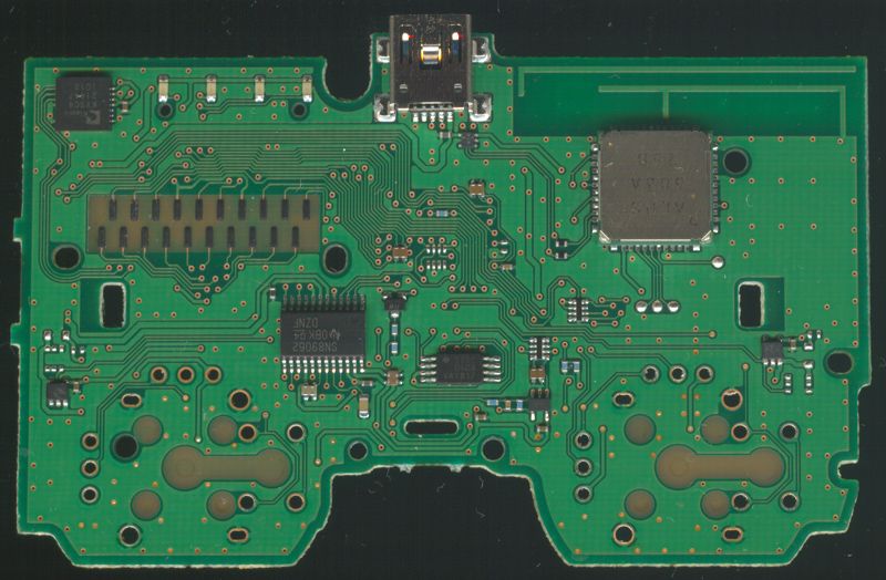

MSU_VX6
Same as with the earlier versions, there are no useful TP spots for any of the buttons on the bottom of the board. This version is pretty close to how the VX3, VX4 and VX5 were done.
(IMG:http://i50.photobucket.com/albums/f320/RDCXBG/PS3%20Six-Axis%20and%20DS3/MSU_VX6_006TP.jpg)
TP2 - D- (USB)
TP3 - D+ (USB)
TP8 - Accelerometer -Axis (Pre Filter)
TP9 - Accelerometer -Axis (Pre Filter)
TP10 - Accelerometer -Axis (Pre Filter)
TP11 - Accelerometer -Axis (Post Filter)
TP12 - Accelerometer -Axis (Post Filter)
TP13 - Accelerometer -Axis (Post Filter)
TP14 - COM1
TP15 - COM2
TP16 - LSX
TP17 - LSY
TP18 - RSX
TP19 - RSY
TP25 - Rumble +
TP29 - LED+
TP30 - Battery +
GND - GND
This post has been edited by RDC: Nov 1 2012, 02:34 PM

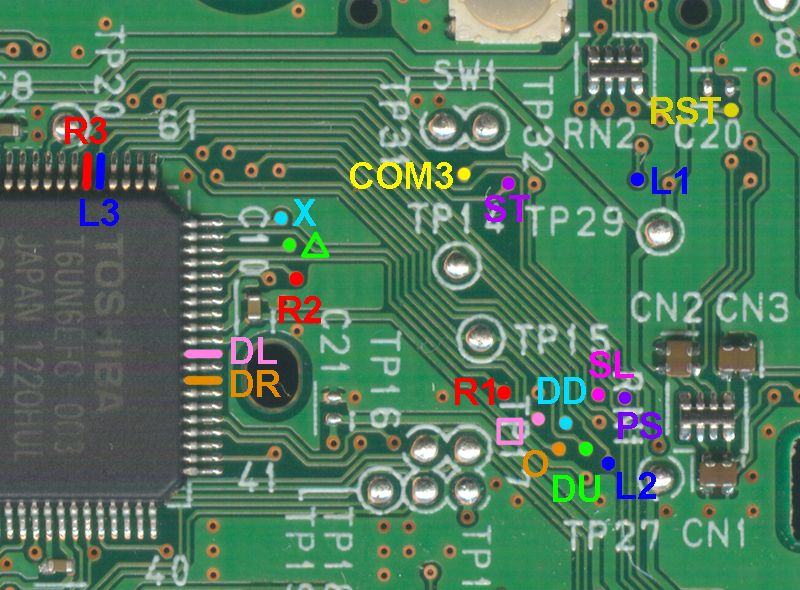

MSU_VX7_0.04 (DualShock 3)
