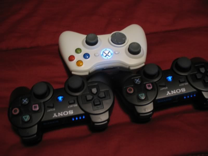

I just did this mod to two PS3 controllers for Mattyv, i think they turned out pretty good:

yeah th PS mod looks easy enough but with the assignment LEDs can't you just desolder the ones there and replace them with the color you want? I mean with the pics it looks like all the LEDs are on at once which isn't possible unless you don't have them showing their assignment.
