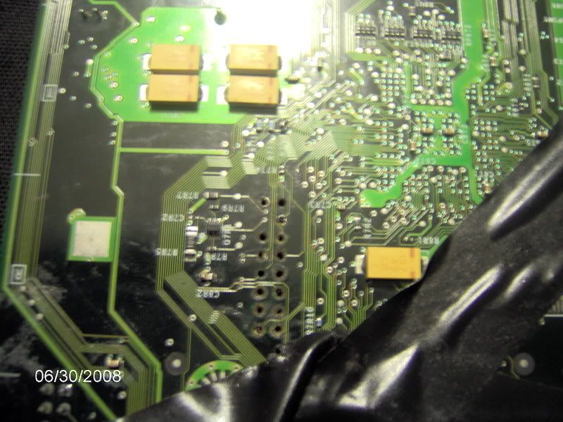

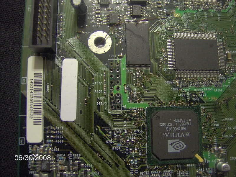

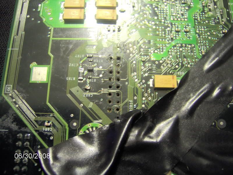

Well i looked around the lpc there looks like there no traces broken or anything. I took some pictures tryed to make them clear as i can.. Check them out and tell me what u think.

You have trashed the LPC again. Clearly you have removed every single annular ring on the LPC, barring 4.
Example up by C701. the short piece of print track..what is it going to connect to? There is no ring left on the LPC connection. The same applies to the others.
So far you have chosen to ignore the advice I have given and indeed some of the others in here.
You have now wrecked 2 boards. How many are you going to ruin before you look in the modchip installers section and get someone to do this for you?
The fact you don't even see the damage, put the chip on backwards, the LPC in the wrong holes and the D0 on the wrong point says it all. You didn't get one thing right about the install.
Let somebody else do it next time.
Harsh? Yes!! but you are not getting the message and in the end it's costing you money. I hope some of the other posters give you the truth as it may make you follow the right path to having a modded box again.

He is right.You need a much better grasp of whats going on to be able to complete this mod successfully.You also need to have much better soldering skills to attempt to do this mod which will take much more practice for you to do it correctly.And until you have these skills it would be in your best interest to stay away from any mobos
Chancer is the thread starter of the modchip in question did you not see his name on the top of the  pinned topic in the forum section you used to install the chip?
Chancer himself could do the work for you if you sent to the UK if he still does work.I would send to him myself if I needed work I could not do.Based on the knowledge of what Ive read from what he has posted he is the authority on modchip and smd rework.
