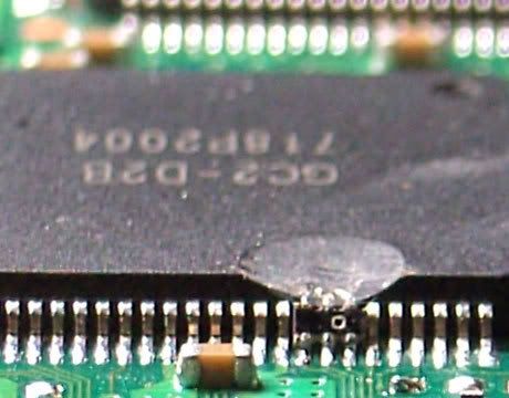

Have not been able to get my installation of wiikey to work, took a lot of pictures yesterday in hope that someone can help me...
(IMG:http://i230.photobucket.com/albums/ee14/sebastianand/forum_wii.jpg)
More pictures in very high resolution
As you can see, is it one of those d2b iccircuits with 3 chopped legs and the 5 leg from the left is missing a trace on the pcb, se picture below:
(IMG:http://i230.photobucket.com/albums/ee14/sebastianand/notrace.jpg)
Have reinstalled it many times now. Original works like a charm but backups don't not even the wiikey config disc. It only says "unable to read disk". Have tried a lot of dvd brands and different burners. Even backups witch works in other wii's who has been modified. Have also tried 2 different wiikeys. Is this fixable or should i just sell it and forget about it.... it's not a d2c chip in it...

Your three wires to the D2Bchip are definitely not connected properly.  You can easily see the rightmost one is connected to an adjacent pin.

Have now cleaned up the soldering but still no luck with backups

Have now reprogrammed my wiikey with the sp12 programmer, still no luck with backups. Have measured every connection with a multimeter too, all points checks out perfect
Is now going to try it with the openwii code instead

I had the same problem. No matter what I did the Wiikey would not seem to work? I had someone tell me to tweak the laser pot just a hair counter clockwise...I did that and boom everything works great now.
I actually went through 2 wiikeys and then switched to the YAOSM (which still didnt work) until I got this tip.

I think that I did I fine job on the d2B. Solder points very defined on the the shaved area and not even a trace of solder possibly touching other points.
Looks a hell of a lot easier when you have a pic blown up...in all actuality that is sooo tiny  sleep.gif
Anyways. As I stated before check your dvd drive laser. Fixed it all up for me and now all media I throw at it works great. Switch to the Yaosm also  laugh.gif  much better solution in my opinion.

Here's my solution for the cut-pins D2B chips: a 0-ohm resistor array!
And yes, I was in a hurry (customer was waiting) and didn't use the correct Dremel attachment...
