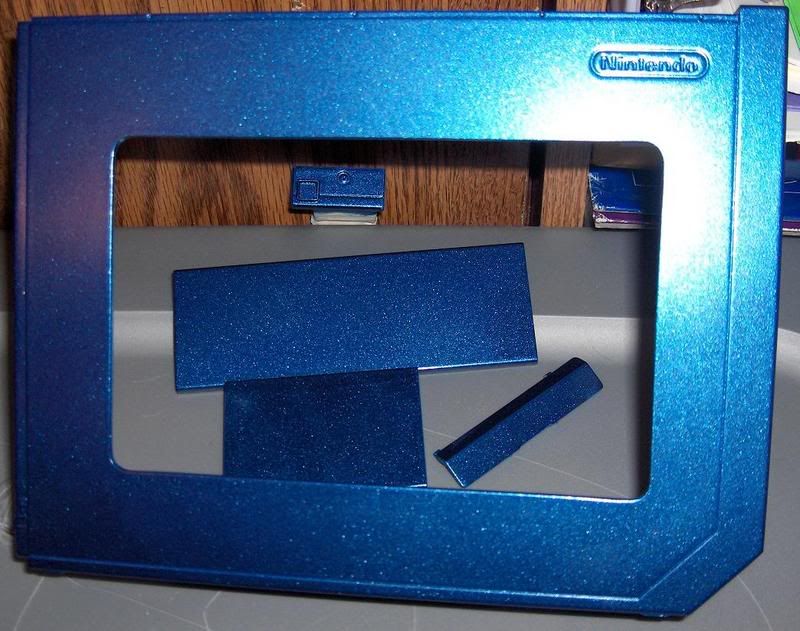

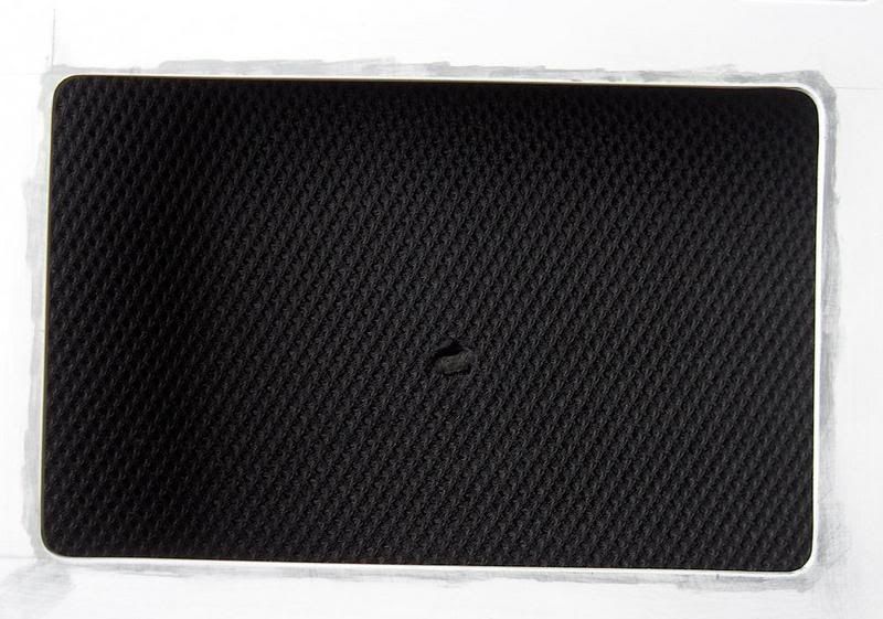

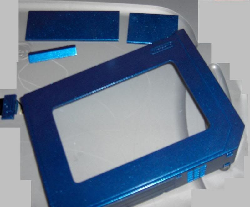

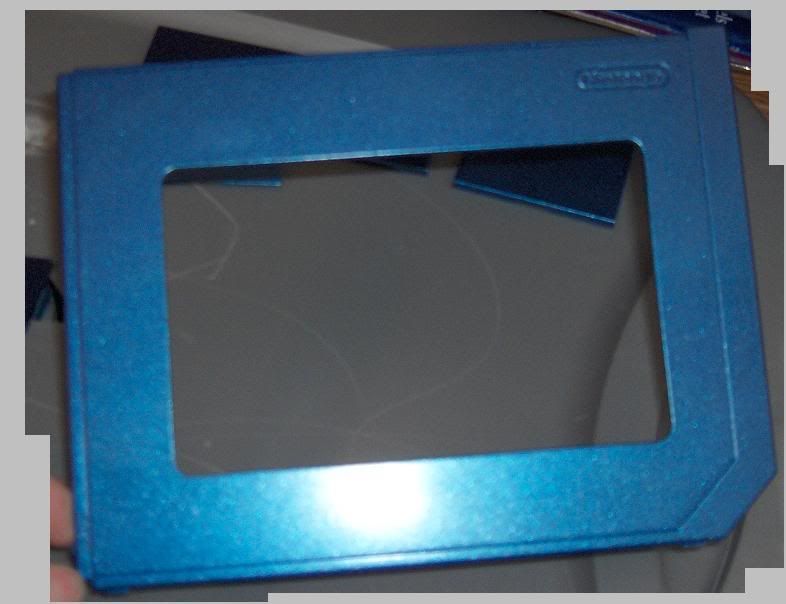

well i just started my mods
so here is some pics of the cuts, tell me if i need to do more work on them

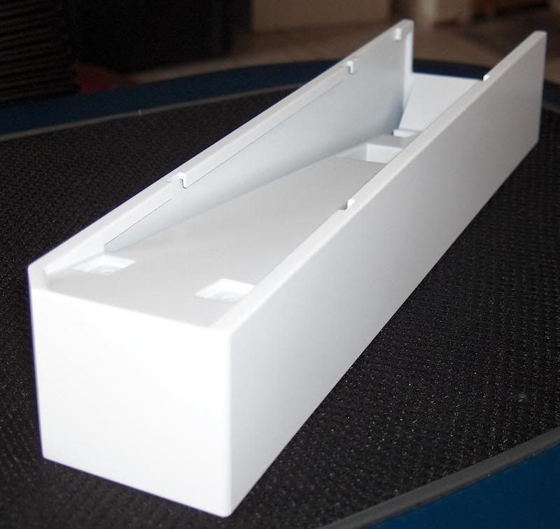

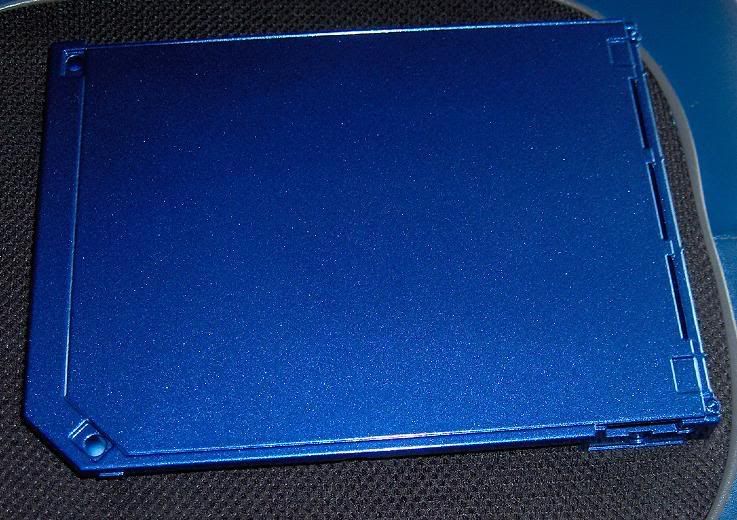

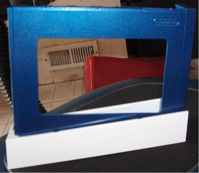

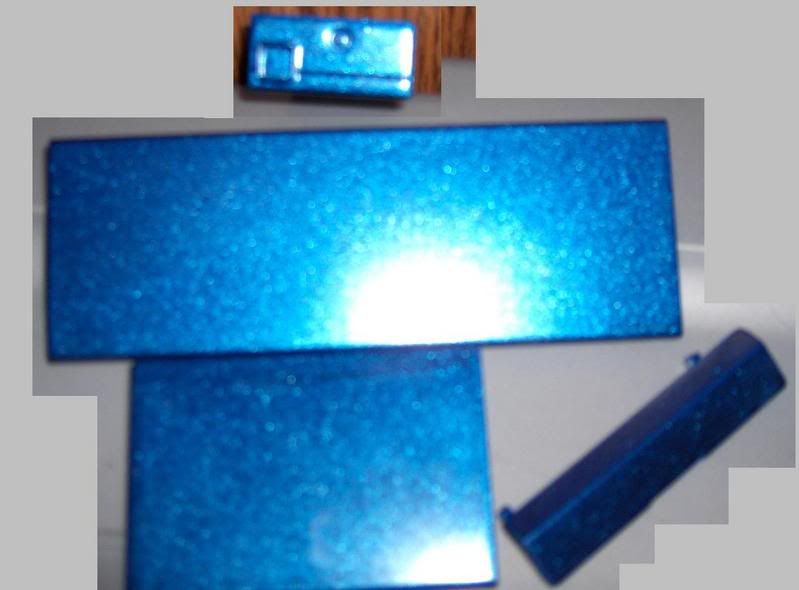

these are the pieces that are done with painting
what color leds should i use?
the base thing is going to be white BTW

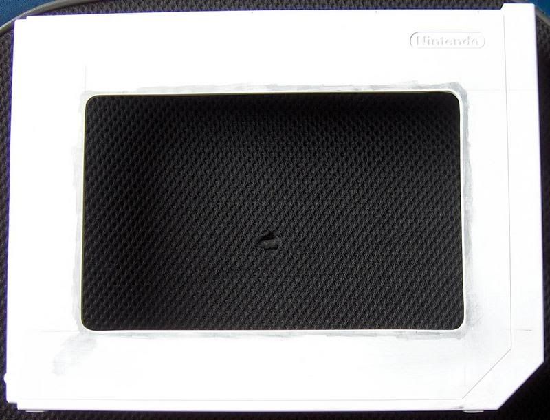

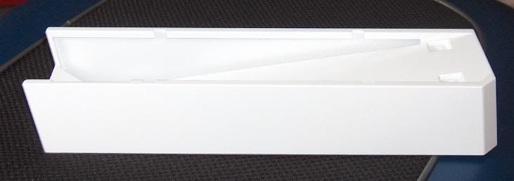

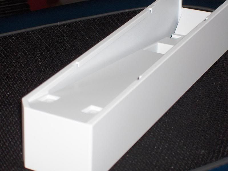

well this isnt much of an update but what ever.......
the painting is very good its just that i cant make it not blurry...sorry
it is white if u cant tell

« Reply #7 on: June 12, 2007, 06:36:00 PM »

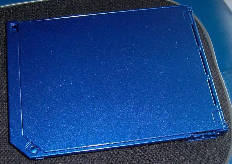

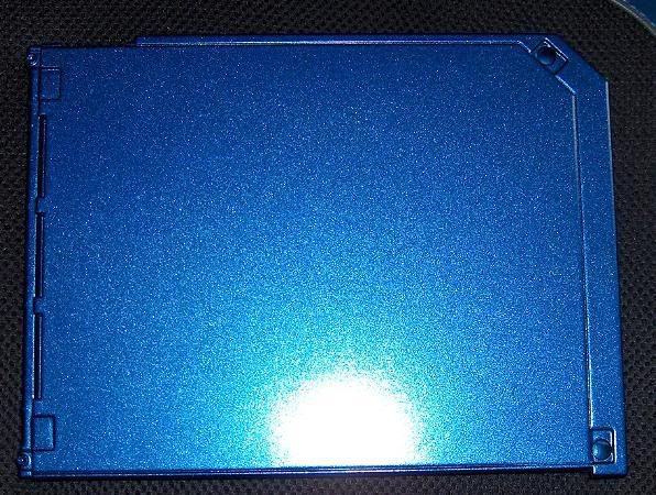

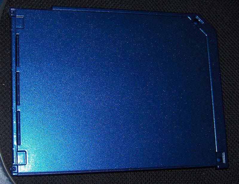

well i got the last piece finished
it took a lot of tries to get this piece good with paint, there kept getting little pieces of crap or something on it
well here it is
well lets see if this works

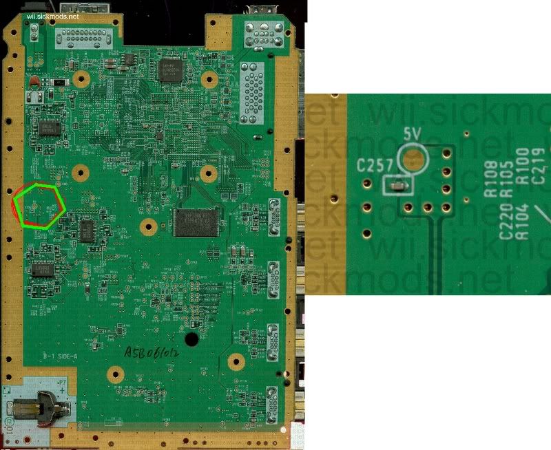

anyone know if this is good for power?
here is a link to it
http://pablot.com/fi..._net-bottom.jpg
but here is a pic
BTW i have this French final and i an procrastination by trying to figure stuff out about my wii
and yes it is all clearly marked like that

I think you could run into problems trying to power 100 LEDs. That point could work, but I wouldn't trust that big of a load on it; too risky.
A better solution for handling that big of a load is taking the power directly from the source. There is a spot right under the power plug that supplies the direct 12V. The problem with this though is that it is unswitched, so if you want your LEDs to turn off, you'd have to put a switch on them.
If you could lower the LED count, then it wouldn't be such a big load for the components and should still provide ample lighting.

and i couldnt get the solder to stick to that point.....i have done alot of soldering before with the xbox and 360 and the points looked the same as the 360 rf board and that was easy...( for the led color swap)
any suggestions
OK, 10 LEDs is perfect. You should measure the point too before using it to make sure it is a switched 5V source. You can use some flux on the point to get the solder to join with it. Unfortunately, the shipping charge must stay at that price. The resistors would rip a regular envelope, so they must be sent in a padded one, which significantly raises the price with their new rates.

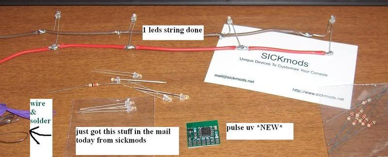

i got the supplies today
too bad i have to leave this weekend and i wont be able to finish this mod.....untill next week
thanks sickmods got it within 2 days
