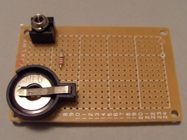

I wasn't 100% happy with the first attempt even though it works perfectly.  I want to ditch the A/C adapter entirely.
Version 2 work in progress:
Just need to cut the perfboard down to size, and mess around with voltages.
A single CR2032 (3V) battery doesn't put out quite enough voltage for the IR emitter so maybe I'll go with two stacked CR2016s for 6V total, with a different resistor.

Perplexer
  • Posts: 1096
Wireless Sensor Bar On The Cheap
« Reply #5 on: February 16, 2007, 09:31:00 AM »
It's on hold, been busy with work and other projects.
I don't know anything about the "dual IR emitter" that I'm using, so I don't have the voltage and current correct for v2.  At the moment, it works but has less range than the original sensor bar.
Which makes sense.  These things were originally designed to send IR signals only a couple inches (the LEDs are probably not bright enough for this purpose, shooting 15+ feet.)
I'm thinking about scrapping the dual IR emitter and using standard IR LEDs and putting them on a strip of breadboard, or connecting two of Sickmods' LED boards together and using that.

Perplexer
  • Posts: 1096
« Reply #9 on: February 18, 2007, 09:08:00 PM »
That's cool, I need to wrap up this post anyway and start from scratch smile.gif
After about 90 minutes of solid use, the IR LEDs died in my dual emitter.  I guess the voltage was too great for the poor little guys.
So I'll be ordering some standard infrared LEDs and trying something different this time...
