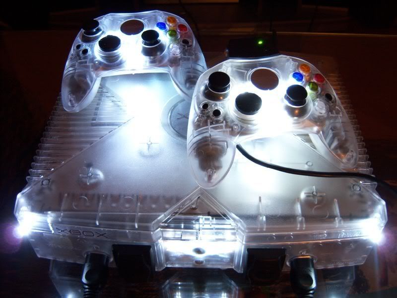

eXo
  • Posts: 46
Hdd Activity Led Mod
« Reply #6 on: November 05, 2007, 02:09:00 PM »
and now while I've got LED fever I did the controllers as well.. 6LEDs per controller. I did one in 3mm LEDs and the other in 5mm LEDs.  smile.gif
