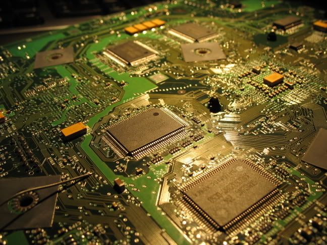

If some of the pads have been pulled away or are broken off you want to make sure the trace isn't connected either end of the pad or it'll never work. Ive had a few boards sent into me where a whole pad has been removed and it connects either end of the pad to form a 'bridge'
I don't know how skilled you are, but make sure your joints aren't bridged on those repairs, one small short or dry joint on certain pins and it won't boot.

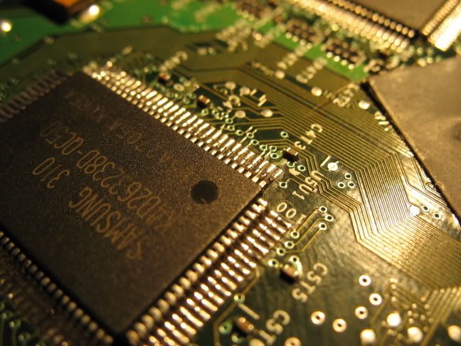

I use a reflow station to remove ram chips off dead motherboards for later use, but all the resoldering is done by hand. Usually it turns out pretty well (like shown in the pics at the bottom of the first page), but sometimes if it looks really messy I'll go back and reflow it with the hot air station.

I'll also use a hot air reworking station if I cannot find a bridge, that with some flux usually does it.
