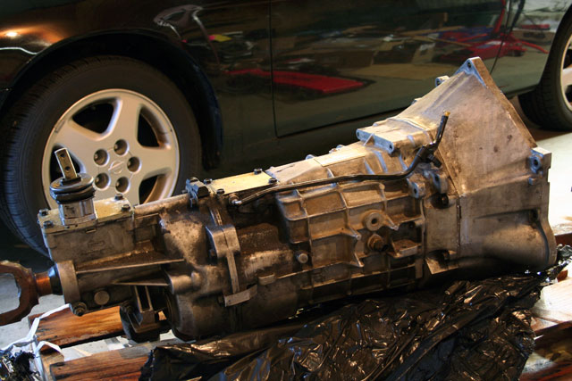

got my transmission in last thursday, Saturday I had big club swap meet and made about $450 selling old parts  biggrin.gif

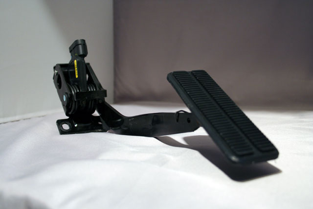

Also got in a corvette gas pedal since the engine is Drive-By-Wire... after weighing the differences I determined that I was better off using the drive by wire throttle than the cable based throttle.
