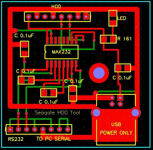

Here is just a rough pic of the developement stage. I will add more when I get it all together and finalize.

Build it, plugged it in and so far everything is going great. Now i'm going to plug it in in a PC here and install Windows on it... Let's cross fingers...
