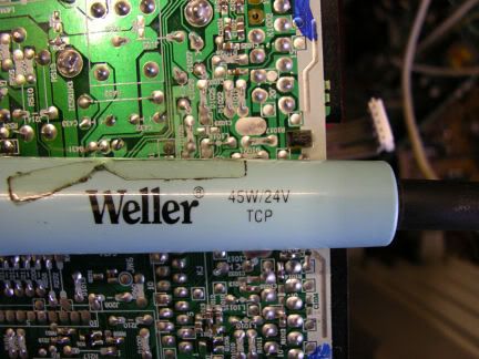

It didn't seem too much of a challenge so here you go. Soldered with a 45watt Weller as pictured. Switched on since 8.00AM. Video Processor chip installed in a Sanyo TV chassis. IF Chip unsoldered with same iron.Time soldered 12.05PM so iron on for 4 hours (Its on all day) Tip size 2.5mm Work not cleaned of any flux or anything afterwards. Left just as is.

Thats some truly inspirational soldering skills chancer
Soldering is not brain surgery or anything and I honestly believe that everyone can master it using the correct gear  and some practice
