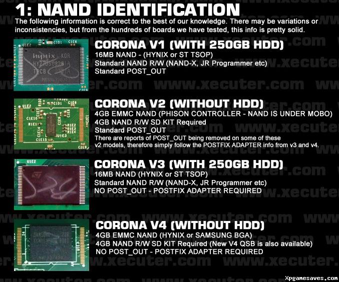

In order to determine and narrow down parts, here is an image
This will narrow down the tools more specifically by knowing board version.
There are several guides and video's that will help you. Just google or youtube "RGH corona v_" ((v_<- board version))

Hi... back again !  Sorry for the delay - work has been crazy this week.  I finally got the time to open the Xbox again and here is a photo of my NAND.
Which version is mine ?  It looks like the Corona V1, but I'm not the expert here ! :-)

Okie good your NAND is a 16byte if it is a v3 here is an image to help you figure out the post out.
this is how the post out fix looks like

Sorry... what am I looking at ?  I can't see any difference in the two pics !  What is a 'post out' and how is it missing in the second image ?

Do I have to remove the CPU heatsink in order to see whether the POST OUT tracks are present?  Does it make much difference to the type of mod whether POST OUT is available?

Yes you will have to. The post_out fix is necessary for the hack to work.
Since your's is a version 3 the post_out is not present. To make sure of that you will have to take the heat sink off the CPU/GPU. You look for the track in the spot where the arrow is pointing at in the image in the last post.
Either way you will have to take off the heat sink to place the post_out fix. Once it is on use point 1 on the post out fix.
Before turning on the console have the heat sink back on. It is very important to put a fresh layer of thermal grease and the heat sink back on before you turn on your console. I don't have explain what happens if you don't
Post_out fix will be just under $10
thermal grease a small syringe will cost under $7
