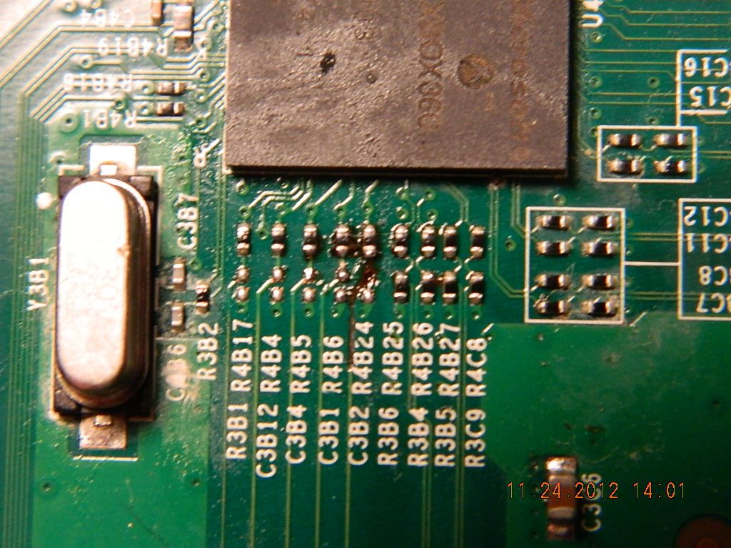

Jasper couldn't even dump the nand. I might have trashed something on the garbage qsb install. That's when it all started. Band wouldn't dump. So I removed the qsb went to wire like I normally do. No luck. Decide to remove nand x to check power on console now it won't even boot. Checked for solder splashes etc. I'm lost. Jasper powered fine before qsb install

Sometimes, durning/after the soldering, the points remain damaged even if they are not completely lifted. I suggest you to check this with a magnifying glass and multimeter. smile.gif

Better inspection of it, looks like a trace is lifted. To hell with QSB installs I'll never do that garbage again. Wired the cr3lite to a falcon with no issues, just wanted to try the QSB. Anyhow I'll get a photo upload later on, to me looks like the trace is lost. Not sure how to go about fixing a trace...

Yeah I have to figure out how to repair a trace first

w00t that did it wink.gif Now to RGH this damn thing again.
