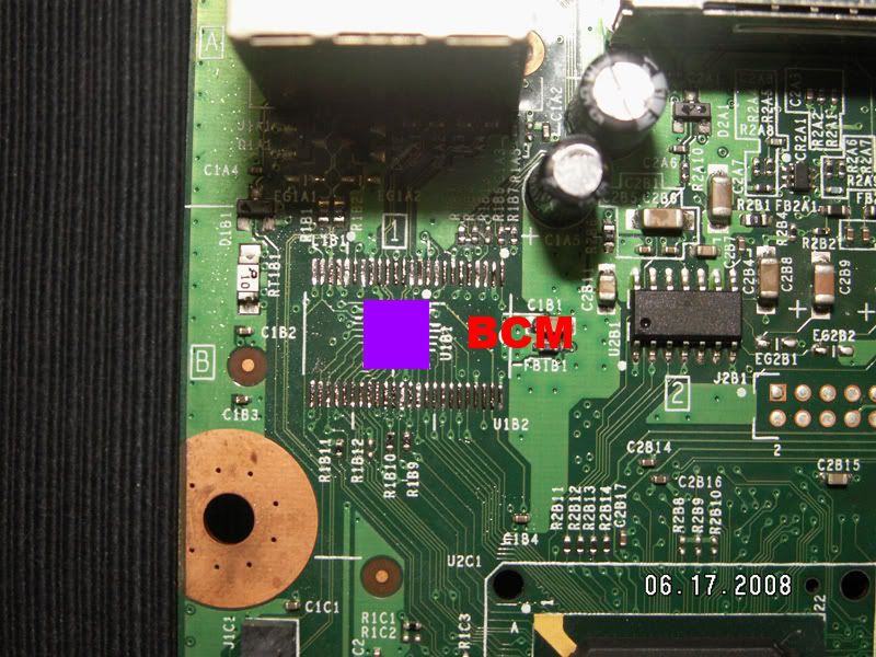

It's right behind the Ethernet jack and has the part number on it, the board designation is U1B1 for the BCM or U1B2 for the ICS.
ICS
BCM
You can make it out thru the side of the 360 if ya don't want to tear it apart just yet.
What it'll cost ya depends on where ya can find it, though the shipping on the thing is gonna most likely be 10 times what the part costs ya. I honestly can't remember where I found the ICS chips now, it's been awhile and I know it took me awhile to find a place that had them, hit me up in a PM if ya end up needing one of those.
