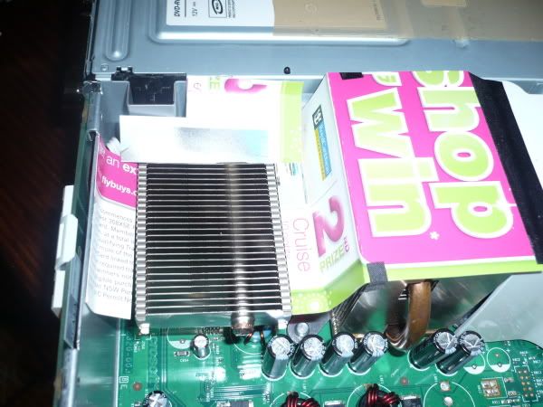

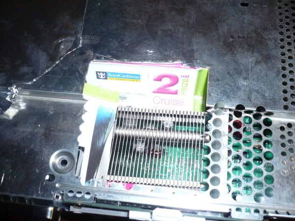

duct work - yes. take a look at what i have done below.

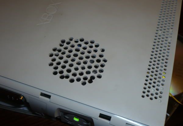

intake fan - yes. definitely reduces temps. if you are prepared to cut a hole in your case. or buy/use a spare case.
this is what i have done with my current xbox.
the ducting forces all the cool air from the extra fan through the extra gpu heatsink
I have tested it with and without the ducting and 6cm fan, it has reduced the gpu temperature by 10 degrees without any other mods. the extra fan is running on 5V
also it is quiet. not much noisier than stock.
yeah i know the holes in the case are fugly. when i buy a nice looking fan i will cut the hole out.
