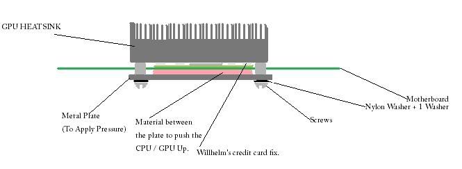

I pretty much proposed the exact same thing, but not with X-Clamps. - Six months ago, seemed nobody replied / cared haha (How do you find all threads posted by you?) - It seems turned off on XBOX Scene.
Alright, this was my proposal, with added Wilhelm's improved X-Clamp Fix:
(IMG:http://i100.photobucket.com/albums/m5/senja81/Finished_Product.jpg)

I assumed you were fairly up on things since you were happy to experiment and all. I was writing for all the newbies who come to the forums to figure out what's what.
Zoneout's method looks excellent tho. Presume you'd have to cut a big ol' hole in the case to accomodate the metal plate and screws tho??? Have you tried it for 6 months Zoneout???
Here's an idea: Zoneout's fix with a hole cut through the metal case and then another one through the plastic. Put a 2" fan there and you'll be pulling all the heat out from the underside of the GPU. Brilliant, huh?

Yep. the X-Clamp fixes working 6+ months are the reason why I haven't implemented this method yet.
- Your idea seems alright, provided you can find a fan that can nicely fit.
- Yes you would need to cut a hole in the metal casing to accommodate this method, but not necessary for the outer plastic case anyway.
I honestly believe this method is it. And thanks to jimbob for the idea, and reminding me about this.
- So I would need a kind of a metal with the right thickness and cut a block out of it for the GPU and make the drill holes for mounting.
And in between something that conducts well thermally and is solid enough to put pressure onto the chip.
- Zoneout
