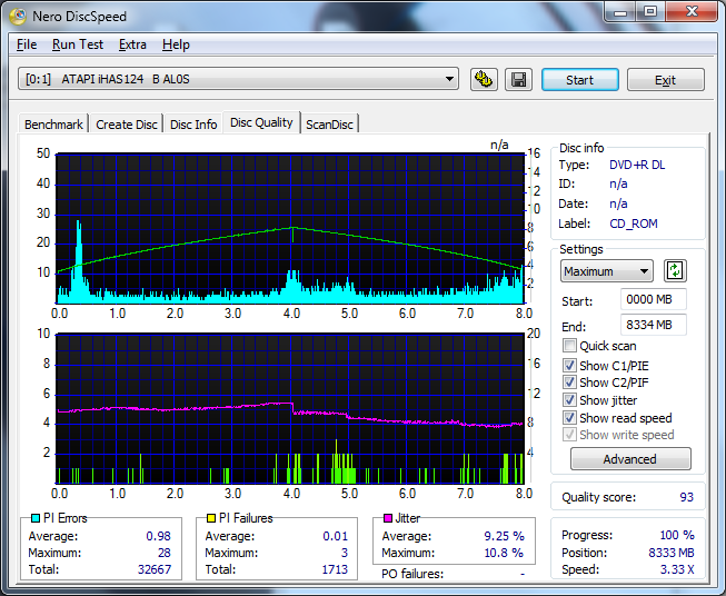

I think im in love with these 8x verbatims, the 2.4x ones dont read in the xbox as good, and they also have alot of errors around the layerbreak.
(IMG:http://i221.photobucket.com/albums/dd35/Enraged_Bacon/Untitled.png)
