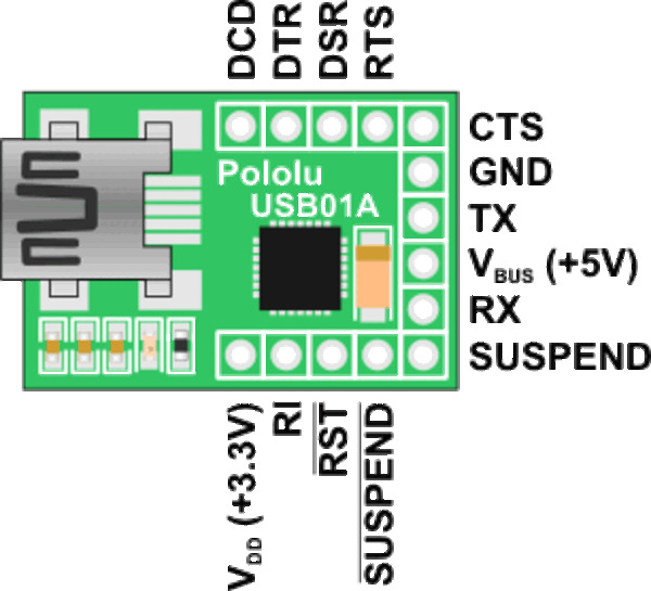

1. I soldered my Pololu USB to serial adapter (which I bought here) to the DVD drive like so.
(IMG:http://img522.imageshack.us/img522/4810/editedthing.jpg)
(Layout for the adapter)

did it say bad or missing?  if you unsolder the yellow and white wires from the board, it will report as half open, try that.  if you are comfortable w/ soldering, you might as well mra hack the drive.  all you need is a 22 ohm resistor and a scrap of wire.  there are a million thread a day asking why non standard serial extractors don't work so i have little faith in them.

I'm going to try the MRA hack, thanks for the really quick reply! +Rep (if you have this on this board... idk... lol)  (IMG:style_emoticons/default/biggrin.gif)

Sorry about the double post, I couldn't edit my post though... so, would I want to remove that circled part I soldered together to do the MRA hack?

yes
