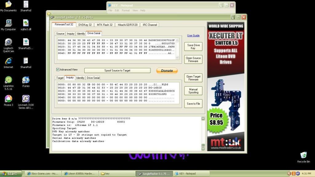

Well my lite-on 83850c was dying so i purchased a new replacement drive. I hooked the dying liteon up to the computer and opened jungle flasher, for some reason the DVD key is missing in the drive properties and I dont have it backed up anywhere. The drive was previously flashed with ixtreme lt 1.1. I however was not the person who modded this system. Basically im just hoping you guys can elaborate a little and tell me there is a way to recover it and that im not F'd.  I can provide more detailed info if needed. Also, I snapped a few screenshots in JF, links are below. Hopefully they help some. Thanks.

OK it did not work This is the JF log i tryed twice with both methods " LO83nfo first and then Dummy from ixtreme"
"LOG INFO"
JungleFlasher 0.1.75 Beta (152)
Session Started Tue Nov 16 22:33:45 2010
This is a 32 bit process running on 2 x 32 bit CPUs
portio32.sys Driver Installed
portio32.sys Driver Started, thanks Schtrom !
Found 4 I/O Ports.
Found 0 Com Ports.
Found 7 windows drives C: D: F: G: H: I: J:
Found 1 CD/DVD drives D:
Drive is Lite-On.. Sending iXtreme DVDkey request to port 0xEF00
iXtreme DVDkey extraction failed!
Drive is Lite-On.. 0000: 05 80 00 32 5B 00 00 00 - 50 4C 44 53 20 20 20 20 ...2[...PLDS
0010: 44 47 2D 31 36 44 32 53 - 20 20 20 20 20 20 20 20 DG-16D2S
0020: 38 35 30 35 30 43 2D 32 - 00 00 00 00 00 00 00 00 85050C-2........
0030: 00 00 00 00 00 00 00 00 - 00 00 00 00 00 00 00 00 ................
0040: 00 00 00 00 00 00 00 00 - 00 00 00 00 00 00 00 00 ................
0050: 00 00 00 00 00 00 00 00 - 00 00 00 00 00 00 00 00 ................
Sending LO83info request to I/O port 0xEF00
0000: 00 00 00 00 00 00 00 00 - 00 00 00 00 00 00 00 00 ................
0010: 00 00 00 00 00 00 00 00 - 00 00 00 00 00 00 00 00 ................
0020: 00 00 00 00 00 00 00 00 - 00 00 00 00 00 00 00 00 ................
0060: 00 00 00 00 00 00 00 00 - 00 00 00 00 00 00 00 00 ................
LO83info extraction Failed!
