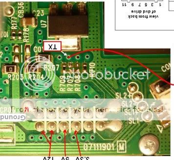

So I pulled out the drive, took the cover off and I found this burnt/black trace:
(IMG:http://i495.photobucket.com/albums/rr313/torcherdsoulz/360%20Stuff/1c49aa74-1.jpg)
I have not tried the drive hooked to a PC yet to see if it will show up, I'll update when I try that out.

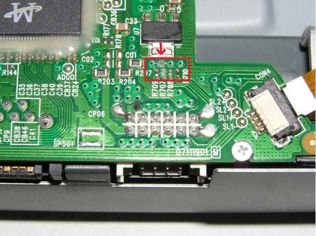

look right above where you circled there is a missing resistor...loks like it was scratched off. check the top of the board and see if there is anything burnt out...im guessing the point he burnt out could just be bridged and replace the resistor...and every thing would work fine. Your xbox is freezing because of hardware failure, same thing as if you were to pull out a harddrive while your pc was running  (IMG:style_emoticons/default/wink.gif)

The part where it looks like the resistor is missing, does have a resistor from the factory I think. I checked couple pics I found on the net and the spot is blank, with no resistor :
(IMG:http://3.bp.blogspot.com/_CDEQaSP7e5c/SnT-1lr6-AI/AAAAAAAAAIE/T7YO8HuKFiA/s320/xbox360-probe-hole.jpg)
(IMG:http://i495.photobucket.com/albums/rr313/torcherdsoulz/360%20Stuff/5fb4dee0-1.jpg)
I'm going to pull the board off the drive and see if its burnt under it at all....will post back in a few !

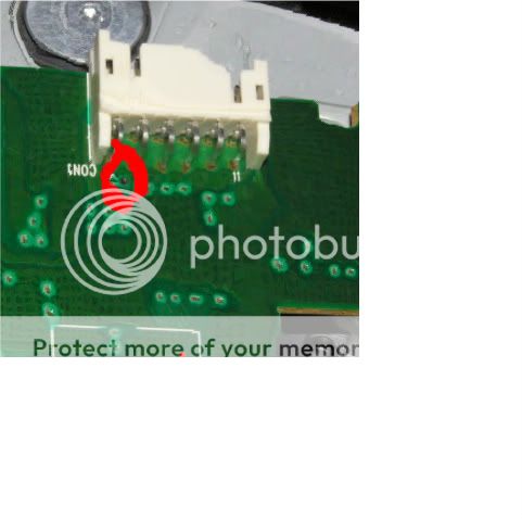

Looked all around the bottom of the trace on the bottom side of the board and the only thing I could find is the same burnt spot as on the top, around the same hole/trace.
Heres a pic:
(IMG:http://i495.photobucket.com/albums/rr313/torcherdsoulz/fa00a036-1.jpg)
Where do I go from here with this ?
I tried it in hooked up to my PC and I couldn't get the PC to even see the drive.
How would I fox the burnt/black spot ? How do I know where to go from here ?

there are no resistors that go where those "missing resisitors" are.
as for the burn, just get some flux and some lead. tin a wire properly, find where that trace goes to. join it together with the wire. secure the wire make sure it's not touching anything else. put it back together and try out. I just reworked a lite-on that was pretty burned, needed 4 traces repaired. Now works flawlessly.
gently scrape the top coat of the board over the trace until the copper shows, apply a little flux, run lead over it to tin it, then it will attach to the wire properly. try to keep wires flat to the board.
i was taking a look at that close too, seems to me that trace is connected to ground... so.. find a ground point and tie it up (IMG:style_emoticons/default/wink.gif)
ALSO, it looks like its the result of inverting the power connector which it seems alot of ppl do.. normally this can't  be recovered...

You have no idea what you are saying. Burned dot is GND so no need to fix it.
MDKMDK,
Measure resistance 3,3V to GND like this.
Is the MT chip getting hot?
Measure voltage DC r707 hole to gnd and r708 hole to gnd.
