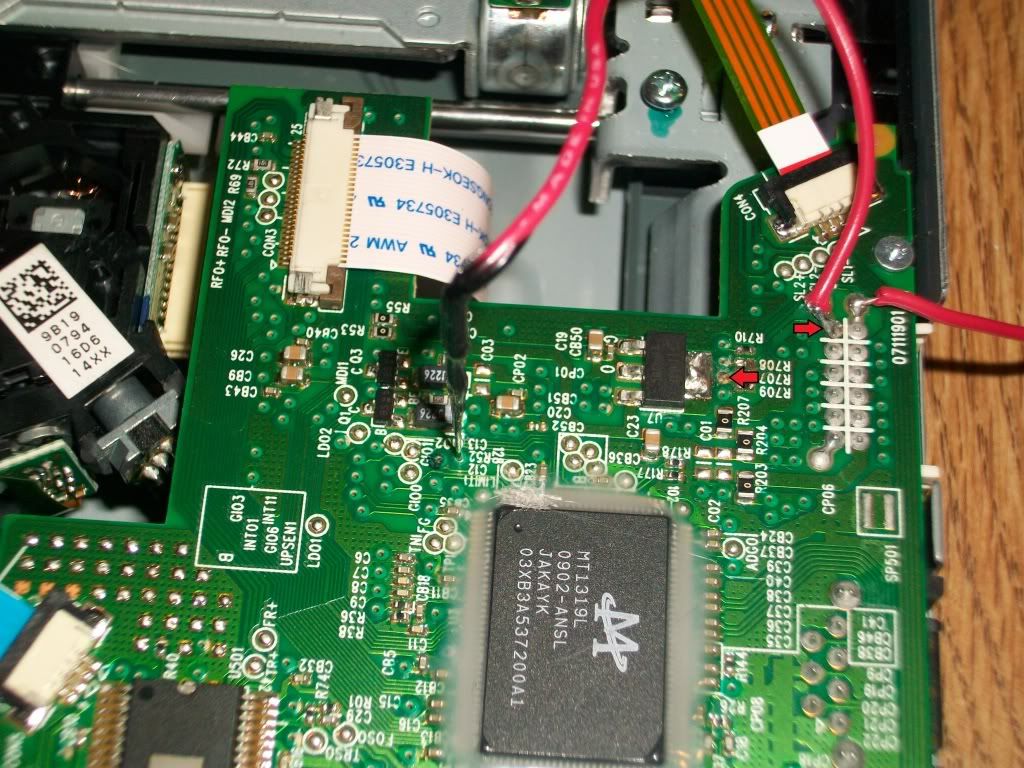

QUOTE(LiquidXed @ Dec 18 2009, 04:20 PM) View Post
In the last pic, it looks like you lifted the 2 pads for 707.  So how did you bridge them?  Did you verify with your multimeter?

Yes i tested with a multimeter the 2 points that i marked, just like you test for short, and fuses. also i used a needle for the probe.
where you normally put the probe or usb xtractor, is still good. Thay is copper u see, i just cleaned it up to get a better connection. i just removed the R707 points when i desoldered it with desolder braid
R52 is an alt point for the R707 and the R708 alt is right beside it

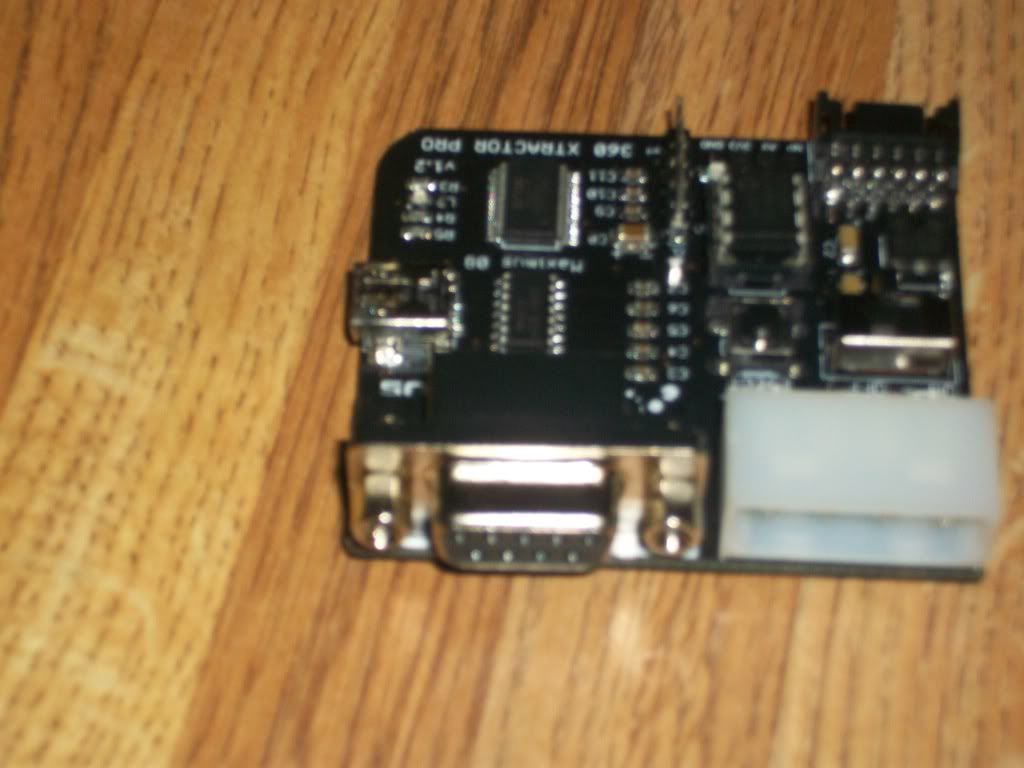

I use the 9-pin serial D-Sub, no driver needed, but it works the same.
i just ordered THIS , u think it will work if i pluged the RS232 SERIAL DB9 9 PIN into the xtractor and the usb into the pc?

« Reply #21 on: December 18, 2009, 08:10:00 PM »
there is a giant warning that comes with the extractor pro staing plugging into usb and serial at the same time will damage unit.

« Reply #23 on: December 20, 2009, 11:29:00 AM »
QUOTE(iateshaggy @ Dec 18 2009, 10:10 PM) View Post
yeh, im not usen both at the same time, tryin to find a method that works. thanks for the info.
QUOTE(antonio010 @ Dec 19 2009, 06:14 AM) View Post
Because you lifted the pads you will need to rebuild.  Follow this tutorial and it should work.
yeh i just lifted the R707 and R708, dont need to rebuilt if u look at my last pic all i have to do is put the pin in where the spear or probe gets the key, them points r fine, ive just found an alt point to use, i should have taken a pic before i lifted the pads, cause i had the points bridged fine, tested with meter, but xtractor pro still wouldnt read my key.
