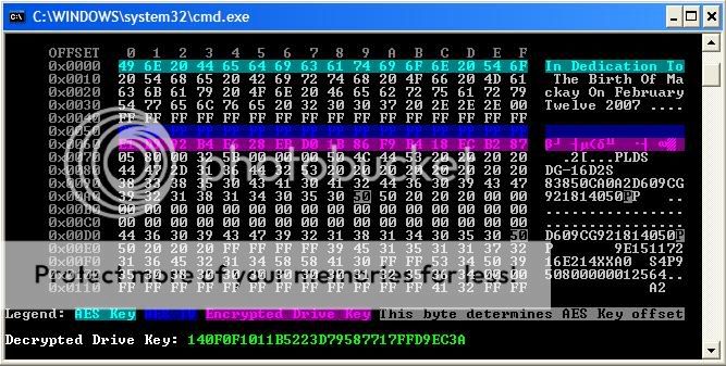

OggyUK
  • Posts: 939
83850c Wont Give A Good Dump
« Reply #8 on: November 28, 2009, 03:18:00 PM »
While bored of thinking of ways to make money from the "scene" I decided to hex your logs into a spare [BARCODE].bin I had from when I sent the files to VGC for Geremia's freekey.....
Using Seacrests OpenKey, with your Encrypted key, AES Key, AES Offset, IV etc
(IMG:http://i330.photobucket.com/albums/l432/OggyBST/XB2S.jpg)
It gave that key.
I dont know much about the decryption routine, but its certainly weird as 140F0F1011B5223D79587717FFD9EC3A key is (in every other case) obtained by decrypting:
Cipher Text of 00000000000000000000000000000000  with an AES key of 00000000000000000000000000000000
As you're aware, this isnt the case for you.
Id try another PC personally, but its REALLY weird you ge that key WITH what seems good ciphertext.
And Jelle, JF will allow that key as source but wont let you spoof it to iX
deakphreak
